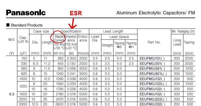

    Hello, I have a few questions regarding some of the specifications found on capacitor datasheets.
    1.) Which specification of capacitors is more important, endurance or rated ripple? Nichicon HE capacitors have a higher endurance rating than HZ, so wouldn't they be better?
    2.) Not all data sheets list esr, so how can I tell what capacitor would be better than another one?
    3.) Nichicon HZ capacitors have a higher ripple rating than Rubycon MCZ capacitors, so would the nichicon HZ be better than the Rubycon in this case?
    4.) Also, what range would be considered a good esr reading, and what range would be considered bad?

                      The ratings to look at beyond uF and volts are ESR and Ripple.
                      [Remember going up in volts isn't a problem.]
                      ESR is isn't really Impedance (Z) - but:
                      At the 100kHz they use for data sheets Xc and ESL are at values such that *effectively* ESR = Impedance.
                      The actual equation is:
                      Z² = ESR² + (XL - XC)²
                      [Note: (XL - XC) must be corrected to a positive value if it isn't.]
                      ESR is effectively a measure of the cap's 'resistance' to AC Ripple.
                      Since the cap's job is to short Ripple out to ground: lower is better.
                      The 'Ripple' rating tells you how much Ripple current the cap can pass without overheating internally.
                      It is the capacitor equivalent of a watt rating on a resistor.
                      It tells you how 'heavy duty' the cap is and thus: more[higher] is better.
                      elite PF ------ 1000uf @ 16V ( 10 x 20 mm) - General Purpose cap - Ripple = 680
                      Rubycon PX @16v is not rated good enough.[Ripple = 640]
                      I would use something like LXZ, LXY, VZ, FC, PW
                      Capxon KF --- 1000uf @ 10V ( 10 x 16 mm) 1040 / 0.076
                      Panasonic FC is just good enough for this one. [KF specs are not linear, so to speak.]
                      Use FC or better.
                      capxon KF --- 470uf @ 10V ( 8 x 11.5 mm) 580 / 0.250
                      capxon KF --- 470uf @ 25V ( 10 x 16 mm) 1200 / 0.076
                      These are rated better than FC.
                      Chemicon KY or Nichicon HE are good enough.
                      Chemicon KZE and Rubycon ZL are the next better grade.
                      Sacon FZ ---- 330uf @ 16V ( 8 x 12 mm) - 1150 / 0.036
                      Pannasonic FM is not good enough. [950 / 0.056]
                      Use Rubycon MBZ or MCZ - Panasonic FJ or FL - Sanyo WG.
                      skywell SHT - 1000uf @ 6.3V ( 10 x 12 mm (not sure about height since I could'nt find data sheet for SHT) )
                      I would treat this the same as the FZ to be safe since I can't find a spec sheet either.

                              Re: capacitor ripple vs endurance & other questions
                              Originally posted by mockingbird
                              Thank you. This was very helpful. I've been struggling to understand why people recommend which series for what.
                              One question though. When are you recommending KZE and MBZ/MCZ?
                              This is the way I understand it. KZE and MBZ/MCZ are Low ESR and high ripple caps. So you use them in places where low ESR is required like a motherboard's VRM. Would you put KZE let's say on a power supply?
                              KZE is in fact intended for PSU according to Chemicon.
                              Looking at 8x20mm
                              MCZ: .................... 2350 / .012
                              FL & FJ: ................. 1870 / .016
                              MBZ & WG: ........... 1870 / .019
                              FM: ....................... 1560 / .030
                              KZE, ZL, WX, HD: . 1250 / .041
                              KY, HE: ................. 1050 / .069
                              FC, PW: .................. 995 / .065
                              LXZ: ....................... 810 / .080
                              The 10x20mm follow the same pattern.
                              In Vcore and RAM:
                              KZE was the typical grade on PC133 motherboards.
                              By DDR RAM MBZ was more typical.
                              - It varies with how many cap are used because caps in parallel lowers total circuit ESR.
                              KZE grade is still common for the 8 & 10 mm caps used out near the add-in slots when the board has 6 or more caps out there.
                              Low cap-count boards will use higher grades.
