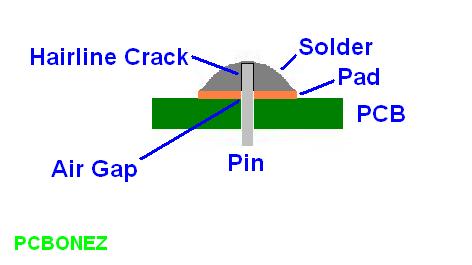

    A visual inspection might not be enough to spot bad joints on the transformers.
    The solder can be where it's supposed to be but there is no bond to the lead because the lead didn't get up to temperature in the automatic soldering process.
    - As in the lead is encased in the solder but not bonded to it.
    In real bad cases the solder basically forms a tube around the lead and the lead will actually be able to move around. See pic.
    Just heating the joint until the solder is nice and shinny usually fixes it.
    Sometimes a dab of fresh solder helps.

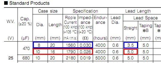

                      #30
                      Re: need Help finding replacment Caps
                      Can't look up specs for replacements if I dunno what the old ones are.
                      At a minimum need:
                      - Manufacturer
                      - Series
                      - uF
                      - Volts
                      - Diameter
                      - Length [sometimes]
                      You appear to giving the length and calling it the diameter.
                      A 15mm diameter 1uF lytic 50v would be shaped like and about the size of a penny or a bottle cap.
                      Any given uF/volts combination from a given manufacturer/series might have two or three different diameters available and also might have more than one length for each diameter.
                      The ESR/Ripple specs change with dimensions, not uF and volts.
                      Also different diameters usually have different Lead Spacings.
                      [see pic]
                      The dimensions are important.
                      And the various series'? - Even more important.
                      Can't compare specs without that either.
                      There are probably 20-30 different series' of OST 1500uF 35v and they all have different specs.
                      [I can see some series designations in the photos but not all.]

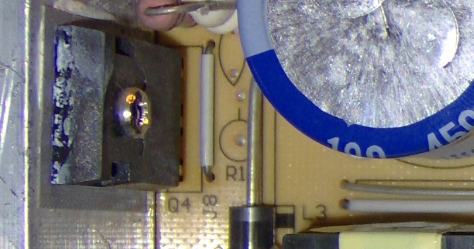

                      Q4 looks like it's cracked right through the middle.
                      Can you read the numbers on it?

                        Q4 -- Looks cracked just under the screw.
