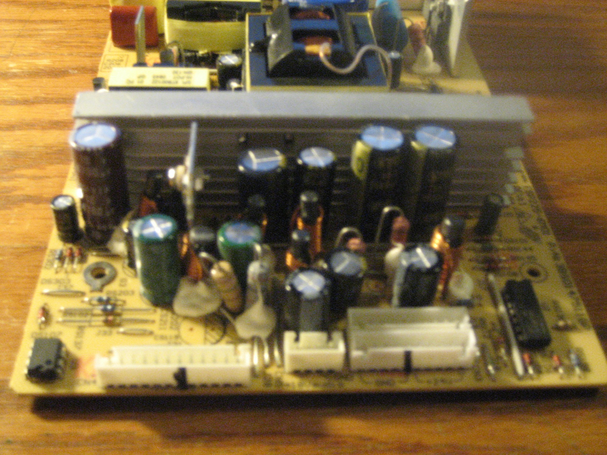

    My Sceptre X32GV-Komodo is not powering on properly
    took out the power supply and it look like 3 cap are bulging
    there Capxon
    small one 14mm 470uf 10v
    kf temp 105c
    c642
    bigger one 18 mm 220uf 35v
    KF temp 105c
    biggest 20 mm 820uf 25v
    SY 105c
    11/06

      If 3 are bulging, replace ALL the caps on the board.
      If you live in the USA, you can get the above from digikey.com. All below are Panasonic FM or FC (FC to meet the 20mm 820uF 25V cap).
      470uF 10V
      http://search.digikey.com/scripts/Dk...name=P12361-ND
      220uF 35V
      http://search.digikey.com/scripts/Dk...name=P12411-ND
      820uf 25v
      http://search.digikey.com/scripts/Dk...name=P11222-ND

                Is it possible that maybe you can post some pictures of the boards in question? When posting pics, use the "Manage Attatchments" on the posting screen.

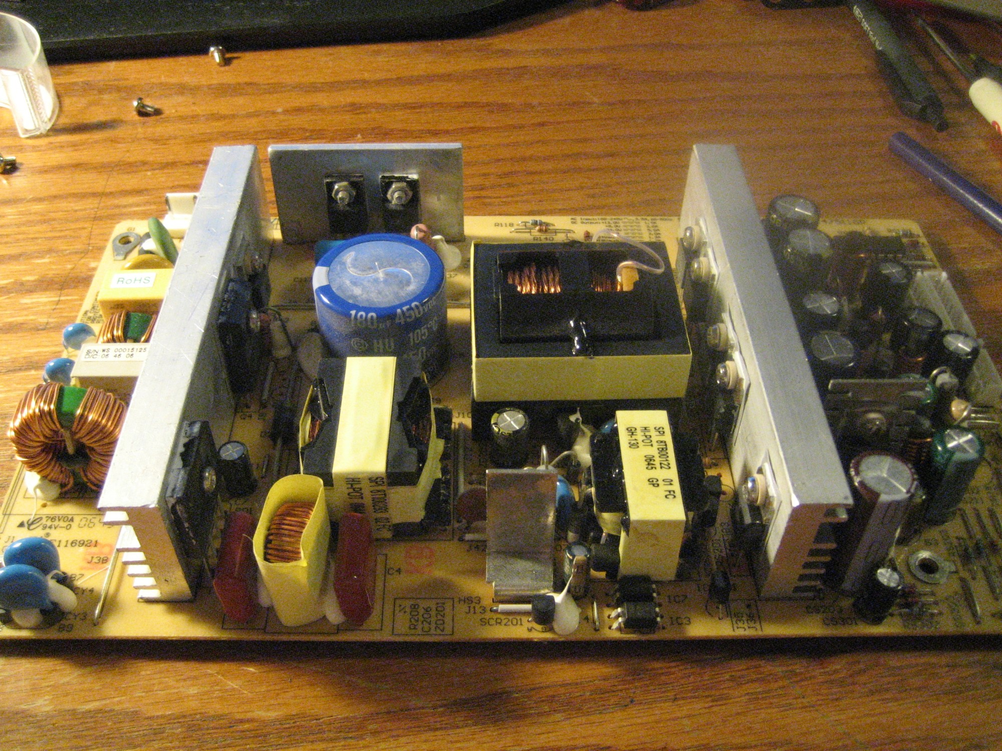

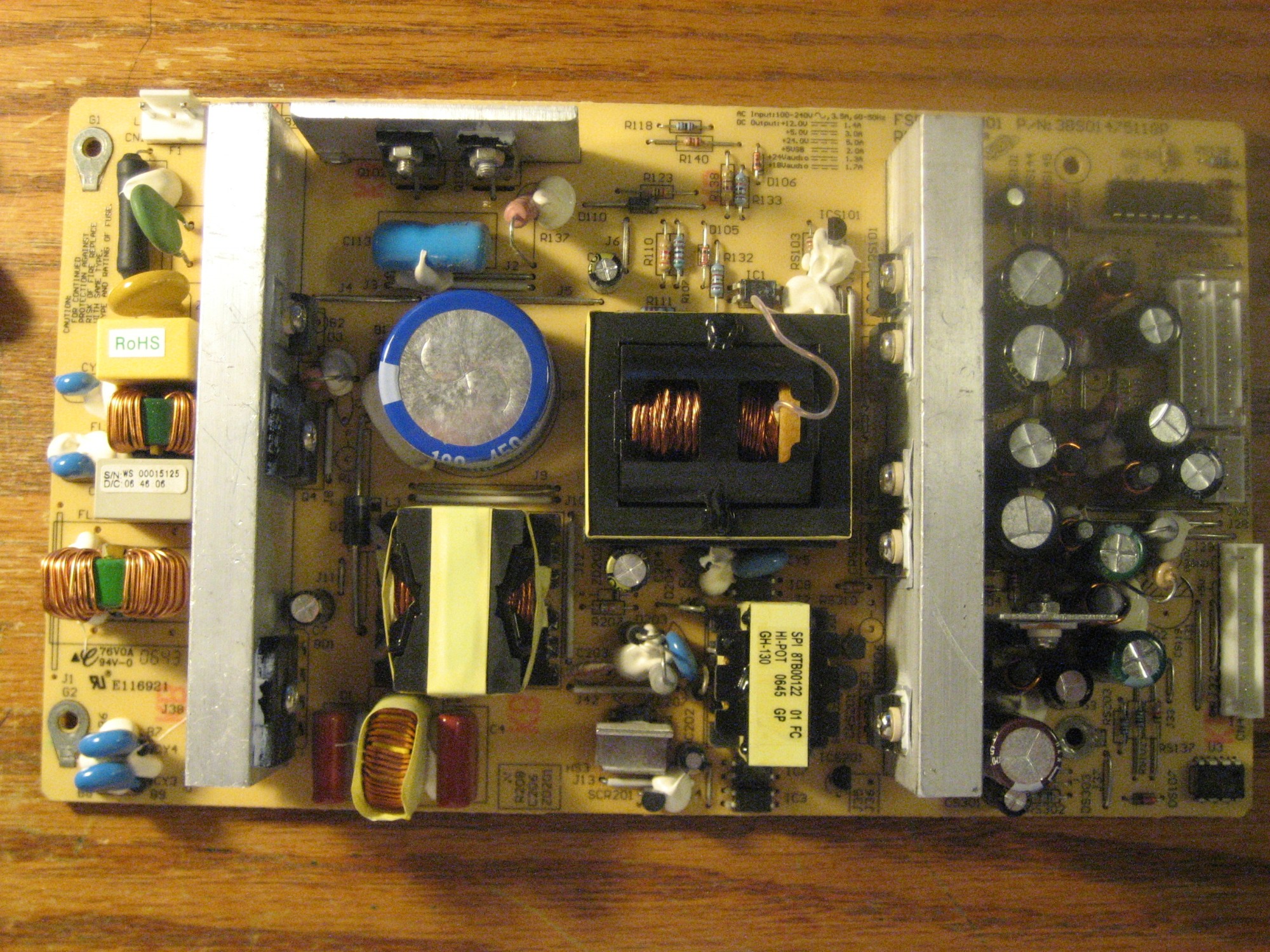

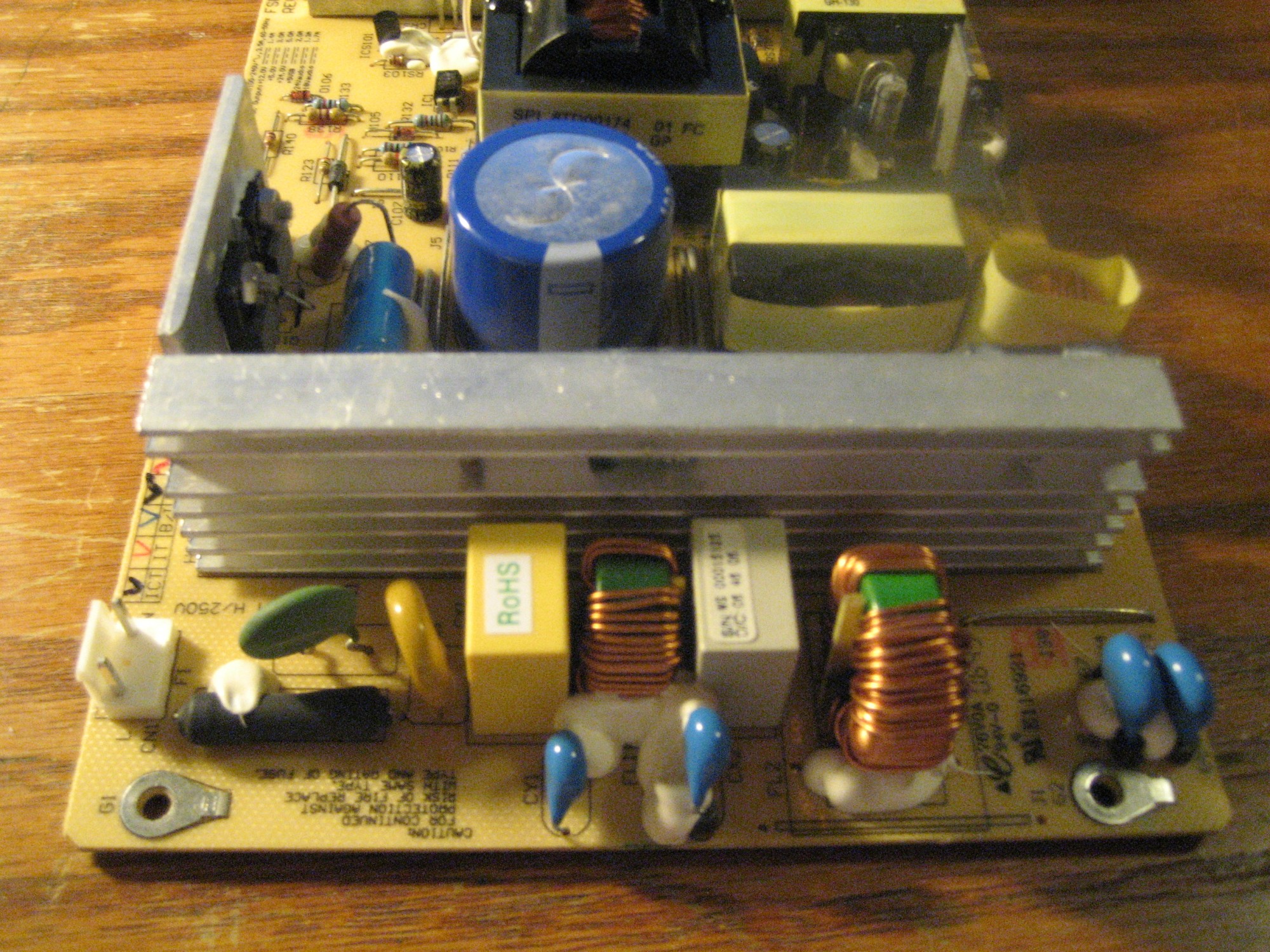

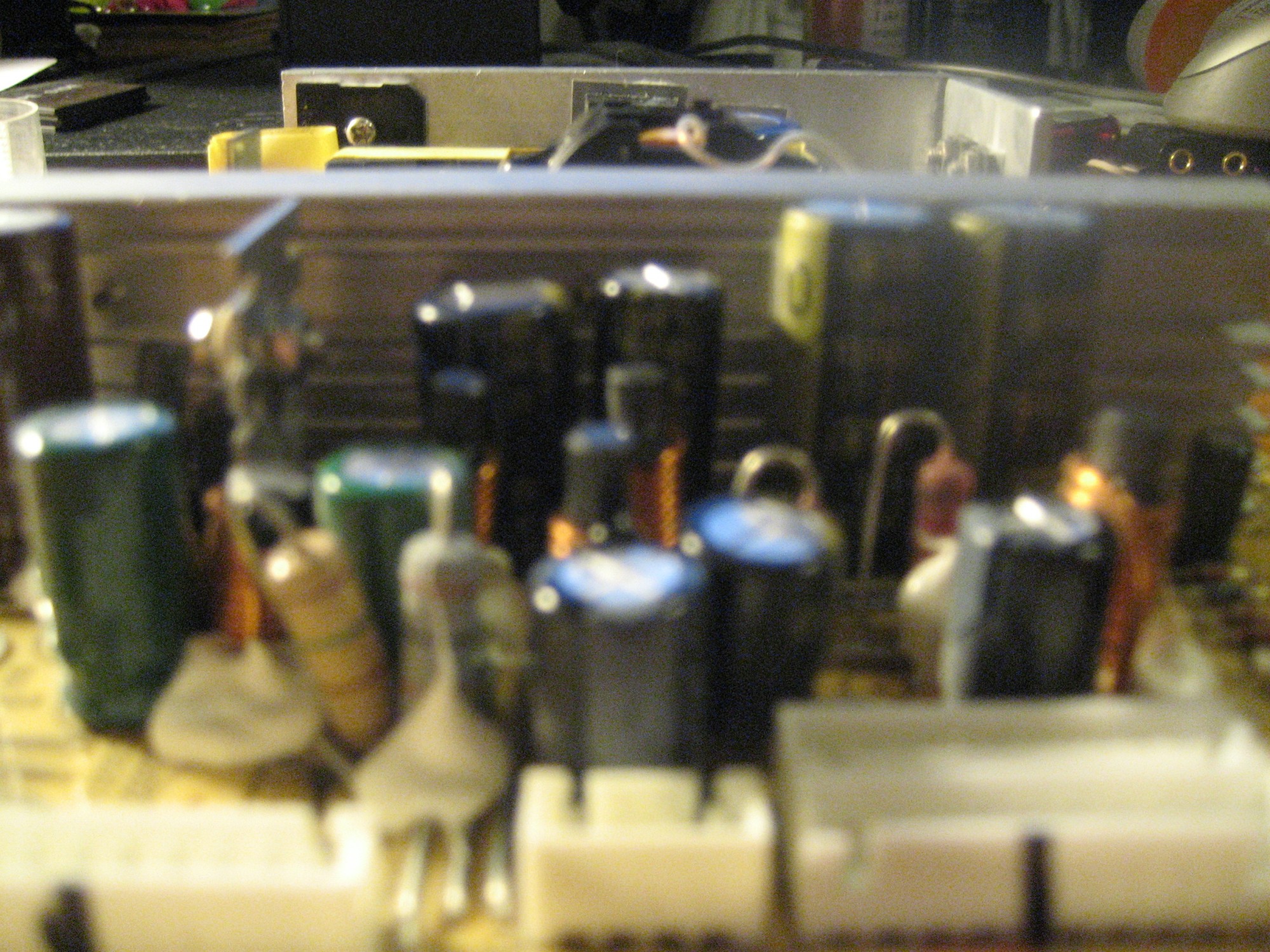

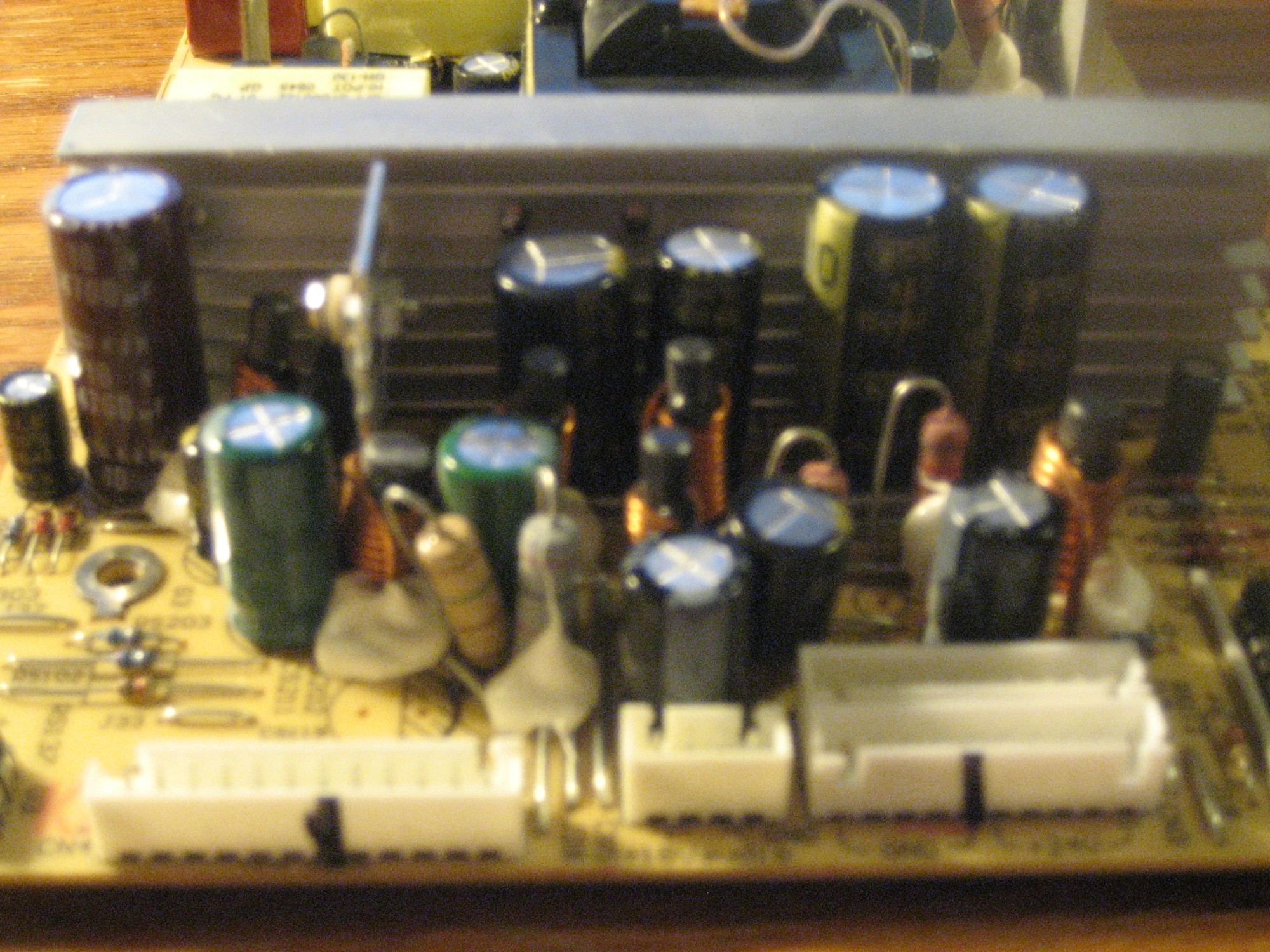

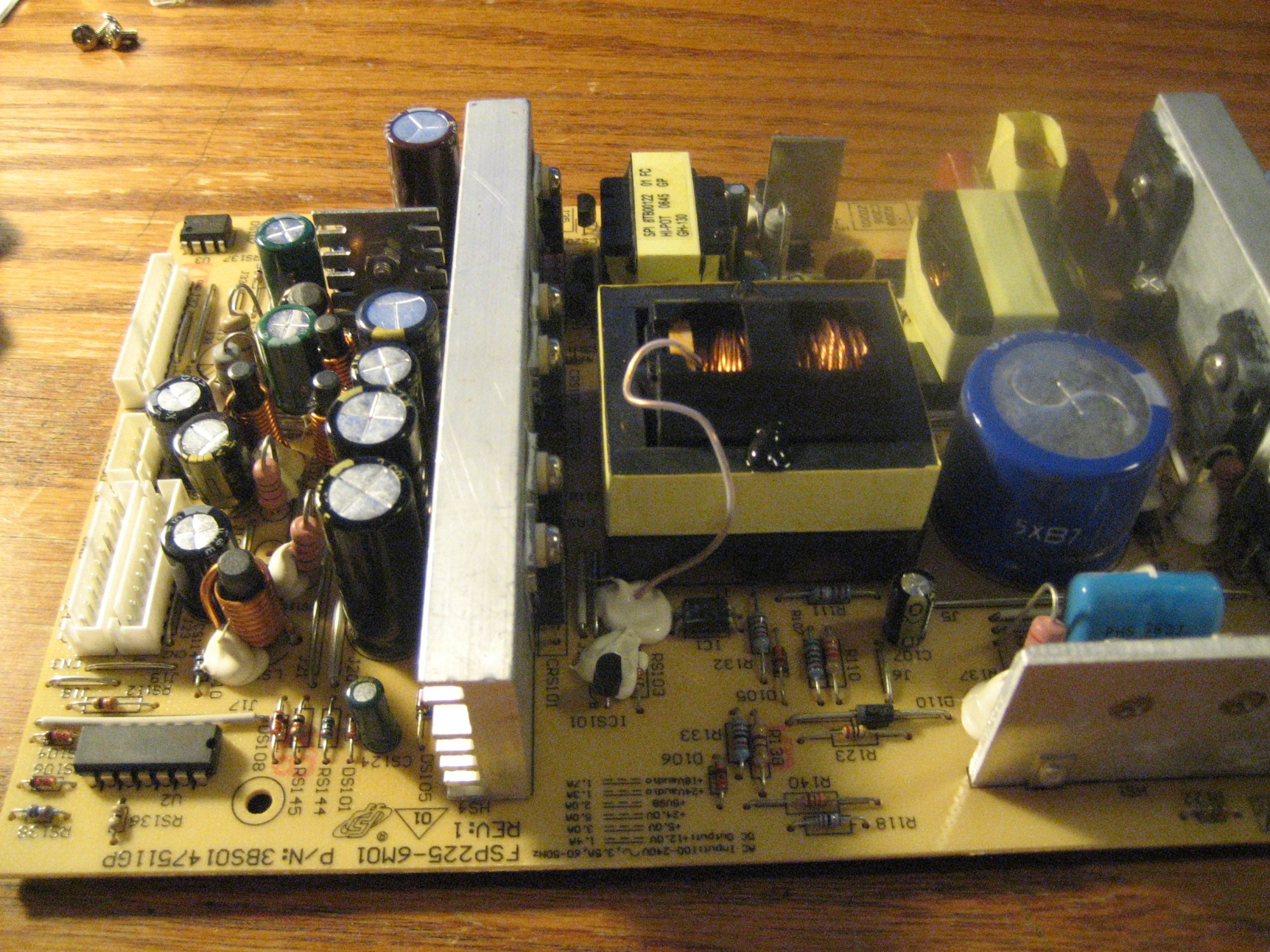

                  pics of the power supply
                    Let's get a detailed description of what is happening. Properly can mean a lot of things.
                    For example,
                    1) Power on, get green LED.
                    2) no picture, no sound.
                    OR
                    1) Power on, LED does not light
                    Etc
                    edit: Caps do not have to be bloated in order to be bad. You may have more bad caps on this board. Caps can be out of uF tolerance or have high ESR. For example, a 1000uF cap can measure 200uF. A cap can measure 8 ohm ESR which is very high. Neither of these 2 require a cap to be bloated.
                    Also, do you have multimeter?

                      the Tv will power on but screen with flicker and turn off after a few secs.

                          Get rid of the OST RLS. [Actually all the OST's] - They will fail without bloating.
                          Also check the solder connections to the transformers for cracks or a dull appearance. - Because they are bigger than the other solder joints, when they machine solder sometimes those don't always get hot enough and you end up with a cold-solder joint.

                            the picture works but will only stay one for about 30 sec or less, the power light flickers in and out, and yes i have a multimeter.

                              I second PCBONEZ recommendations regarding the soldering and caps. If it works for 30 seconds, then something is obviously intermittent.

                                I checked the soldering and nothing looks to bad.
                                how would I test the caps with my multimeter
                                and a few I would like to test maybe replace
                                the OSt are 1500uf 35v
                                and 820uf 35v
                                Capxon 330uf 35v
                                2200uf 10v
                                4700uf 10v kzh
                                the Tv used to stay on as long as you didnt turn it off, If the Tv didn't turn off after about one minute, you just had to unplug it and try again. cooling the broad seemed to have no effect.

                                  It would not hurt to touch or resolder the joints.
                                  If your multimeter has a capacitance check, you have to unsolder the caps and test them out of circuit. A multimeter though cannot test the ESR of the cap. For that you need an ESR tester.
                                  edit: Caps do not have to be bloated to be bad. Capxon is a brand hated by members here.
                                  One thing you can try.
                                  1) Have cover off so you can test the boards while the TV is running.
                                  2) Power on the TV and check the secondary voltages (usually 5V DC, 12 V DC, and/or 19V DC).
                                  3) When the TV shuts off, see if the secondary voltages are still present and stable.
                                  This will help narrow down the problem.

                                      It would help if you posted clear focused pictures of all your boards. Take your boards to a window on a sunny day and put your camera on macro mode. A top down picture of both sides on the board is all we need.
                                      On your power board, I see 4 white connectors. It looks like the voltages are all marked.
                                      The connector that leads to the logic board (a board where your inputs plug into - hdmi, vga, svideo, etc) is the one we want to measure.
                                      Put all the boards back together.
                                      With your multimeter, put your black probe in common and your red probe on volts. Set your multimeter to the DC Volts. If it is a manual meter, set it to 20V DC.
                                      1) Power on TV.
                                      2) Put your black probe on a grounded screw on the logic board. This is your ground point.
                                      3) Put your red probe on the logic card white connector. You are going to measure all the pins for voltages. What you are looking for is 5V, 12, and/or 19V DC. Some pins will be 0.0 for Ground. Write down all voltages
                                      4) When the TV goes off, re-check all the pins on the logic card. Write down all voltages.
                                      If the voltages are stable on and off, we can assume that the power board is likely okay.
