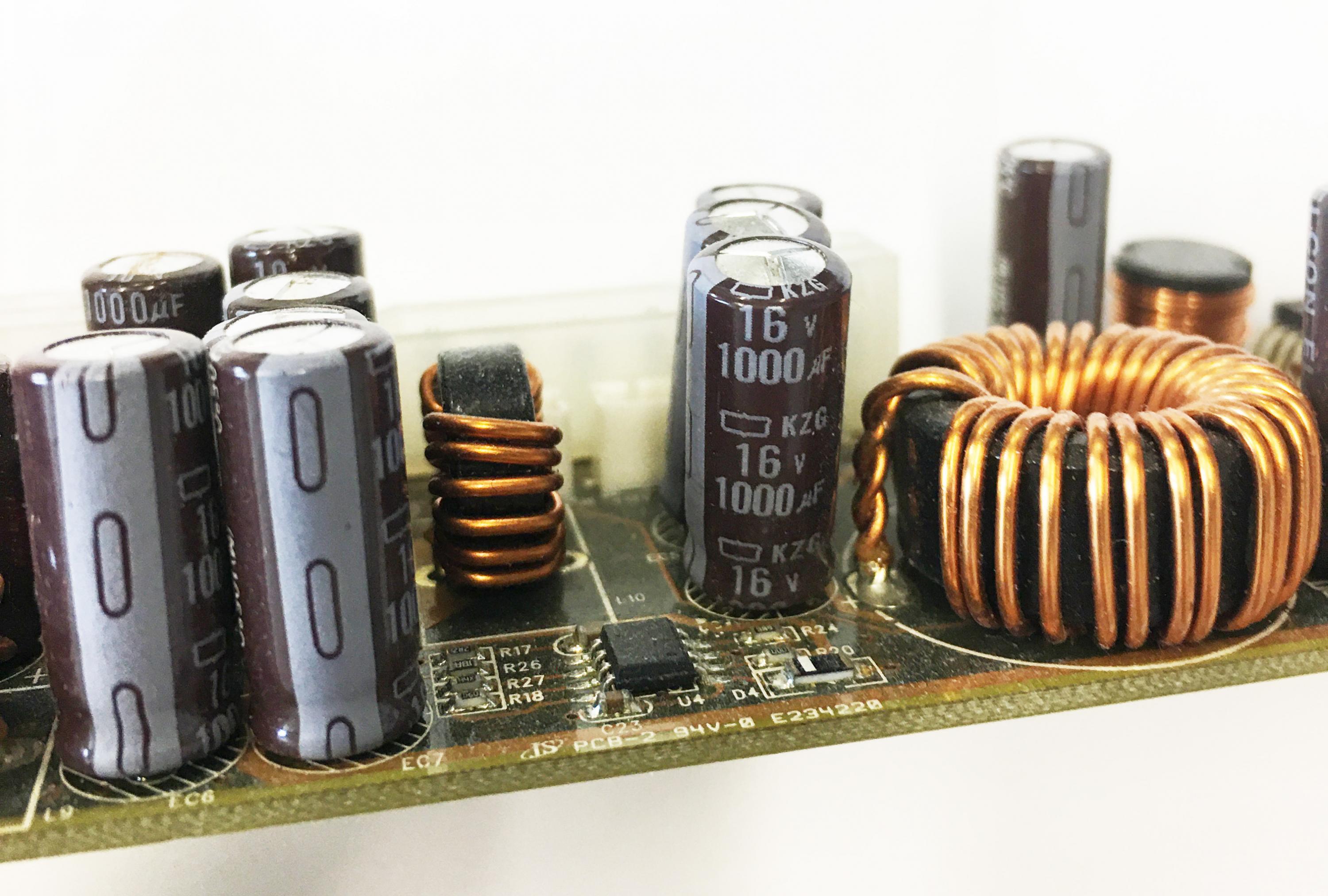

    I have a Winmate DD24-AX DC-DC power supply with a few bulging KZG caps I'd like to replace. I am having trouble sourcing these caps.
    KZG 1000uF 10V
    KZG 1000uF 16V
    Can anyone suggest some suitable replacements which are not too costly?
    Photos attached,
    Thanks in advance,

    Re: KZG Capacitor Replacement Advice
    panasonic FR is a close match
