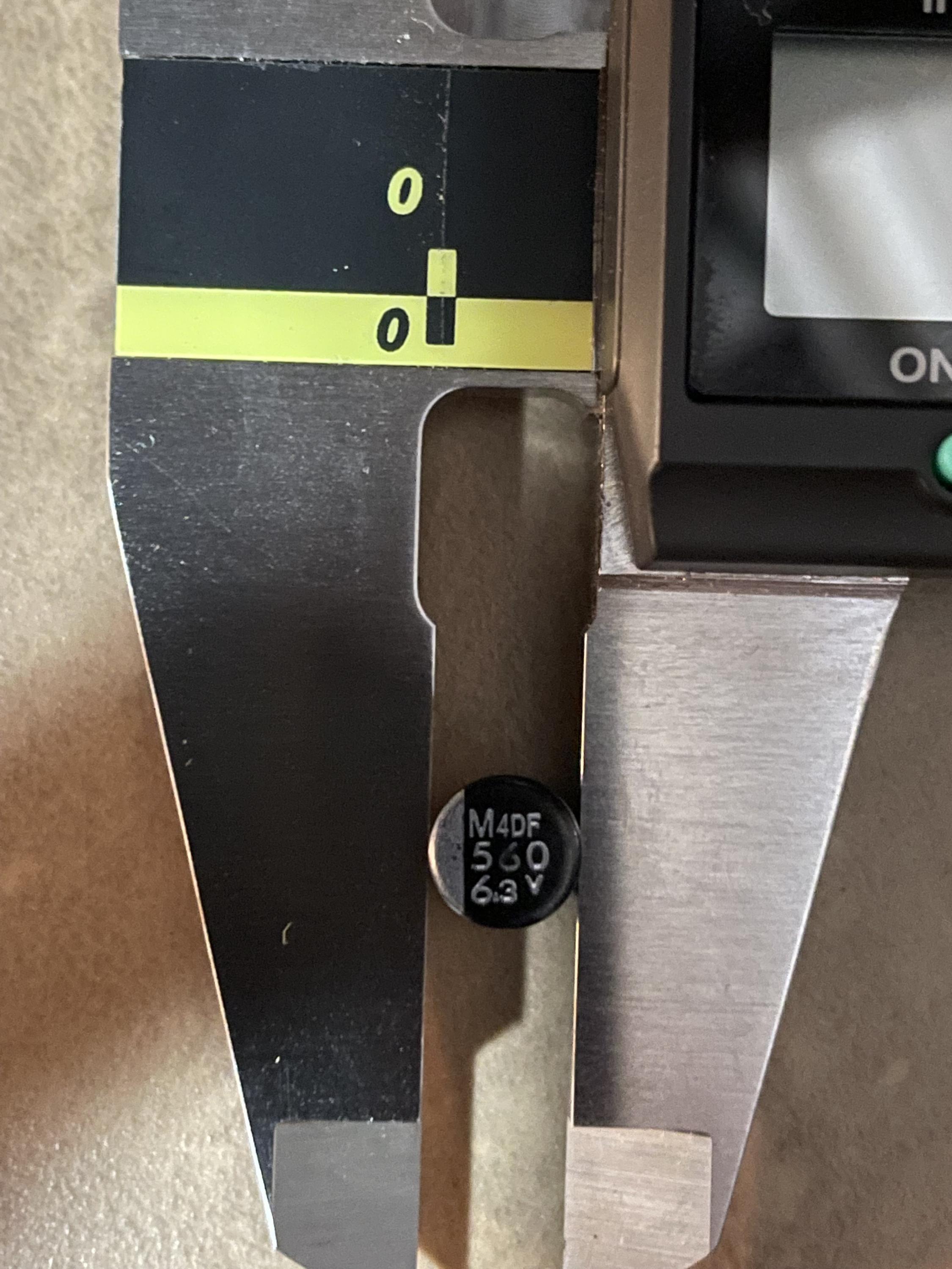

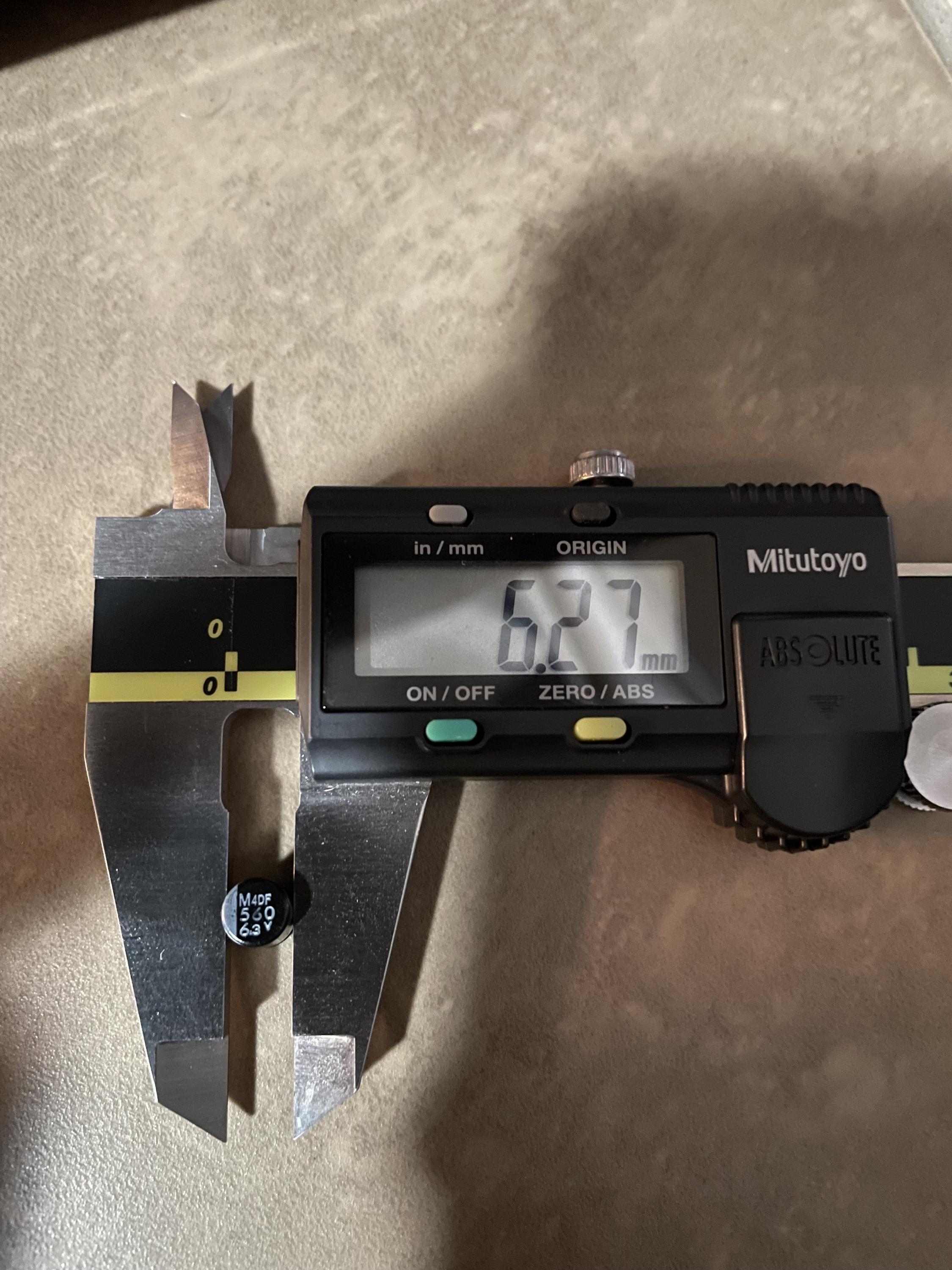

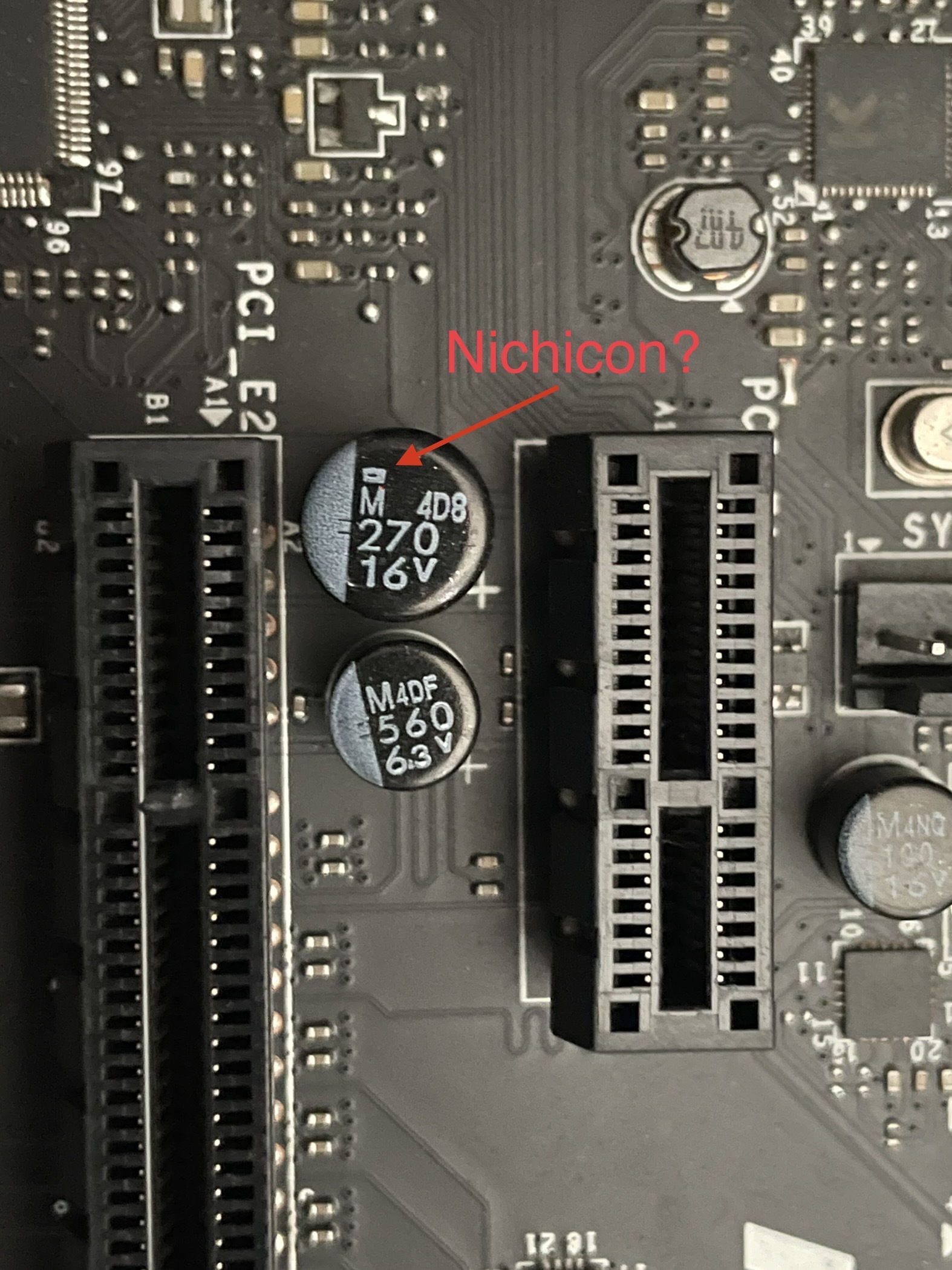

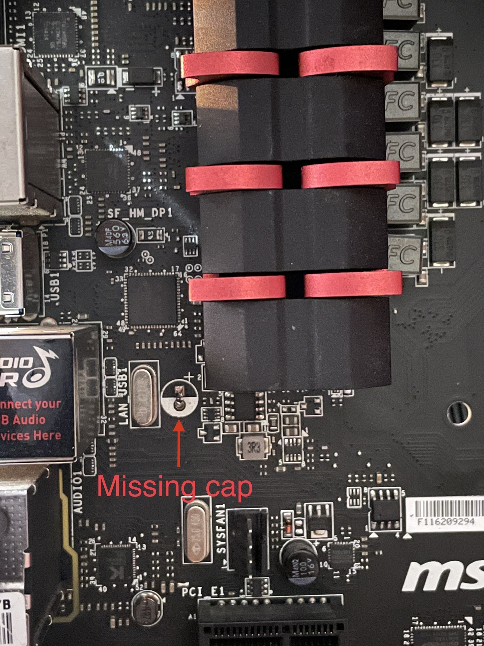

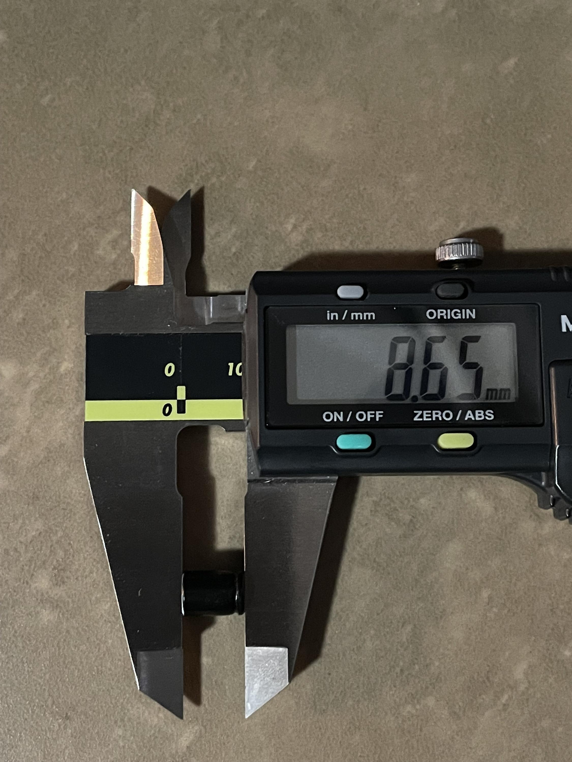

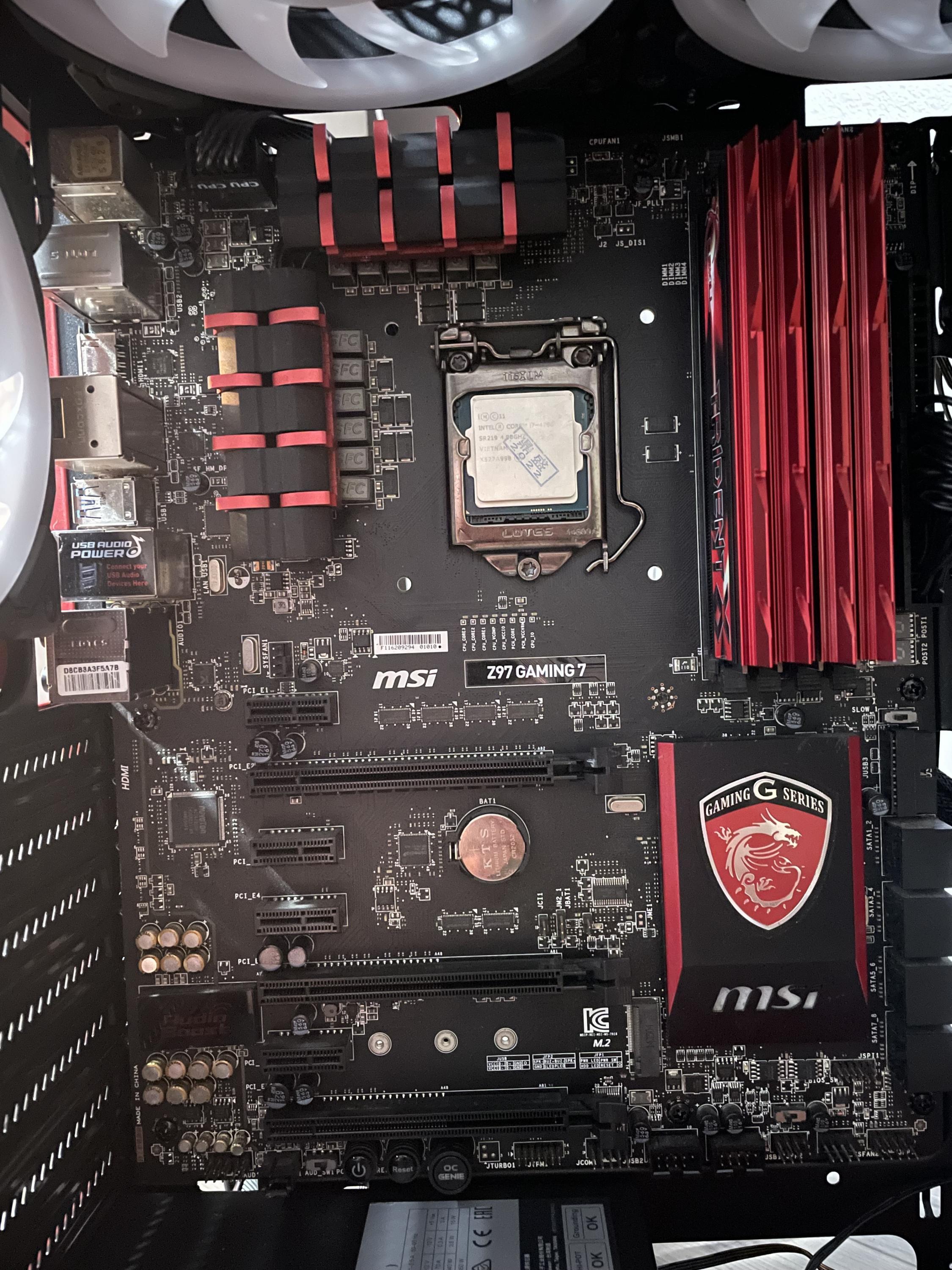

    Hey all,
    Sorry for the newbie request. I could use some help identifying this capacitor. After getting a little too rough cleaning this motherboard, this cap fell off. Attached are photos of markings, measurements and a similar cap with what appears to be a Nichicon symbol (not sure if that means all caps are Nichicon). I have found caps with the same specs but different measurements. Also, I don't have a ton of confidence in how I narrowed it down on Mouser or the Nichicon website. Thanks!

    The manufacturer logo you see indicates a Nippon Chemi-Con/United Chemi-Con capacitor.
