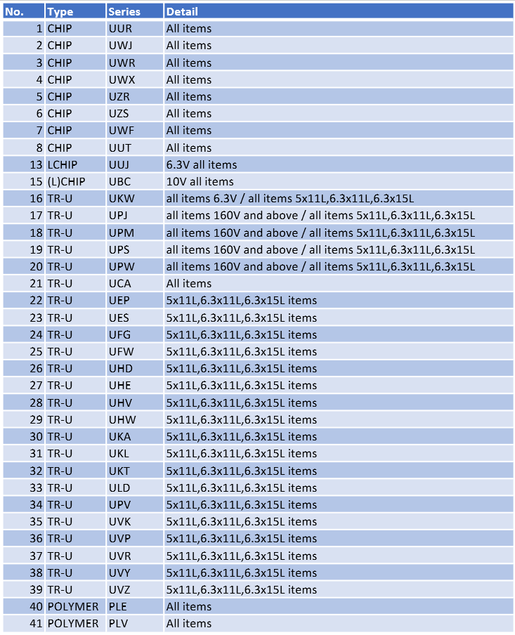

    2022-05 Nichicon is end-of-life mass terminating many really great electrolytic capacitor series: https://www.badcaps.net/download/?id=1c17c0c3
    Some seem to be about size? "We are notifying you that all 7mm height UPW series capacitors have reached their End of Life. Last time to buy date is September 15,2021. End of production will be on March 31,2022."
    https://www.badcaps.net/download/?id=1a7cf59b
    I notice Digi-Key is listing "Not For New Designs" across the line for Nichicon electrolytics such as UPW, UPJ, UPV, UKL etc.
    If this is true, it's just tragic.

                Re: Nichicon - discontinuing many electrolytic capacitor series
                Unless I’m misunderstanding that chart, it looks like selected case sizes and/or voltages are being discontinued rather than entire series. The PM/PL series has been around since the late 1980s, and the PJ series is pretty long in the tooth as well. If certain HE series parts are hard to find, the PA series is similar in impedance and ripple current rating.
                  Yeah, they're discontinuing selected parts instead of the entire series in most cases. I used a lot of Nichicon VZ in those smaller can sizes.
                    It seems like they're discontinuing at least some of the UHD and UHE series as well(Ultra Low Impedance electrolytics)
                          Nichicon actually continues producing and selling older series for a really long time. The PM and PS series are RoHS-compliant versions of the 1980s PL and PR series (~35 years old!). The PJ series has probably been around for 20 or 25 years.
                          Nichicon is not, at this point, eliminating many of those series, just low-selling case sizes (were 8mm, 10mm, and 12.5mm, and 16mm diameter cases affected at all?). That said, if someone is looking to design in a 16mm diameter low impedance electrolytic, choosing a PM, PS, or PJ series part for a product expected to be in production for 5 or 10 years would be a very bad choice.
                            Digi-Key lists them as mass discontinuation, I think Nichicon might be trimming through-hole parts? Vanilla 1,000uF 25V 10mm dia parts listed as not for new designs.
                            But realistically, who here has seen Nichicon in new products? Manufacturers have all gone over to using to the cheap chinese capacitors, for years now.
