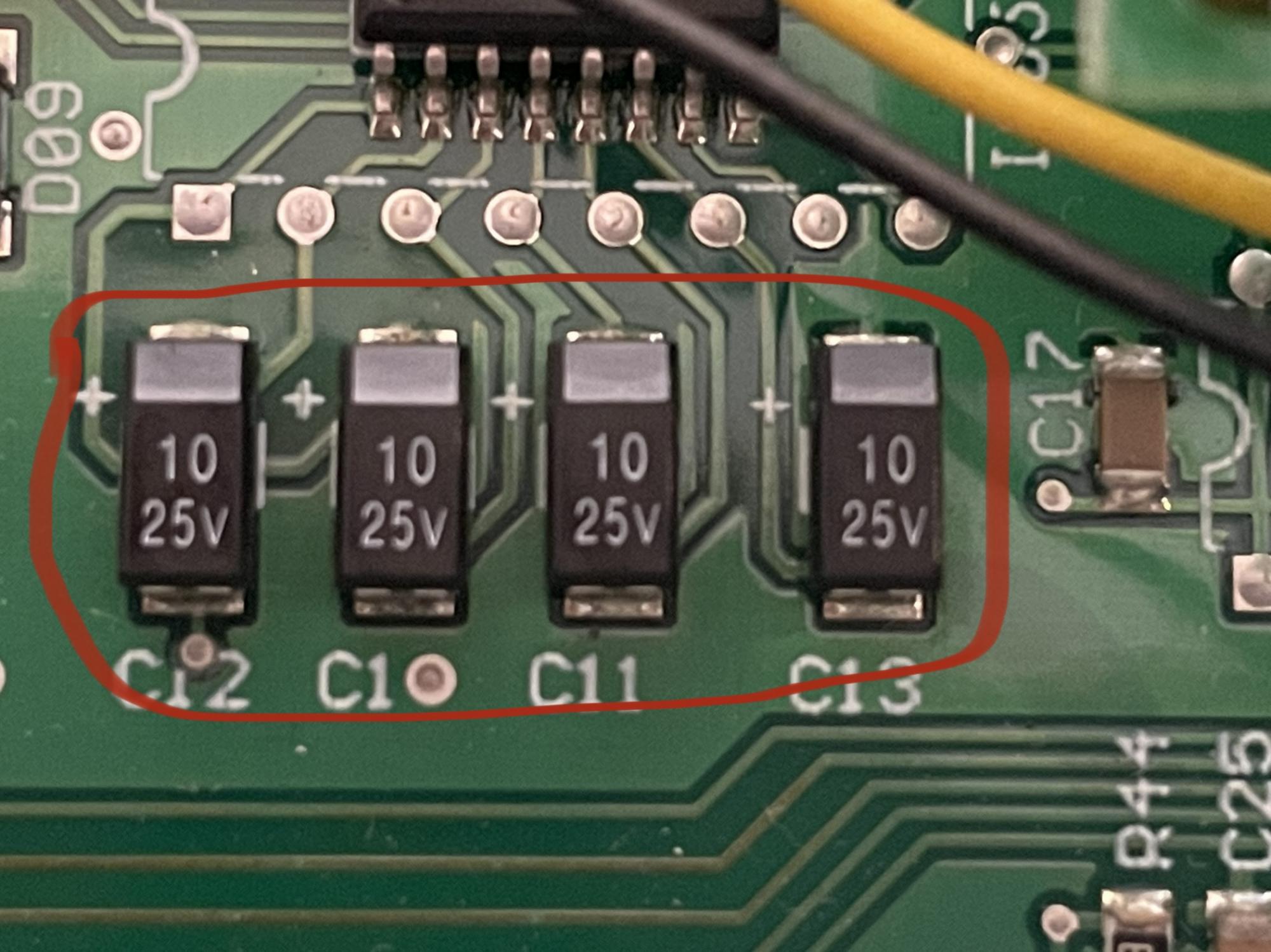

    I Would be very grateful if the type of the 10uf 25v caps in the photo can be identified, these are on a 15 years instrument board that is fairly used.
    Are these solid electrolytics?
    Would these go bad?
    Thank you!
  • R_J
    • Jun 2012
    • 9624
    Re: Need to identify these caps please
    They seem to be tantalum, but are likely just fine. They seem to be coupling a signal from one pin to the other of the ic.

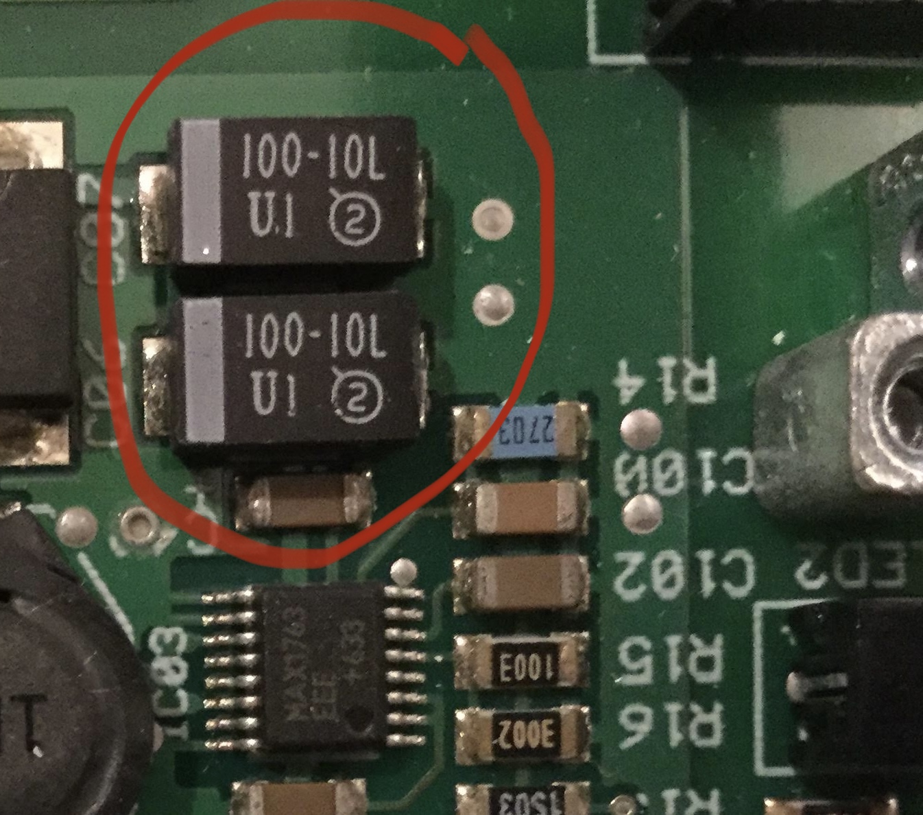

      Thank you R_J. Are these ones tantalums too.
      Are they 100uf 10V?
      what are the other markings on them?
      much appreciated
      • R_J
        • Jun 2012
        • 9624
        Yes, they are Vishay 100µf Mn02 Tantalum Capacitor 10v 593D Series Mfr pt# 593D107X9010C2TE3
