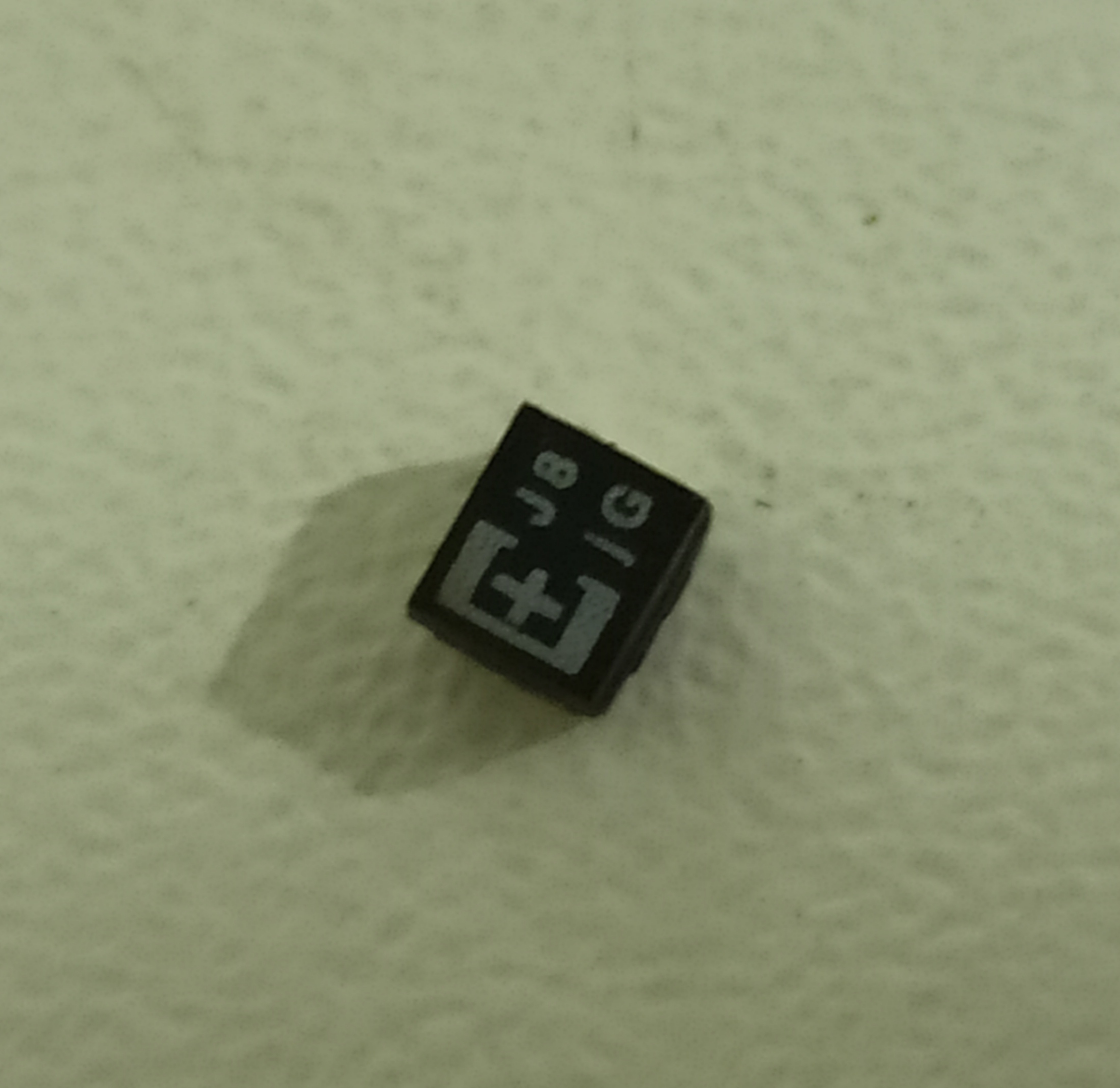

    Hi, i'm having some difficulties trying to identify this cap voltage and capacitance. Can some one help me?!

    Panasonic TPE series (size B), (J8) 220µf (j) 6.3vdc (G) lot number

      Thank you! I had to replace two of them. Did Not have this size with this specific capacitance so I just use three of 150uf.
