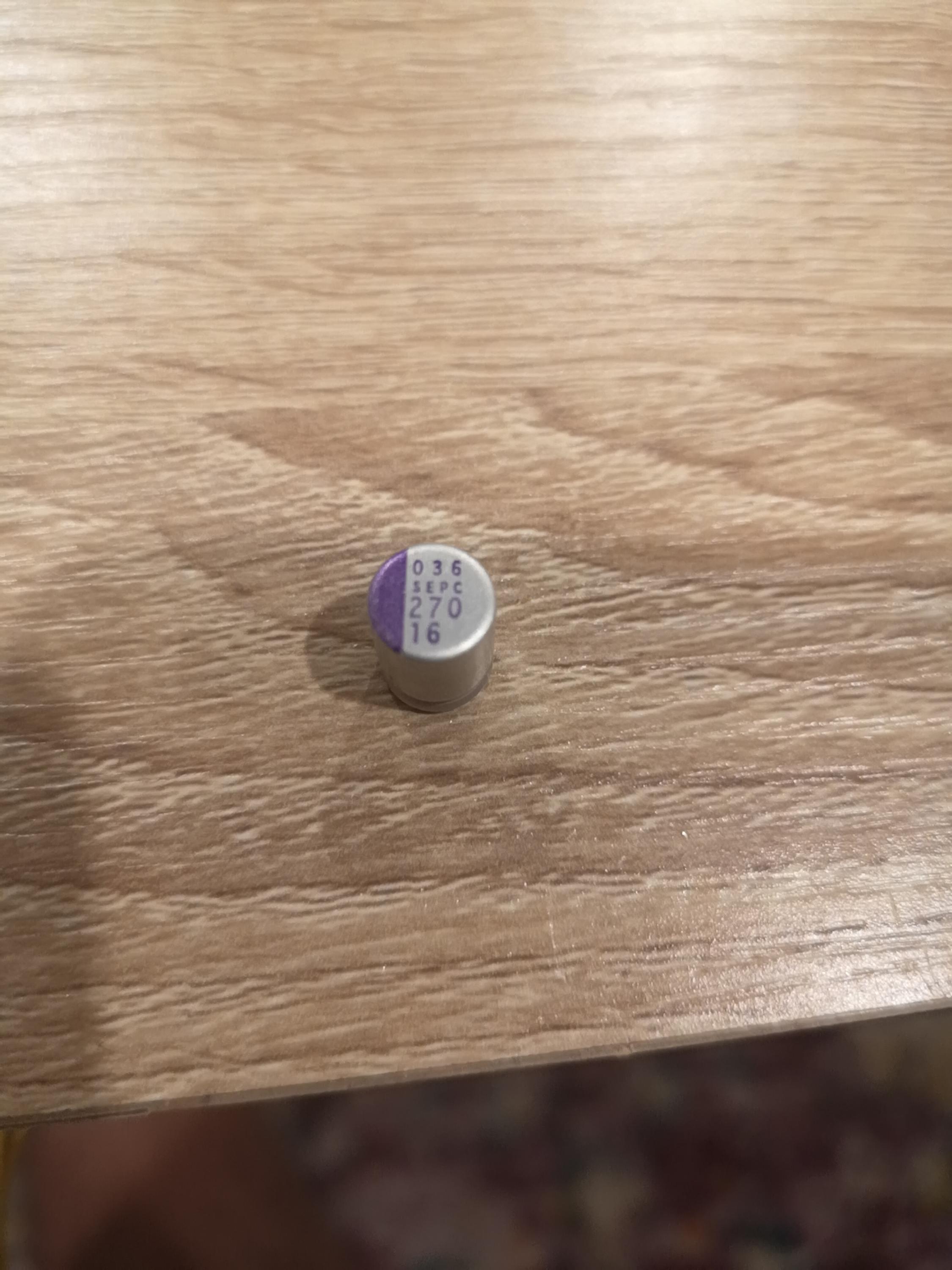

What is this value?
  • Jackching
    • May 2017
    • 127
    What is this value?
    Can anyone tell me the value of this capacitor and can I replace it with an electrolytic cap?
    • 22159
    Re: What is this value?
    270uF 16V
    • Jackching
      • May 2017
      • 127
      Originally posted by SMDFlea
      270uF 16V
      OK haha so any capacitor type would work as a replacement right? Its not surface mount
        • 31289
        no, it's polymer - ultra-low esr.
        you need to use polymer
