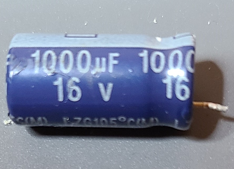

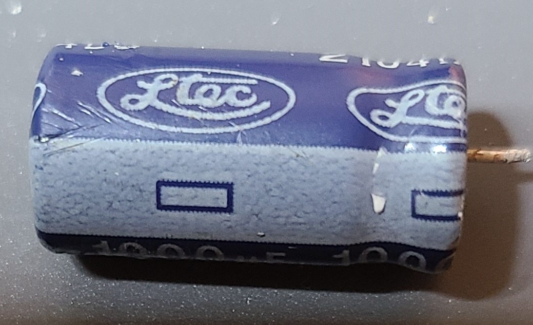

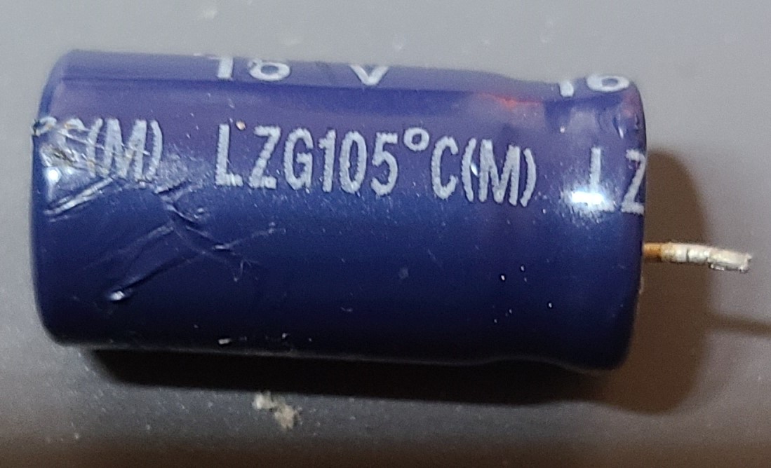

    Is this a good replacement
    I have 2 x Cisco SGE2010P's that were given to me because they do not work.
    When I opened them I found a blown cap, same cap in both actually.
    I'm not 100% familiar with the labels on caps so I'm wondering if this is a good replacement.
    Blown: 1000uf 16v Ltec (I think)
    Potential replacement: https://www.amazon.com/1000uf-Capaci.../dp/B004O21PPE
    Will that work as a replacement or should I look for another?
    • 31214
    Re: Is this a good replacement
    use panasonic FR series
    and make sure the diameter matches before buying, or it wont fit on the board.
    • Frostbyte
      • Jun 2020
      • 3
      So I pulled up a list of the panasonic FR caps on mouser:
      https://www.mouser.com/Panasonic/Pas...RoCqzoQAvD_BwE
      They both look the same so which would be better?
      Also both say the size is 10x16mm but I measured the cap as 10x20mm, I know its blown so its actually smaller but still does height make a difference if its a MM off?
        • 31214
        diameter is important, height only matters if the replacement is bigger
