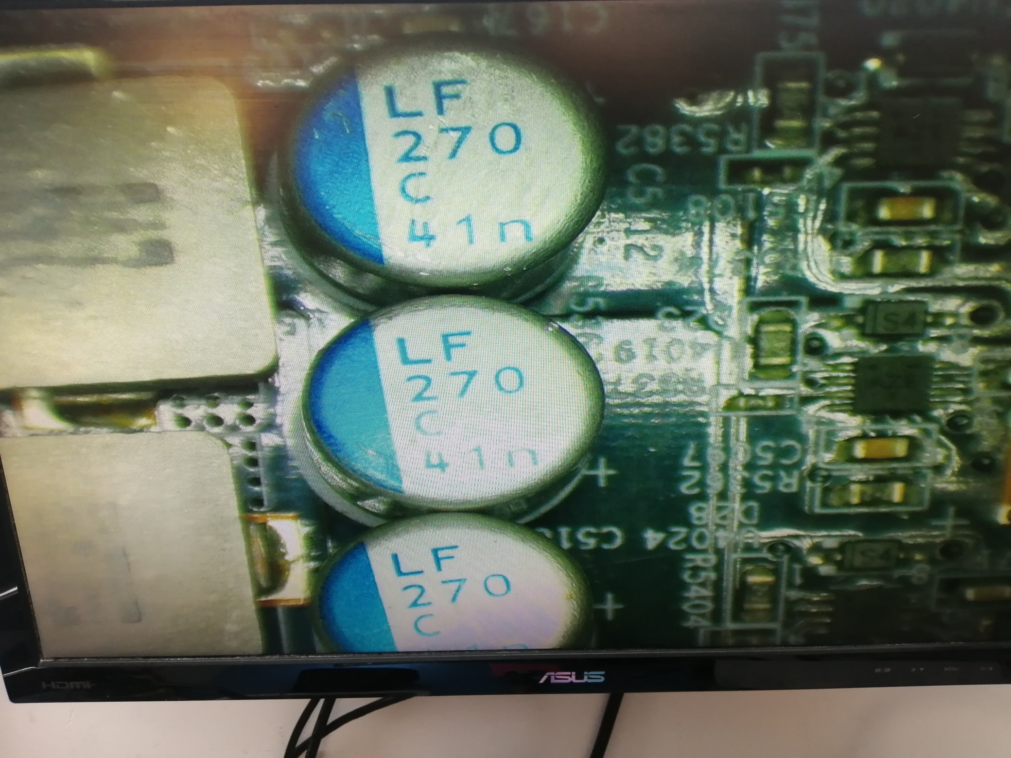

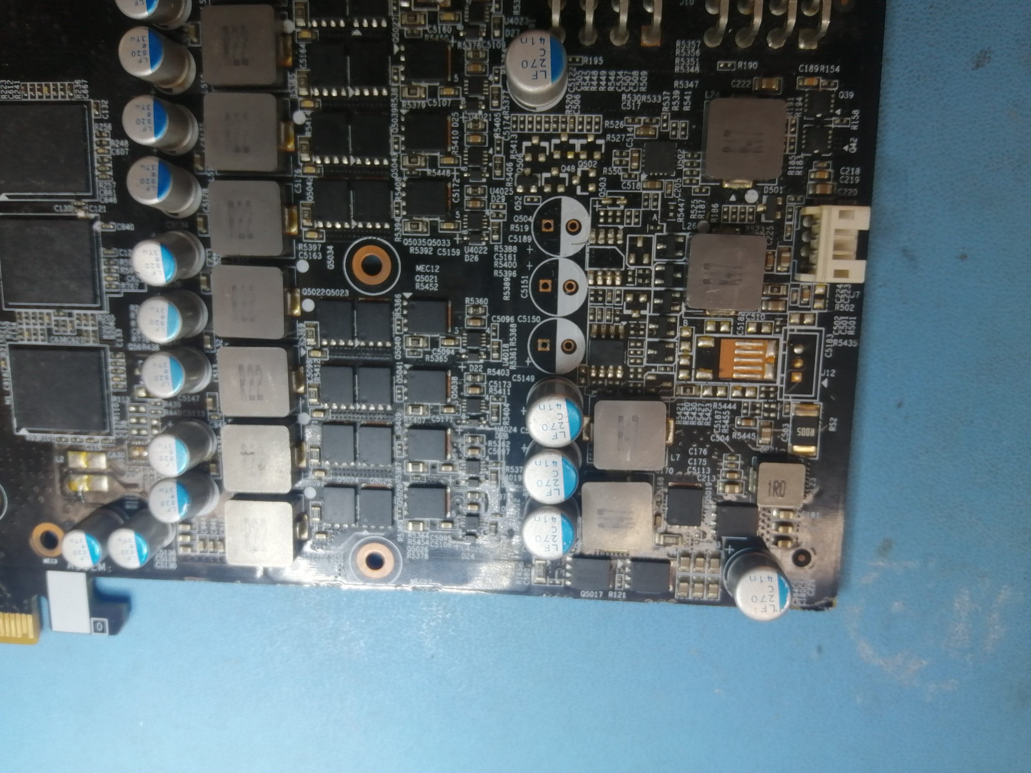

    What sort of capacitors are these?
    Guys, what sort are these - so I can order some replacements
    They are through hole not SMD. Also how do I read the markings on this type to determine the voltage.
    I take it the 270 = 270uF

    Re: What sort of capacitors are these?
    Nichicon PLF I think.
        Nichicon PLF
          270uF, 16V
