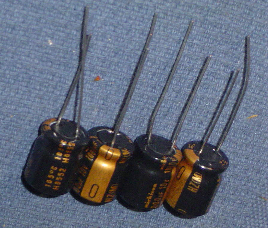

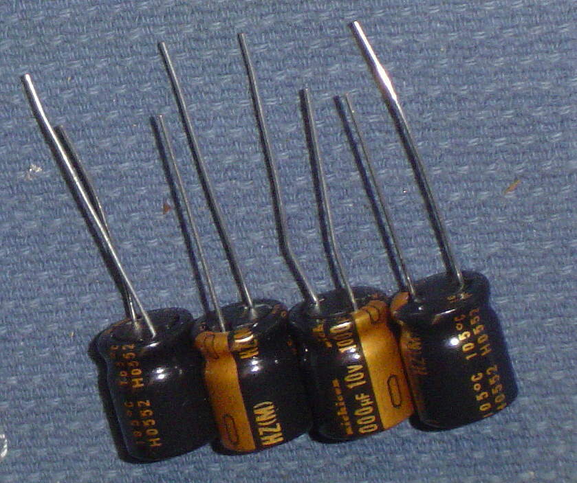

    I've got these caps from my local distributor.
    I'd like to know they're reals Nichicon HZ or fakes?
    please help me identify them.

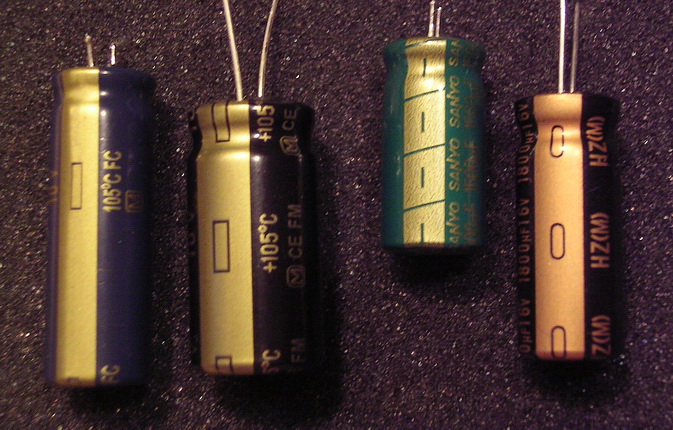

    Re: Are These real Nichicon HZ or fake?
    I have several bags of HZ's and their printing looks more copper colored than yours.
    When compared side-by-side to Pana FM's, the FM's are brass/gold and the HZ's are copper.
    Could be the lighting/flash.
    Seems they're 4 years old too. Date code on mine is H0918

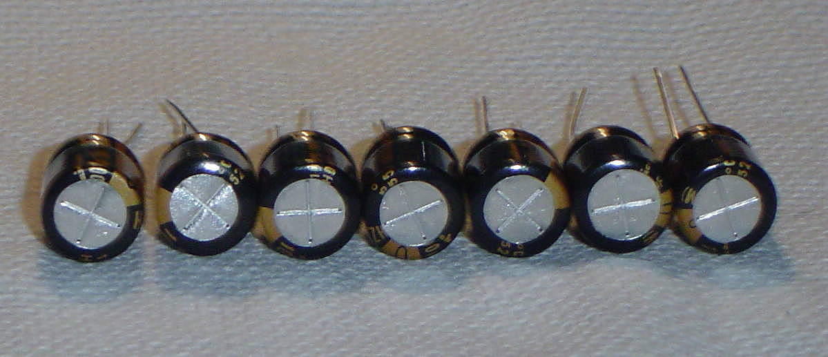

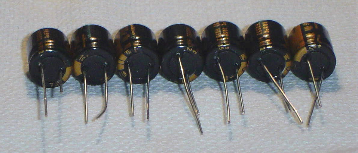

    Here's a quick pic from some of mine.
    Toast
    EDIT: FC - FM - SE - HZ
      Have these same exact nichicon HZ caps in this dell optiplex gx280 near the power supply. Same size and color.

        printed copper color of your HZ are sharper than mine.

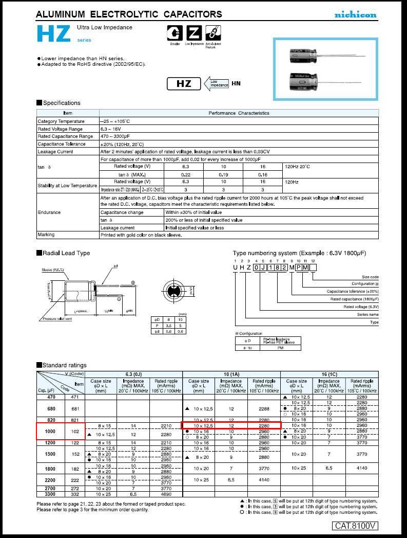

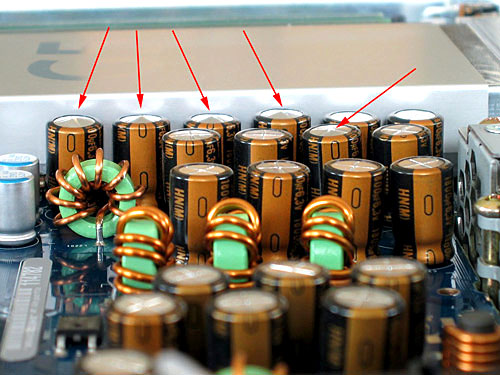

              Consider by Yourself . See attaches (not my pictures).
              These amber coloured ones are all fakes that passed my hands, i replace them pronto, iff occur. The original HZ series, as You may see on the PDF too by the BW gradient, has the traditional grey-on-black colour.
                The ones in your pics are HN not HZ. That's an iMac G5 mainboard.
                Those are not fakes. Those -were- a known bad cap along with the HM series. Seems that Nichicon got caught in the bad electrolyte mess back then.
                Here:
                http://www.nichicon-us.com/english/p...ini/pict_f.htm
                [EDIT: added URL to color pics]

                  Excuse me, i wasn't enough punctual at searching.
                  So any of these amber-coloured Nichies aren't going well. They have sometimes much worse graphics on-printed, and the vent hole isn't as well-made (you can see these on high res images easily) as on other ones. I am still unsuire if they are real nichies, as the series are present, but none of them has these issues on the exterior design. Has Nichicon any white papers about this?
