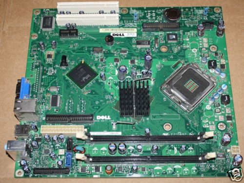

    First off, great site. Within 1 week, my LCD died, SageTV HD extender died, and my friends Dell E310 won't boot into xp.
    Fixed my SageTV and LCD no problem, but the Dell is still having problems.
    Symptoms started with machine not shutting down, then problems with USB syncing to Ipod. Now, it won't boot into windows, BSOD. However, it DOES pass all the Dell diagnostics!
    Inside, the two 1000uF 10v, KZJ (M)105, 5(2), DI between the RAM sticks were leaking brown stuff on top so I changed those, but made no difference.
    There were several 470uF caps sitting a little sideways, but looking with flashlight underneath didn't show anything. I'm assuming they just were not installed straight? Thoughts?
    I saw another post on here for the same machine that the PS had blown caps, but I didn't check that. I will when I get the machine back.
    Should I just replace all caps on the board, or ones above 470?
    Also, I only have a 40watt iron with pencil tip. When removing those two caps, the surface of the board around the hole turned 'slightly' brown from the heat. There were several trace lines VERY close to the leads. Is this a problem? Can I damage these trace lines with just a little heat?
    My solder didn't touch the trace lines, but they are very close. Do I need to worry about trace lines on the other caps or is there some coating over them that protects them?
    Thanks for any advice! Mike
    P.S. I'm using Panasonic FC for replacements.

    Not low enough ESR for this job.
    By what you've said this is the #1 suspect.
    KZJ is a series. What brand? Could be more than one KZJ.
    If you used FC the ESR isn't low enough there.
    There were several 470uF caps sitting a little sideways, but looking with flashlight underneath didn't show anything. I'm assuming they just were not installed straight? Thoughts?.
    If the bung isn't pushed out they were just installed crooked. Not all that uncommon.
    Don't have enough info yet to make that call.
    What brands and series are all the caps?
    Yes you can damage it.
    You want a lot of heat so you can get on and off the board quickly.
    That minimizes the heat spreading through the board.
    I'd recommend a 60 Watt with a 2mm to 2.5mm chisel tip for removal.
    A 40 Watt with the same size chisel tip might be okay for installing.
    The coating won't protect them from heat or mechanical damage. It's for oxidation.
    Yes, you do not want to damage traces.
    Are you using solder braid to remove the solder?
    Speeds things up.
    Use a needle to clear the holes so the new caps fit.
    Needle on one side, iron on the other until it goes through.
    Check the ESR and Ripple of the original caps and choose your replacements by that.
    If you need help finding that info then tell us what the old ones are.
    Frys Electronics [if you have one] has a basic 60 watt iron for $10-$15 but the 'stock' tip will need changed to the style I mentioned above.
    They will also have solder braid.
    Since you don't see any bloated caps on mobo - check the PSU!

      There aren't any other markings on this cap.. only a raised 'V' on the rubber on the bottom. It's black with gold negative line color with an oval..
      Similar colored Dell E310 cap from PS But obviously no OST marking.
      What series should I use here? Could these still be the actual problem, but I just didn't fix it due to wrong ESR?
      Thanks again, Mike

        >> There aren't any other markings on this cap. <<
        That's an Intel built board. Intel doesn't use unmarked or even non-Japanese caps.
        If you have one then someone else has worked on this board before and that might be the problem.

          It was the two big caps between the DDR slots. They even have the same blue line (marker?) across the top. I think this is an original from Dell, i.e. one owner. There is a symbol of some sort before the KZJ letters.. Almost an outline of a rectangle, but looking close, it looks like there are slight flares on the outside top corners and right in the middle of the top as well. Sort of like outline of a dutch oven? Kinda.. maybe..
          When I get it back.. I'll check the other caps, but I don't know if they will mean anything, since they don't all have to be the same it seams.

            That logo is a Shield ---> Chemicon

              Hmm.. those are supposed to be good caps.. Maybe PS caused this?
              Looks like both my ESR and Ripple current are way low with the FC caps.
              I'll have to search around on Mouser for something to meet those specs. I work only a few miles from their warehouse, but they don't allow pickup. Oh well, last order only cost $4.50 and showed up 10am next morning.
              I'll have to wait to see what other caps need to be replaced before ordering.

                Chemicon is also called UCC for short.
                The base company is United Chemicon. They have several regional based satellite companies such as Nippon Chemicon for distribution but all the various Chemicon variations are the same company.
                UCC KZJ 1000uF 10v [10mm - judging by pic] - ESR .018 , Ripple 1960
                Panasonic FC are no where near up to that task.
                FC's ESR is almost 4 times higher and they handle about 1/2 as much ripple.
                Of the caps that are fairly easy to get your hands on lately, Rubycon MZC would be the best choice to replace those.

                      On digi-key, the only thing I found was
                      Nichicon CAP POLY ALUM 1000UF 10V SMD r PCG1A102MCL1GS at a whopping $2.75 each, but I don't know if that is the right kind anyway.. SMD?
                      Looks like badcaps store is my next stop.
                      Also, is there a chance that those are still my problem caps? Or are they just more likely to blow sooner?
                      -Mike
                      • PCBONEZ
                        Grumpy Old Fart
                        • Aug 2005
                        • 10661
                        Re: Dell E310 problems - Need advice
                        No no, you need a "Radial" cap.
                        SMD is "Surface Mount Device". - SMD have no leads, just solder tabs.
                        The new BCN Rubycon page is here.
                        https://www.badcaps.net/store/index....p3tpetlkjtg313
                        I'm not following the last question.
                        I'm not sure which 'those' or what 'they' you mean.
                        Mann-Made Global Warming.
                        - Dr Seuss
                        • PCBONEZ
                          Grumpy Old Fart
                          • Aug 2005
                          • 10661
                          Mouser does have some in HZ.
                          HZ 10x12.5mm - ESR .012 , Ripple 2280
                          http://www.mouser.com/Search/Refine....rd=UHZ1A102MPM
                          The HN 10x16mm would work but they are out of stock.
                          It's also not a problem to use a 16v cap in place of a 10v.
                          - Dr Seuss
                          • friscokid
                            • Oct 2009
                            • 16
                            http://www.mouser.com/Search/Refine....rd=UHN1A102MPD
                            This is the HN in 10mmx12.5mm. Would that one work? It's 200 lower than the original on ripple current. No problems though, since HZ is in stock, just trying to understand for future reference.
                            I'm getting the machine back tomorrow, so I'll checkout the PS and see what I can find out.
                            I was using the 'ESR' column in the filter on mouser to search for Impedance. Guess that wasn't right.
                            Thanks for finding those!
                            • PCBONEZ
                              Grumpy Old Fart
                              • Aug 2005
                              • 10661
                              Not your fault.
                              Mouser's ESR search doesn't work very well because they don't enter all the data for -all- the caps in their database.
                              If they don't enter it the search can't find it.
                              For their caps database Mouser is only reliable about entering UF, Volts, and Temp.
                              Everything else is hit and miss.
                              At Mouser also always double check the physical size Mouser claims in their info to the info in the manufacturer's data sheet. I've found a lot of errors for the diameter. They also often list the lead's wire diameter in the space that's supposed to be the Lead Space. [Lead Space = The distance between the two leads.]
                              Gotta remember the data entry people dunno squat about caps.
                              No I wouldn't use that HM.
                              For Ripple, more is better.
                              Ripple is basically how much Ripple Current the cap can handle without over heating internally. [Could sort of be compared to an amp rating for a wire.]
                              As the original went bad you don't want a cap that handles less Ripple than it did.
                              For ESR, less is better.
                              ESR can basically be thought of as the resistance to passing Ripple through the cap.
                              Since the caps connect Ripple to ground to filter it out of the circuit, less resistance to passing the Ripple is better.
                              - Dr Seuss
                              • friscokid
                                • Oct 2009
                                • 16
                                Update: Finally got the machine back, less all the USB stuff hanging off and the original HD.
                                Opened up the PS, everything looks fine.
                                I hooked up a new USB kb and mouse and new SATA HD with Vista instead of XP.
                                Machine still has hi ESR Panasonic FM caps from earlier.
                                Boots fine and running Prime95 for over half-hour so far..
                                Previously, XP would not boot at all, even into safe-mode.
                                Could this still have been a bad driver or related to one of the USB devices pulling too much power?
                                There was a webcam, printer, Zip drive. Recall, the IPod shuffle had erratic behavior dropping on and off device list (It was trying to charge off the usb port as well).
                                Anybody seen this before?
                                • PCBONEZ
                                  Grumpy Old Fart
                                  • Aug 2005
                                  • 10661
                                  USB Ports are rated to provide 0.5 amps max. [Total for the Port.]
                                  Anything more than that and the devices need to have their own power sources.
                                  - Dr Seuss
                                  • friscokid
                                    • Oct 2009
                                    • 16
                                    I would assume that Apples Ipod is within spec (hopefully).
                                    I'm just wondering if there could still bad caps on the board (or my changed caps) and that it just appears stable right now because there aren't really much USB load on it right now.
                                    I guess to know, I should get one of the ESR devices... That MicroESR looks good, but the website looks questionable.. Maybe I'll just get the Blue ESR instead. It would pay for itself with just one saved motherboard...
                                    -MIke
                                    • PCBONEZ
                                      Grumpy Old Fart
                                      • Aug 2005
                                      • 10661
                                      You need to look on the device to know how much it uses.
                                      - Dr Seuss
                                      • friscokid
                                        • Oct 2009
                                        • 16
                                        Well, Vista seemed fine, but I tried to boot into FreeNAS, a BSD based OS, and it immediately gives an I/O error on the USB-Hub and shuts it down. Only a keyboard hooked up.
                                        Definitely something still wrong within the USB hardware for the machine.
                                        Suggestions on anything I can check with a DMM or should I just order those two low ESR caps first?
                                        Thanks for all the help so far, Mike
