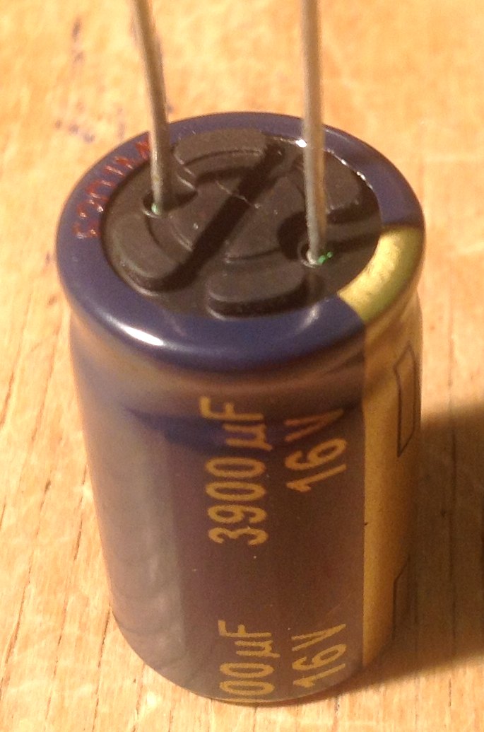

    New Panasonic FC series cap I got from Digikey, tossed it in the parts bin a year ago. Today, I saw the leads have green corrosion on both leads at the bung?!
    It this leaking, yet never used? EEUFC1C392
    The datasheet says: "This Series is no longer available for purchase in the country of Japan."
    Gosh, is FC's quality has gone to china?

    Re: Panasonic FC series - leaking? quality gone?
    I've seen capacitors leak white, yellow, brown and black colored electrolyte but never green.
      That green stuff is corrosion from the leads, suggesting either electrolyte has done it or something else when the capacitor was cleaned.
      I've seen this quite a bit on old Nichicon PR series capacitors, and those tend to leak out of their bungs quite frequently after some years. I've also seen this on some new Nichicon PM caps.
        yupp, that greenish colour looks exactly like copper oxide. looks like the copper of the cap leads has somehow become oxidised and it seemed to originate from inside the cap. if it were due to oxidation/corrosion due to environmental storage conditions, the oxidation would be seen randomly around and all over the leads but it seems to be occuring coming out from the leads inside the cap, so something went wrong inside the cap.
        if this happened on only one cap, i'd just attribute it to being a bum/lemon cap that escaped qc at the factory. shit happens...
          the bung hardens over time - maybe because of an interaction with the electrolyte,
          maybe because of the humidity or temperature of the enviroment.
          i have seen lots of leaked FC's and mentioned it atleast a few times.
          always around the bung, and they are never domed.
          i have not seen the same issue on FM or FK.
            The bung hasn't even been through reflow or any soldering.
            It's a high-end part with AEC-Q200, 5,000hrs 105°C and last time I saw this was on 30 year old Spragues. I emailed Panasonic to see if they will comment.
            Panasonic FC series has been my go-to for replacements in vintage gear. Not SMPS where low ESR is essential, but instead for audio gear. I'll have to find something alternate I guess.
              What does the datecode on the FC say? I know how to decode Panasonic’s date decoding format and as do other members here. I guess it can’t be that old - probably less than a decade old. Momaka’s Nichicon PMs, going by the original revelation he posted, leaked around four years ago now (after only five years in storage judging by their datecodes). That Panasonic FC would be exhibiting this type of behavior, along with Nichicon PM, is equally confounding. I only know of two types of capacitor “plagues” which caused Japanese electrolytics to leak from the bung with no notable hydrogen gas production - the quaternary ammonium salt plague from the late 80s / early 90s (which should no longer be an issue) and a separate problem from that time frame and a bit later with 85ºC capacitors and SMD capacitors having problems with rubber bung deterioration (and leakage thereafter).
              It would be a pity if Panasonic FC ended up having this problem. I know a number of members have used them here in their repairs before, and it would suck if this comes back to bite them.
                6201MC, DF is 0.25, ESR is good.
                            1st response from Panasonic rep:
                            "... I would not use a part that had corrosion on the leads. It could effect the performance. Sounds like moisture got into the packaging. Please let me know if you have any questions."
                            I won't store them in the rain lol
                            I guess FC's have some seal problem if they are leaking even before being used. Sad.
                              one thing i'v noticed with leaking caps regardless of make - it's usually the same leg.
                              i think the negative.
                              could it be some type of electrolysis drawing the fluid to that side?
