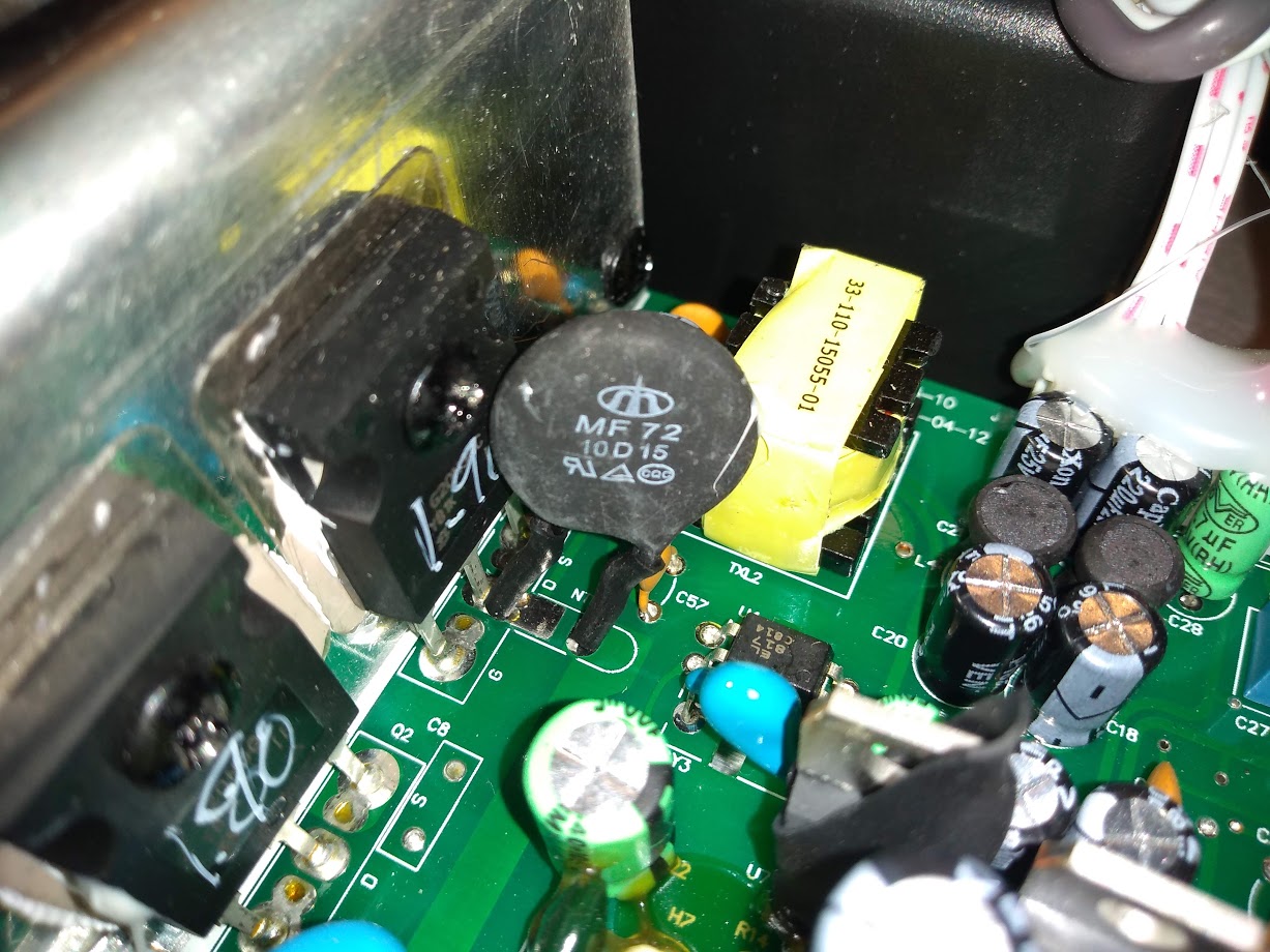

    Hi All,
    I have just momentarily short circuited the output of an amplifier and heard a pop. On inspection it took out a 2.5A fuse and also what I think is an NTC thermistor.
    Excactly like the black one pictured here:
    My question is, am i right is this an NTC and if so how do i identify the rating/spec in order to get a replacement.
    Many thanks

    Re: Component Identification Help Please
    Yes it is a NTC made by Cantherm, Pt# MF72-010D15
      That's great, many thanks.
