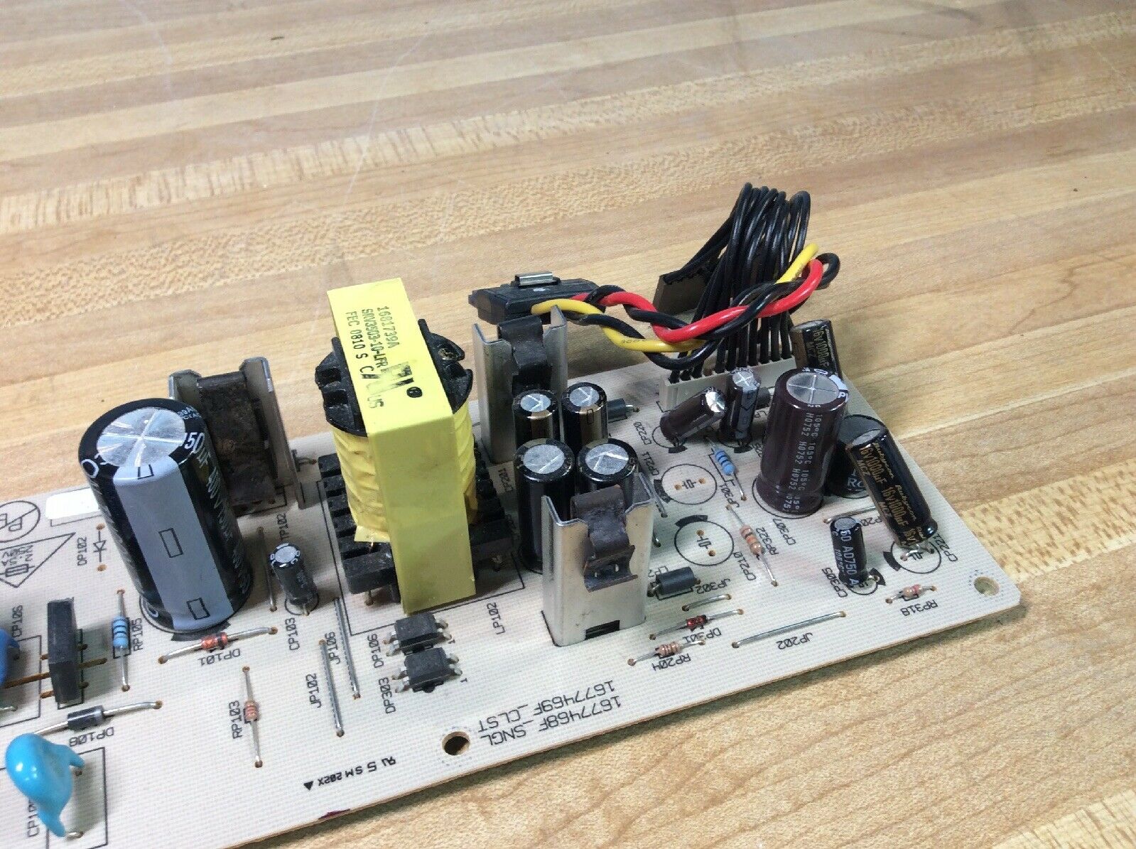

    I have a DVR that I was replacing the fan in, and noticed one of the capacitors on the power supply board had failed (all others are fine). It was slightly domed with the bottom pushed out. It's a Rubycon 2200μF 10V MCZ - so it's ultra low ESR. Since these have been discontinued, there isn't a direct replacement. I've tried finding something with similar specs, and what I think will work is the RNL series from Nichicon - specifically this one. It's the same capacitance, slightly higher voltage rating (which I understand is fine), and the diameter is the same, slightly shorter (height isn't critical here anyway). I think the ESR rating is okay - the Rubycon is rated to 9mΩ and the Nichicon for 8mΩ. It's the ripple current rating(s) I'm not sure of, and possibly other things I'm not aware of/overlooking.
    Basically is this a good substitute, or does anyone have a better recommendation?
    Thanks in advance to all that respond.

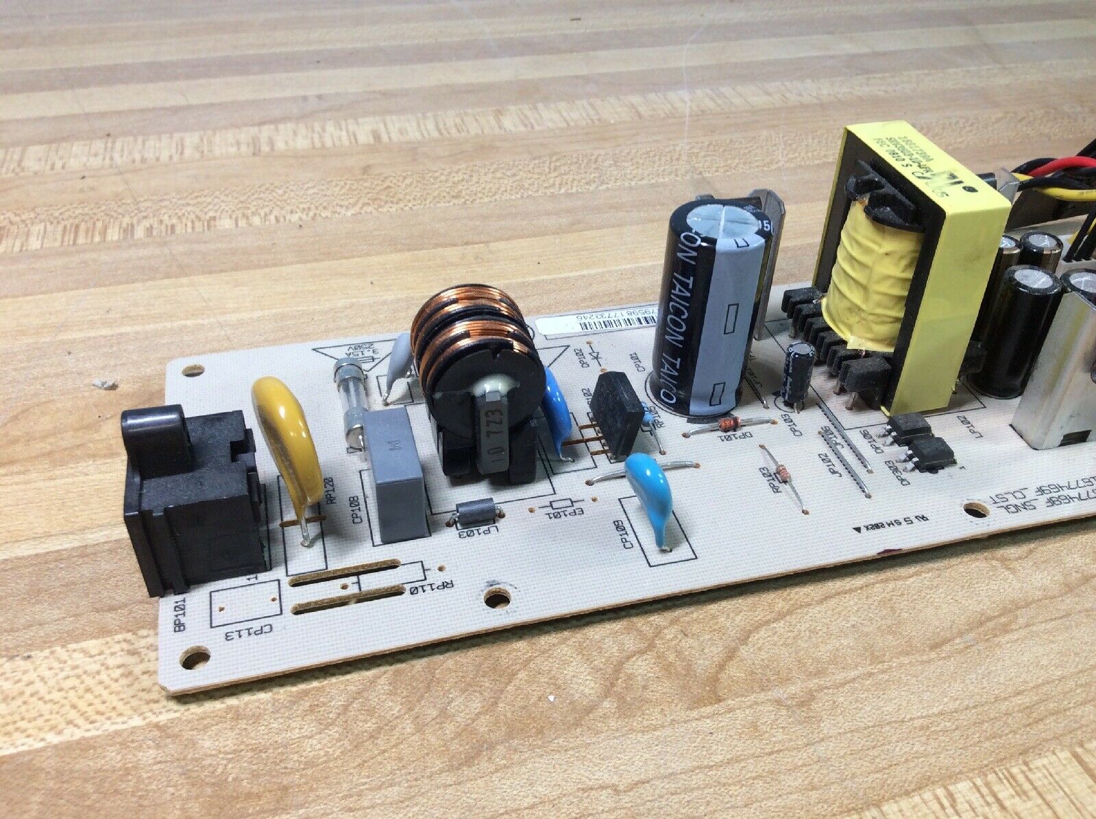

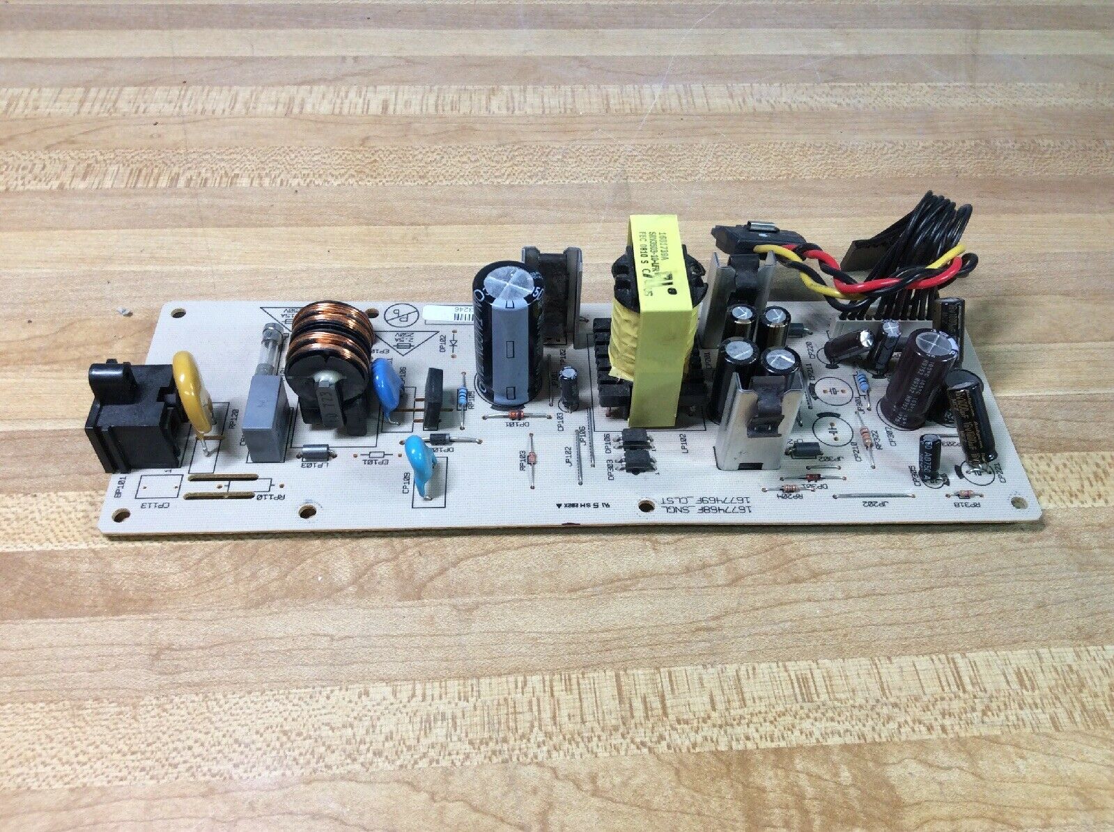

            Re: Help with capacitor substitution for a DVR
            I've attached some pictures of the power supply board from an eBay listing - it appears to have all the same capacitors. So, it doesn't seem to be from someone else previously replacing them. I have two more of these (same model) that I'll be replacing the fans in as well, so that should further confirm they're original.
            The only voltages I know for sure it outputs are +5VDC and +12VDC (which is standard) for the hard drive. The other connector doesn't have the voltage(s) printed on the board, and uses the same color wire for all its connections. They are likely 3.3VDC or less for the Broadcom CPU, RAM, and other supporting components.
            The one that failed is in the cluster of four to the right of the transformer between two voltage regulators. The front two in that group are the same value - the one the failed is the one closest to the transformer. The other MCZ series capacitors on the power supply board and main board are all 1000μF 16V.
              I sincerely doubt you need so high end capacitors.
              Most likely it was some overstock capacitors they had, or someone used them instead of other capacitors.
              I mean, you typically need these ultra low ESR capacitors to be soldered as close as possible to the circuit board, as close as possible to the switching regulator IC or transformers to keep the current loop as small as possible.
              Leaving such long leads on those capacitors kind of defeats the purpose, the extra wire length adds resistance and a very tiny amount of inductance
              Should be fairly safe to use FM, FR series from Panasonic, KZE from United Chemi Con...
              Also ...2200uF 10v is kind of in between... the psu outputs 12v, 5v and probably 3.3v ... so a 10v capacitor is most likely used to filter 5v or 3.3v, so you can easily use a 6.3v rated capacitor.
              So this would probably work : https://www.digikey.com/product-deta...198-ND/3998084
              And this 1800uF 6.3v capacitor would probably be just fine : https://www.digikey.com/product-deta...9-1-ND/5180935
