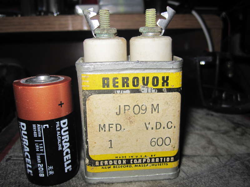

          I was wondering about the large can nonpolar paper/oil impregnated paper capacitors that were meant for motors, power factor correction, and other industrial uses versus little "tiny" ones mounted on... the other PCBs (i.e., printed circuit boards). The large ones, on the other hand, have a risk of fire if they are overheated or damaged due to surges or transients.

            @eccerr0r:
            The general rule with historic oil capacitors like that one pictured is, consider it containing PCB unless you can positively identify it as a non-PCB containing one.
            There are several lists compiled by organizations and authorities, for example this long one from Switzerland (40+ pages, German language).

              • eccerr0r
                Solder Sloth
                • Nov 2012
                • 8701
                Re: 1960s-1982 smelly caps - polychlorinated biphenyls?
                Incidentally, the ESR of that 1uF 600V cap is still pretty low
