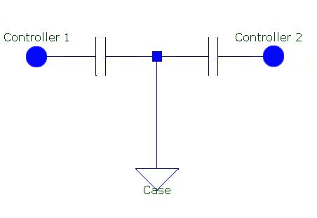

                          Thanks Toast. You helped me a lot (I'm quite educated on safety caps by now ).
                          anyway, I added the pics above. I think it's (b). You can see the capacitor connected in parallel to the line.
                          The current flows from the brown to the blue (through the 'rheostat-like' pedal) and then into the motor and back to the blue of the mains (so the blue in the pedal is actually the line and not the neutral, I believe).

                            Re: Need help! Identify an AC capacitor
                            I'd worked on my comment so long I didn't see your picture post. TY
                            I'll suggest now:
                            2 - Y style caps of matching or better voltage and capacitance. One leg of each to ground, the other leg to the 2 terminals where the bad one is connected now.
                            See attached.
                            Toast
                            PS: The controller is actually a series resistor. Typically a "carbon pile" type. As the pressure on the pedal is increased, the carbon discs inside are pressed more firmly together and the resistance drops, making the motor run faster.
                              Thanks! you made my day!
                              So that single capacitor served as 2 Y-style capacitors?
                              Just for my education - I think I saw some combined XY caps with 3 leads. would they fit too?
                                No. Must be 2 Y caps. Y caps, if they fail, are engineered to fail "open" and thereby not cause an electrocution hazard.

                                      >>This capacitor would be an X2 (or X1) class unit.<<
                                      Incorrect. Your information is going to get someone killed or injured.
                                      It is NOT a X cap.
                                      Please read what I posted before. If you use an X cap and it FAILS, the metal frame/housing may become energized and pose an electrocution hazard.
                                      X caps are used ACROSS the mains. X capacitors may NOT be used from mains to ground or casing.
                                      Y caps are used FROM mains to frame/ground. Y capacitors can also be used as an X-style cap across the mains. They are engineered to fail OPEN.
                                      Rated impulse voltages:
                                      X1 - 4kV X2 - 2.5kV
                                      Y1 - 8kV Y2 - 4Kv
                                      Two(2) Y2 types are what you should use here, as I described.
