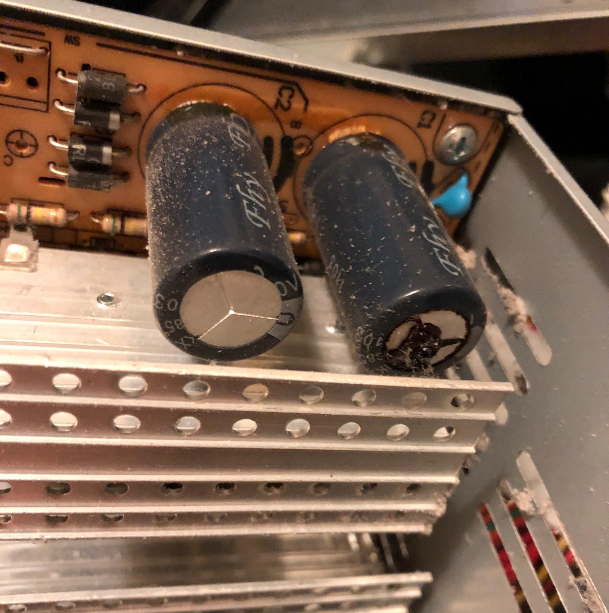

    My PC was failing to stay powered on and seemed to have to 'warm up' before it could be adequately used. Frequently it would just power itself off again mid-way through the POST.
    Opened up the computer, nothing obviously wrong with the motherboard or connections. Then I popped the lid on the PSU and saw... THIS.
    My question is, is this capacitor leaking gunk, or is it just something they put on in the factory to minimise vibrations (as I've seen on other PSUs)? You'd think that if it was the latter, there would be similar stuff on the other input capacitor...
    Certainly no signs of bulging on either of them!
    You know there's something wrong when you open your PC and it has vented Rubycons...

    i'm pretty sure the cap is busted and leaking. and its a junk fhy cap to boot. time to bust out the soldering iron.
      • 31288
      Re: Is this PSU capacitor bad?
      that's 100% guilty.
      but because of how they work, replace them as a matching pair.
      dont just replace 1.

        The 4-diodes in place of bridge rectifier and thin heat sinks don't exactly give me much confidence in general. Since bulk caps (at least good ones) generally aren't cheap (and if those failed I wouldn't expect the ones on the secondary side to be much better), depending on the quality of the PSU (can only see so much from that one pic, but what I see isn't good) you may be better off just replacing the whole PSU with a better unit.

          Don't bother repairing it. You can get yourself a nice budget EVGA unit for $40 or so.
