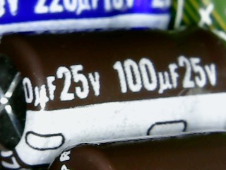

    What would be a suitable replacement for this Sprague capacitor. I wasn't able to find any info online for a H9111 cap. It's on an Outbound Mac clone notebook board from 1991. Pictures attached.
    master hoarder
    • May 2008
    • 12175
    • Bulgaria
    Re: Help with Sprague cap replacement
    Are you sure the brown cap with "H9111" is a Sprague? It looks to me like a Nichicon cap with a date code indicating it was produced in week 11 of year 1991. I also see a "PR" text on the other brown cap next to it, so perhaps this is Nichicon PR series. Please confirm.
    If it is Nichicon PR series indeed, I do actually recommend replacing those, as I've seen plenty of these leak electrolyte from the bottom and destroy PCB traces. Direct replacement for Nichocon PR is Nichicon PS. However, PW and PM series will also work, size of capacitor permitting. I like PW the best, as I've really seen those prove themselves in the field. Not that PS and PM are untrustworthy (I use those too in my recaps)... but PW is known reliable workhorse.
    Other alternatives are Panasonic FC, Rubycon YXJ, and United Chemicon LXV, LXY, and LXZ. Chemicon KY and KYB series will probably also work, though. Most (if not all) of these should be easily obtainable through Digikey and Mouser.
          Thank you for the options! The H9111 is marked Sprague, just couldn't get a good angle for a picture.

            I just went by the picture the O/P posted, and both the text and the sleeve color of the cap (along with the "X") vent looked like Nichicon's so I went by instinct here.
            Ah, that explains the "PR" text I saw on one of the sleeves.
            Still, is there no other text on the cap, other than the "H9111" and Sprague? I think there has to be a series somewhere.
            • orangevw
              • Sep 2018
              • 4
              Wow, my bad. I looked again and I missed grabbing a pic of that side. It says 517D(M).
              • PeteS in CA
                • Aug 2005
                • 3581
                • USA, Unsure of Planet
                "517D" would be the series name. "(M)" is the tolerance, +/-20%.

                  ^ Yup. And here is the datasheet for these (apparently owned by Vishay now):
                  https://cdn.badcaps-static.com/pdfs/...bb0c4a11d9.pdf
                  So looks like these are general purpose 105C-rated caps - i.e. probably no need to go with low ESR ones. That aside, is there a reason why you are changing these caps? Granted they are from 1991 (over 27 years old), so it's probably not a bad idea to change them anyways. But I'm curious if you have checked their ESR, just to make sure these caps are the source of whatever issue you may be having with the board (if there is even one?? )
                  As for replacements, looks like Nichicon VZ, Rubycon PX, and United Chemicon KMG should work. But the entry-level low ESR mentioned in my previous posts above may also be a good idea, if the circuit has any switching regulators on it.

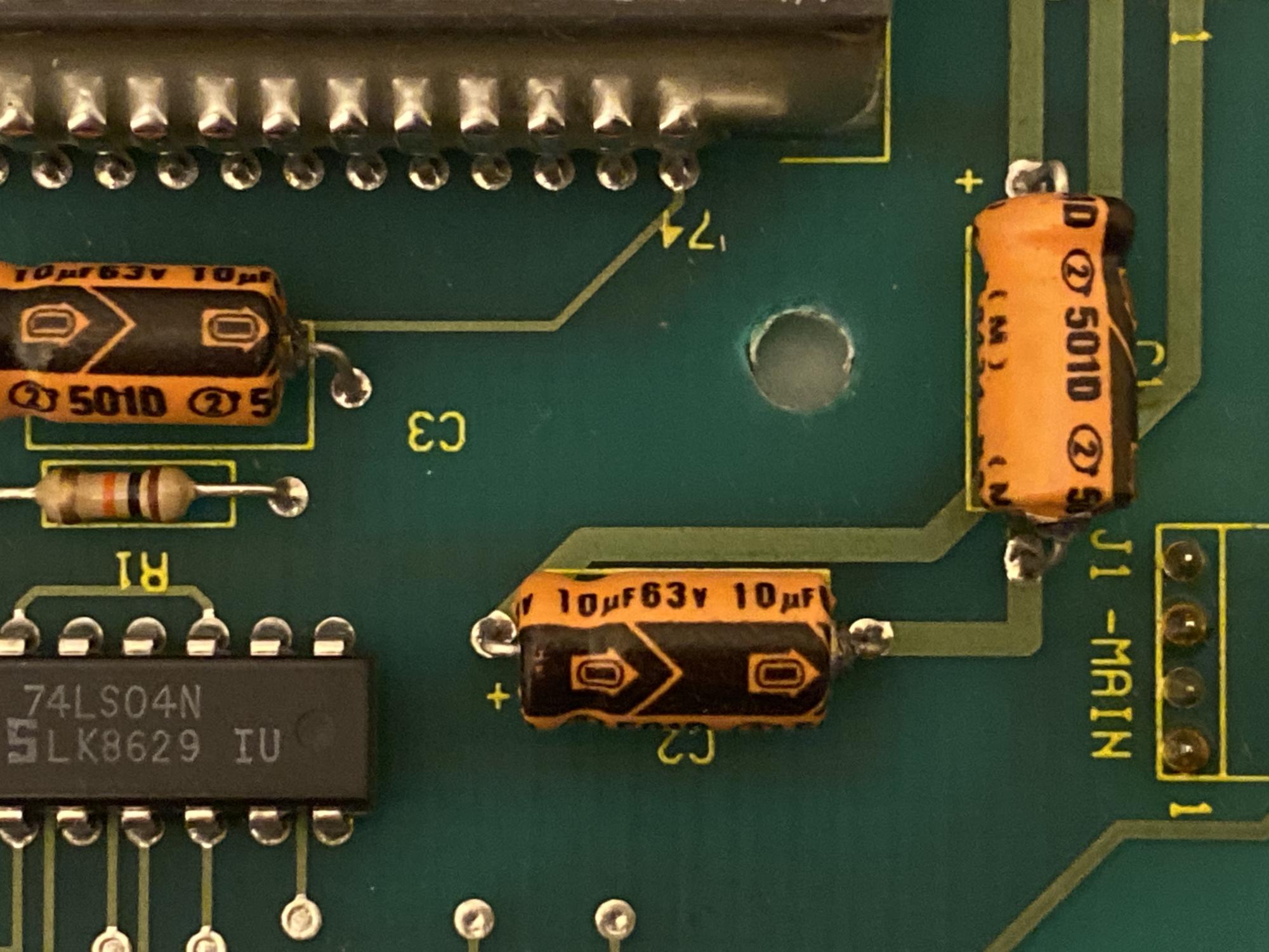

                    Any recommended replacement suggestions for this:
                    Sprague 501D106M063LL
                    10uf 63V aluminium axial electrolytic - is there anything particularly special about it being axial, could I just flat mount a standard equivalent radial?
                    Actually quite interested where this brand considered to be any good?
                    I found some for sale and they seem to be selling for a ludicrous sum of money!
                    Thanks,
                    FS
                      • 31170
                      when in doubt - panasonic FR series.
                      axial vs radial - no difference performance wise.
                      • PeteS in CA
                        • Aug 2005
                        • 3581
                        Axial caps usually are general purpose, nothing special about them, possibly excepting some that may be 105C. So, assuming such things are available, a 105C axial part that fits should be fine. If axial parts are not available then kludging is a general purpose 105C radial part should be OK (whatever series from a good brand with a good price).
                          how do u fit the legs of the radial cap through the holes meant for axial caps tho? there seems to be clearance issues and the lead spacing makes it awkward to fit one there.
                            • 31170
                            i like to bend one leg back along the cap and put a heatshrink sleeve over the cap so it looks like a radial.
                            you may have to extend the wire doing this.
                            • eccerr0r
                              Solder Sloth
                              • Nov 2012
                              • 8701
                              sometimes I wonder, will this be as bad as leaving radial caps not flush to the board...
                              No difference with extra wire length to fake an axial cap this way, right?
                              (I've straddled the two holes with a radial cap before too and bent both wires close to the board surface. Don't think it's any better or anything but yet another way to mount...)
                                • 31170
                                if you extend the ground and keep the + short it's probably fine
                                  It depends on the circuit.
                                  Leaving radial caps "hanging in the air" is not always a bad thing. But again, it just depends on the circuit. For any switch-mode (read: relatively high frequency power switching), it can matter and is not recommended. But for GP stuff where high-frequency is usually not involved, the extra lead length of those axial or radial caps hardly matters. If you look on old boards with axial caps, anything high-frequency or RF that needs filtering is usually done with tantalum, ceramic, film, or a combo of these three. The electrolytics on these old boards are simply there for general "smoothing" (and in rare occasions, timing.)
                                  So using radial caps with long leads in place of axial ones is *usually* OK.
