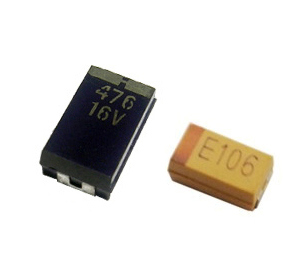

    Dear members

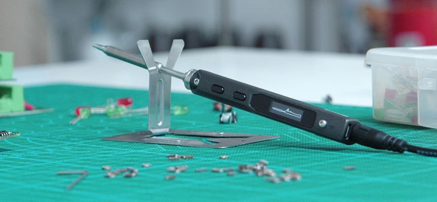

    I have the TS100 soldering iron, not a tweezer type and some tantalum capacitors that I need to remove.
    Considering the tools I have, desoldering braid, flux and the iron but are there safety concerns to account for? Namely the tantalums blowing up? I will use glasses but I wanted to know if this is legitimate concern or an event that happens with very little frequency.
    Kind regards
    —Alex
    • 30997
    Re: Tantalum Capacitor desoldering- safety concerns
    they dont blow up, they are just a lump of tantalum in a plastic box.
    removing them with an iron wont be easy though, the contact wraps under the cap body.
    • R_J
      • Jun 2012
      • 9535
      You will be fine, the capacitor will not blow up. A tantalum cap can blow if it becomes shorted when voltage is applied to it, it wont blow while soldering or desoldering
      Use extra flux if you can, that will help the old solder flow when heated, and be careful to not put too much force if you are lifting it so you don't lift the trace with it.
