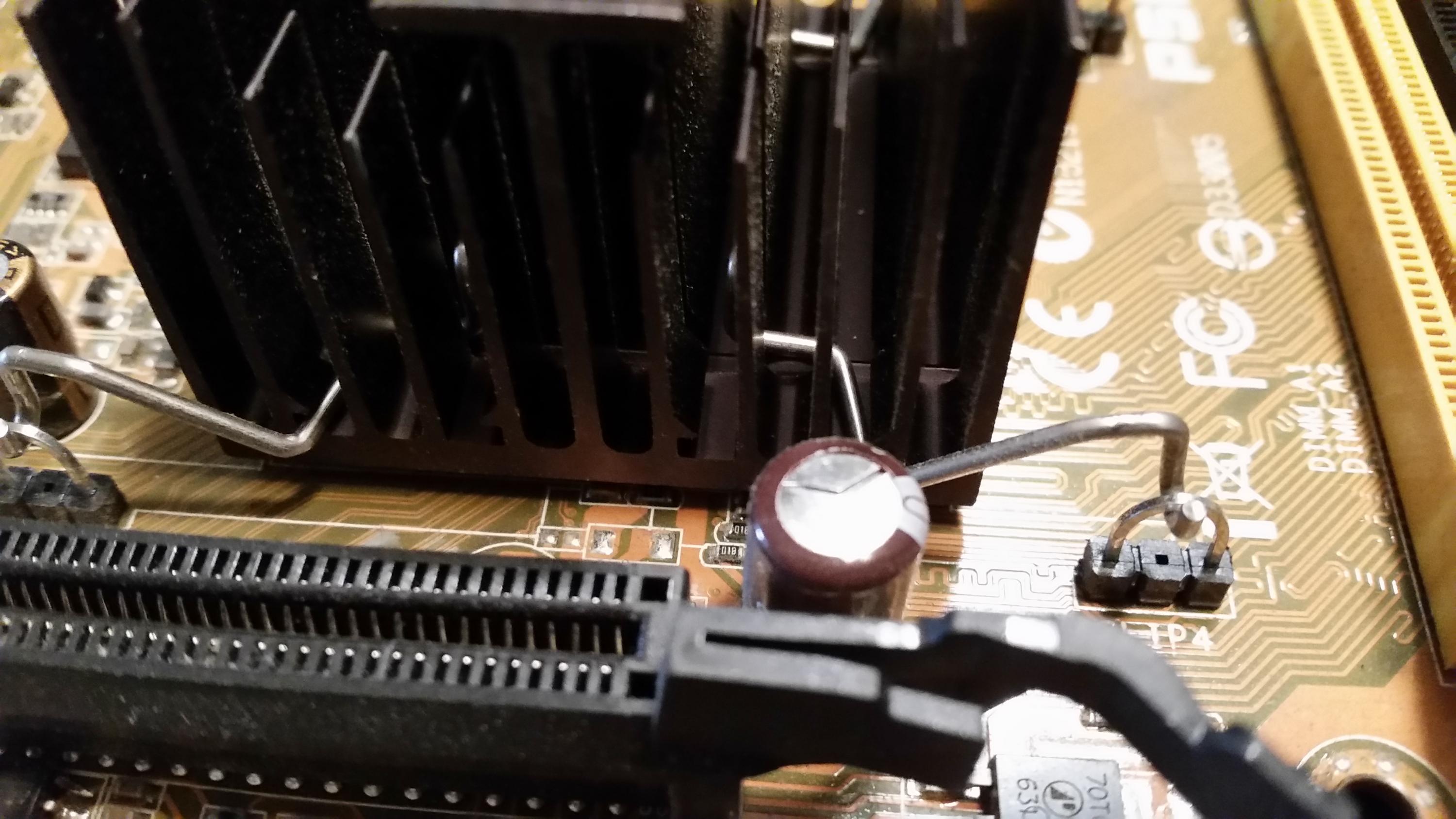

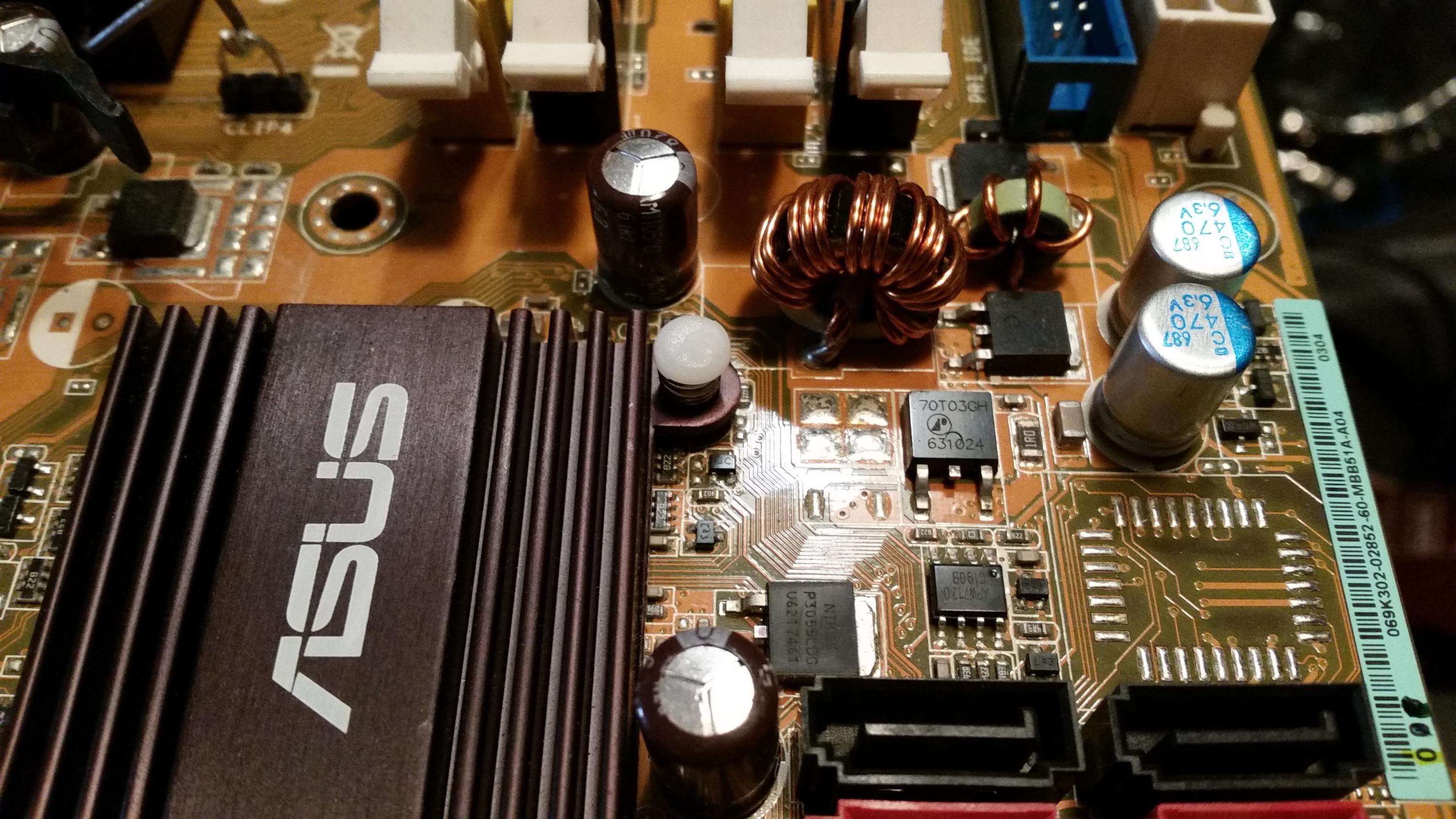

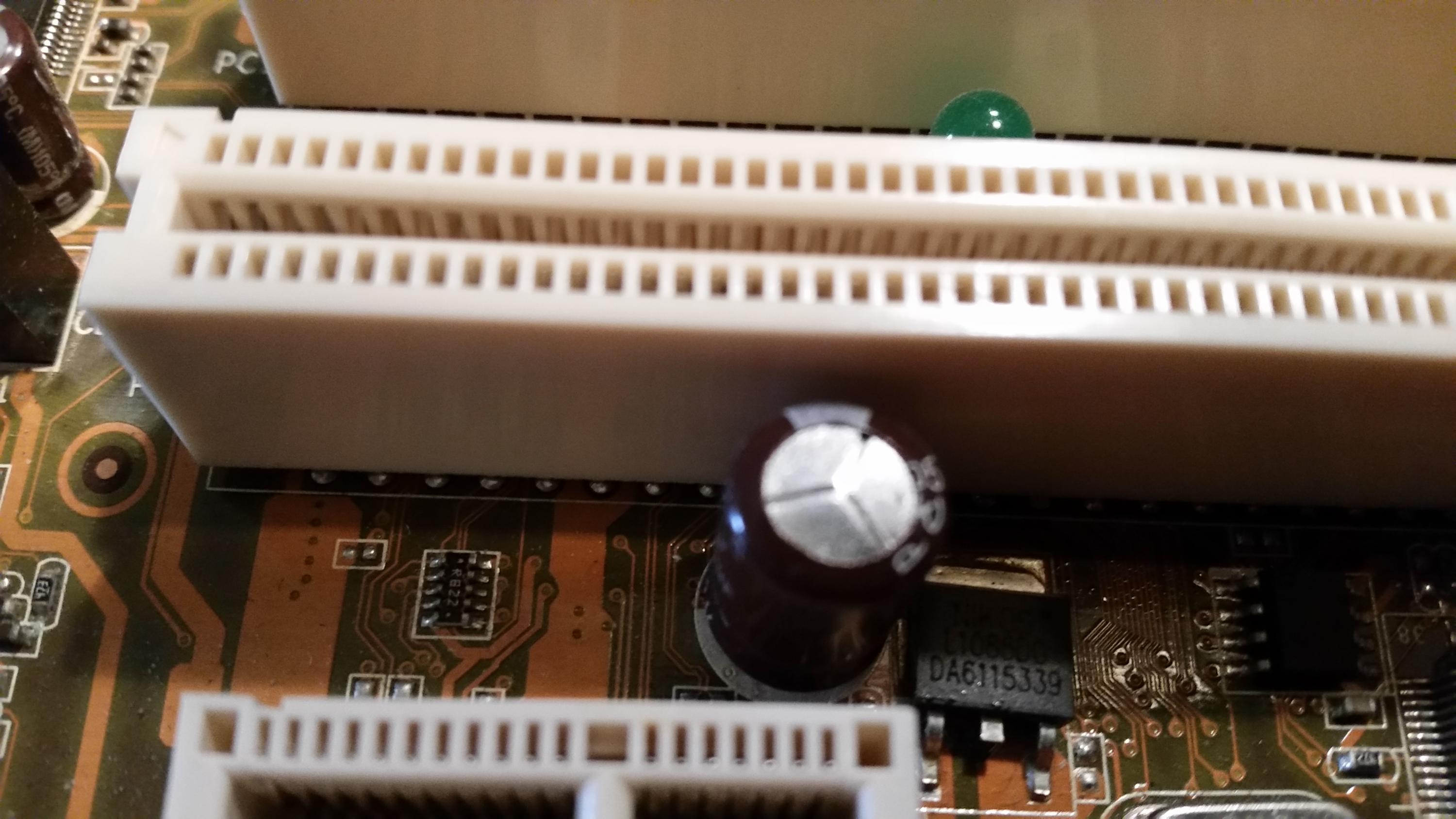

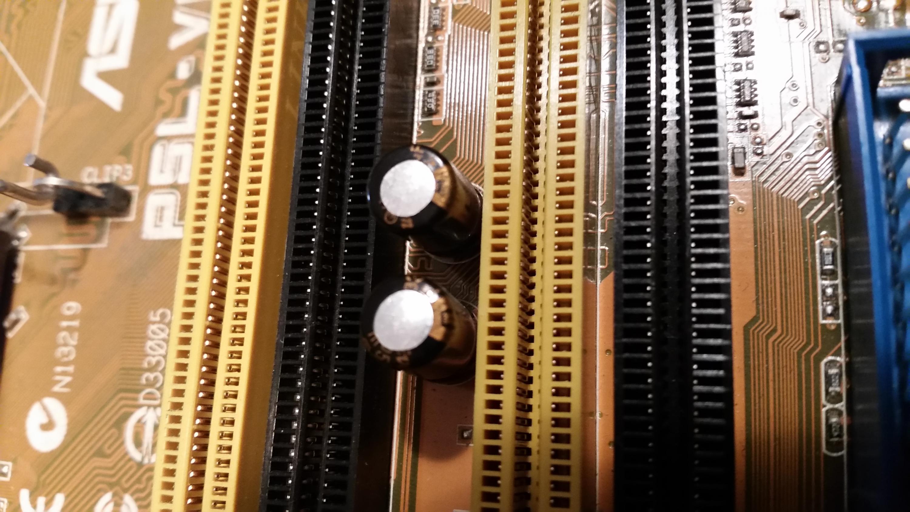

    Hi this is my first real post here, anyway I bought a ASUS LGA 775 MOBD for a build i want to do and it looks like i have a few bad caps
    I attached several pictures of said caps, the last pic is of caps between the ram slots and they are very slightly bulged, pls let me know if you thing i should get them two in the mean time im gong to focuses on the other 4 larger caps and as soon as i get them off i will get the info on what they are exactly.
    Have started trying to desolderer with my 40watt iron and solder wick and im not getting very far, is my iron to dam small to heat up the caps?

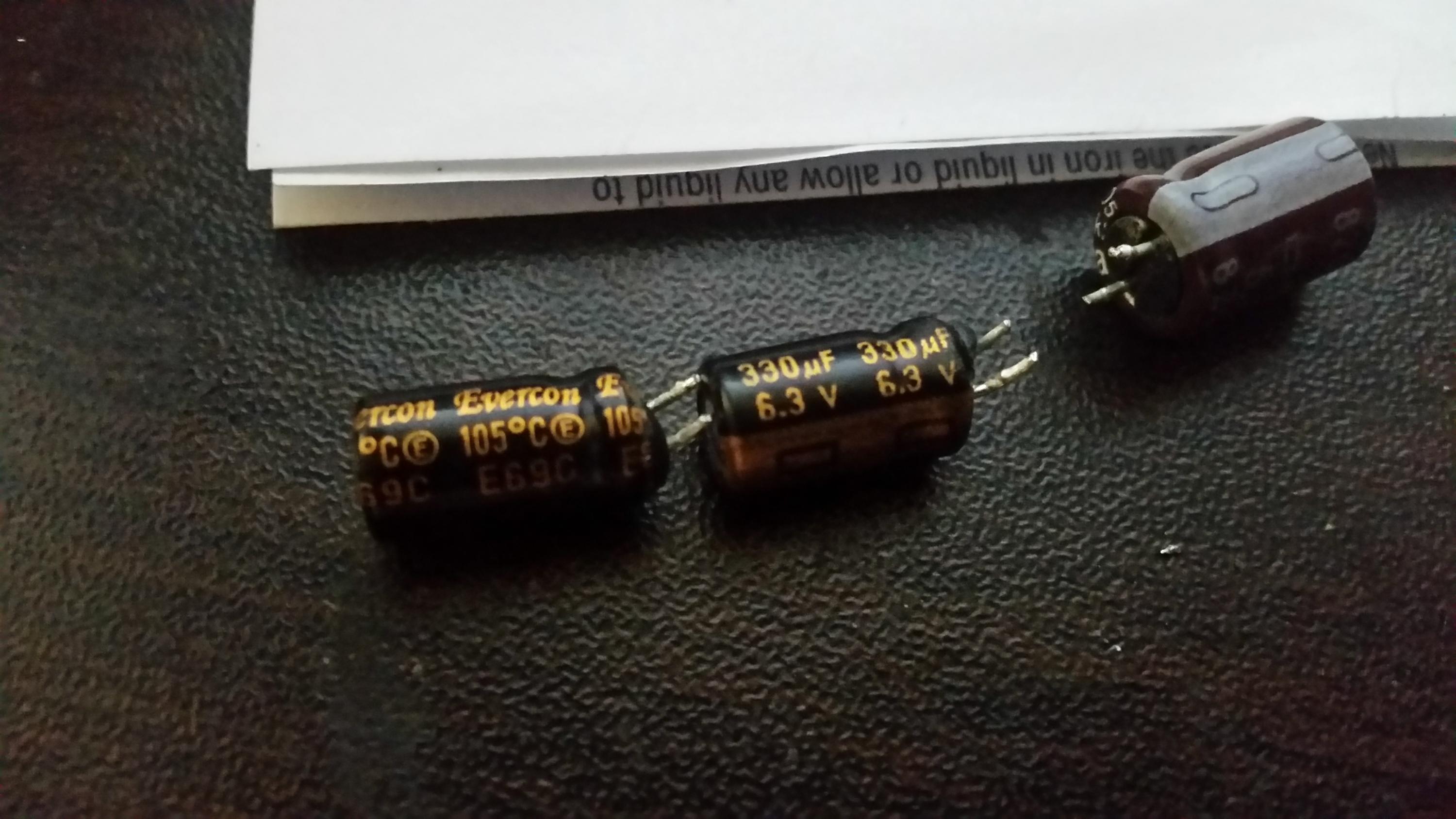

    ok i pulled out all 6 caps this is what i have
    2x Evercon E96C 105oC 6.3v 330uF
    4X no name (cant find one) KZG 6(K) 6d 105oC 6.3v 820uF

          EDIT: I uploaded pic's of the Evercon caps

            The Evercon caps might just be ordinary General Purpose caps, but I'm not sure.

              Isn't it said somewhere on this site that black GSC aka Evercon caps without series marking are their LE series?
              Edit: Found the reference here. PCBONEZ used to know his capacitors.
