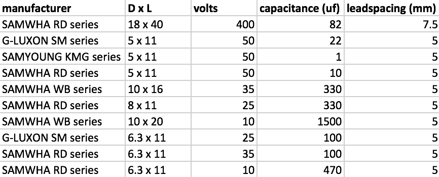

    Can anyone help me find suitable replacements for these 10 caps?

    Re: capacitor replacements
    1: Panasonic EEU-EE2G820 The ripple current @ 120hz is a little better
    2: Panasonic ECA-1HM220B Slightly better ripple
    3: Can't find one that fits 105c, 2000hrs and size
    4: Nichicon UKL1H100KDDANA low leakage is all I could find
    5: Panasonic EEU-FM1V331LB slight better ohm/ripple
    6: Cornell Dubilier SH331M025ST-ND (could only find 10mm, can someone find something better?)
    7: Panasonic EEU-FM1A152L (better ers/ripple)
    8: Cornell Dubilier SEK101M025AT (someone find something better?)
    9: Wurth Electronics 860020573008 (all I could find for 6.3x11)
    10: Nichicon UPS1A471MPD1TD (8mm, not 6.3, all I could find)
