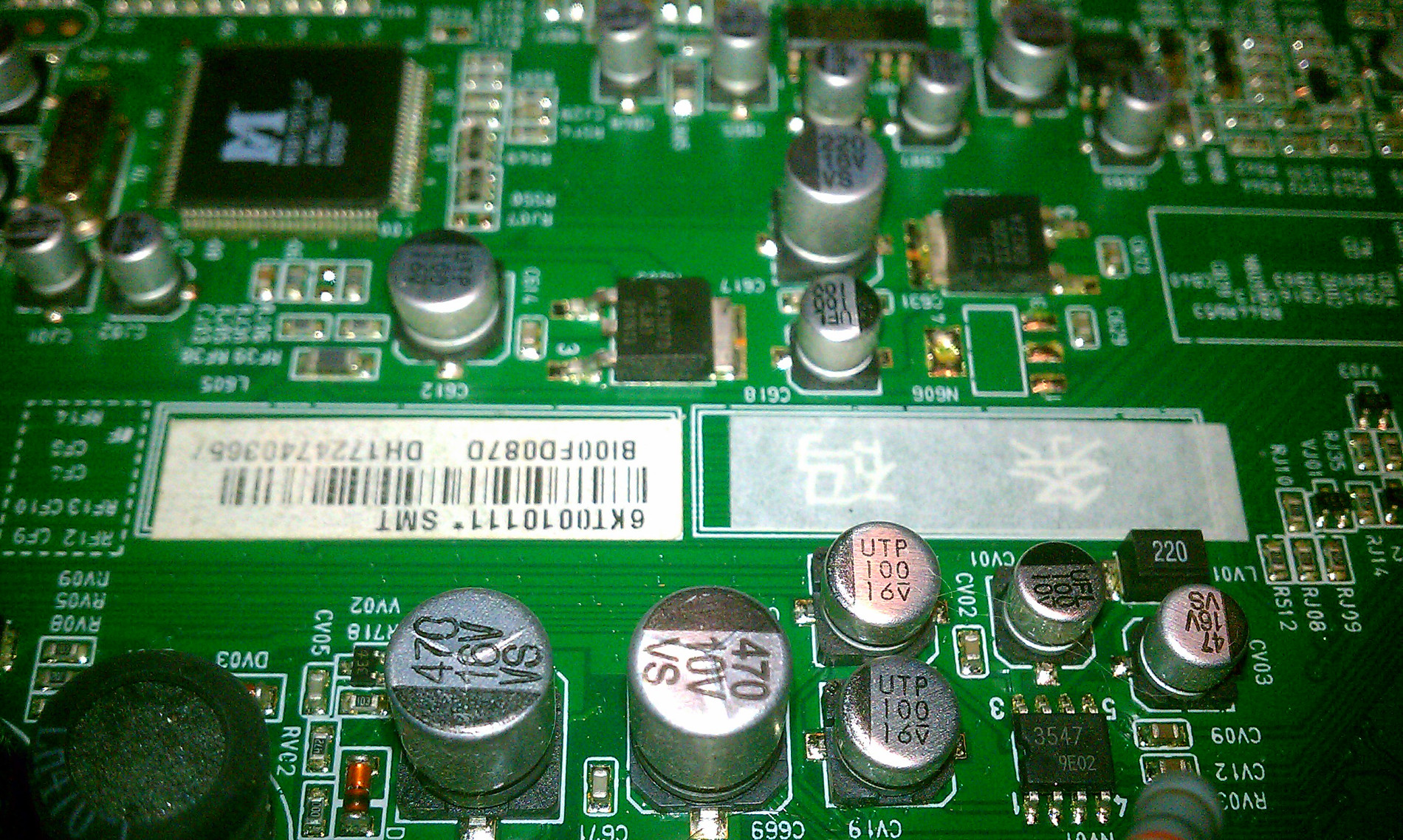

                  I have a few Aluminum Electrolytic Caps, 'VS' is stamped on them. Anyone know where to find them? It's out of a Dynex LCD TV, on it's video mainboard.

                  I've looked everywhere but can't find the VS Series aluminum Electrolytic Capacitor Data Sheet or where to buy them.. Anyone know where to look?

                    Re: Trying identify Capacitor manufacturer
                    The 470uF 10v and 16v could be Chang VS series (datasheet in link).
                    The ones marked UTP.. I'm puzzled as well.
                      Thanks for the Reference! -Jah Love!
