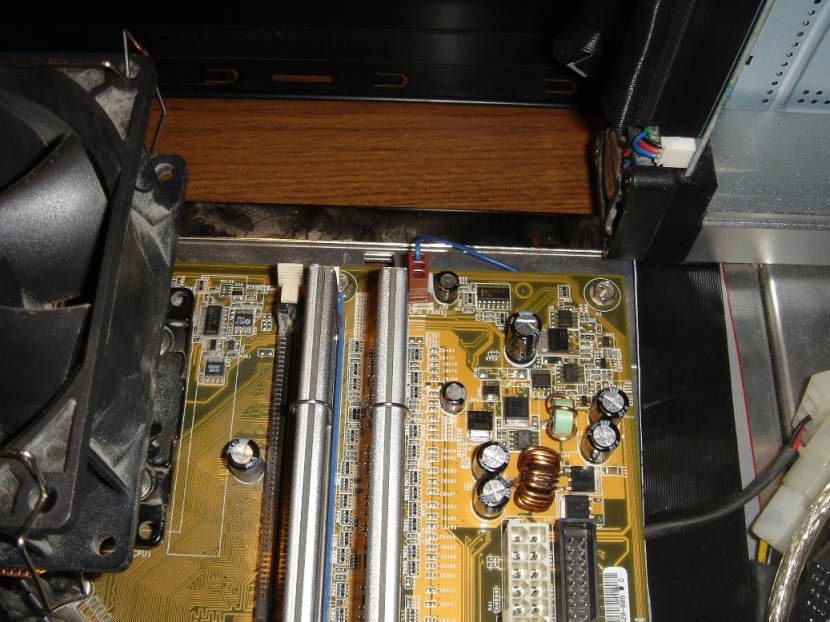

    i found one capasitor missing from my old A7N8X-E, anyone knows what it is, so that i could replase it.
    Pic --> http://www.fotopankki.fi/squaref/kuva/6364551940972164
    thanks!

    Re: Cap missing in Asus A7N8X-E
    I don't actually own this actual board. I know that this was a popular board that is quite good, I am sure that other posters have this particular board.
    Judging from the location of the cap and the physical size. I would guess it's a 470uF 6.3V or 10V capacitor. However this is just a guess from the picture that you linked!!
    Hopefully someone can give you a more definitive answer.
      It should be OST 1000uf 6,3v. I replaced it with Sanyo 1000uf 10v.
      It seems that allmost all "random" caps are OST 1000uf 6,3v on this board.
        broken http://www.fotopankki.fi/squaref/kuva/6393754964199681
        fixed with hotglue http://www.fotopankki.fi/squaref/kuva/6393914727193764
              yeah.. not. i own solderer. but that welding is kinda ugly and i didnt want to make it too difficult. just soldered new cap to remaining feet and glued new cap to mb.
              in here its just saying to ude hotglue when you weld or solder some...
