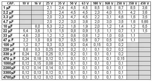

    There is no right table to use.
    The tables you find on the Internet are just approximations, basically they tell you that for a large number of series of capacitors of a certain capacitance range and voltage rating, you should expect ESR value to be less than the amount listed.
    There are older series of capacitors which have ESR much higher than new series of capacitors with same capacitance and voltage rating, so you can't go just by the number in the table.
    For example, an older Nichicon PM series 33uF 35v should have an ESR of 0.49 ohm or lower while a newer Panasonic FM 33uF 35v should have an ESR of 0.3 ohm or less... which is pretty big difference, but both are good values.
    If your table says expect 0.5 ohm or less and your Nichicon PM capacitor shows 0.55-0.6 ohm on the esr meter, technically I would still consider it good enough (because it's probably quite old and as they age capacitors degrade a bit)
    On the other hand, if I use this chart below and test a Nichicon PM capacitor and it shows 1 ohm, it would be bad because I expected around 0.5 ohm and I got twice that. Yet the table says anything below 1.2 ohm is fine, which obviously isn't - 1.2 ohm may be fine for some older general purpose capacitors but not for newer series :
    The best thing to do would be to search for the capacitor series you test, download the datasheet and compare your readings with the values in the datasheet.
    Once you do a bunch of measurements you sort of get an idea of what capacitors would measure and you won't need tables anymore.
