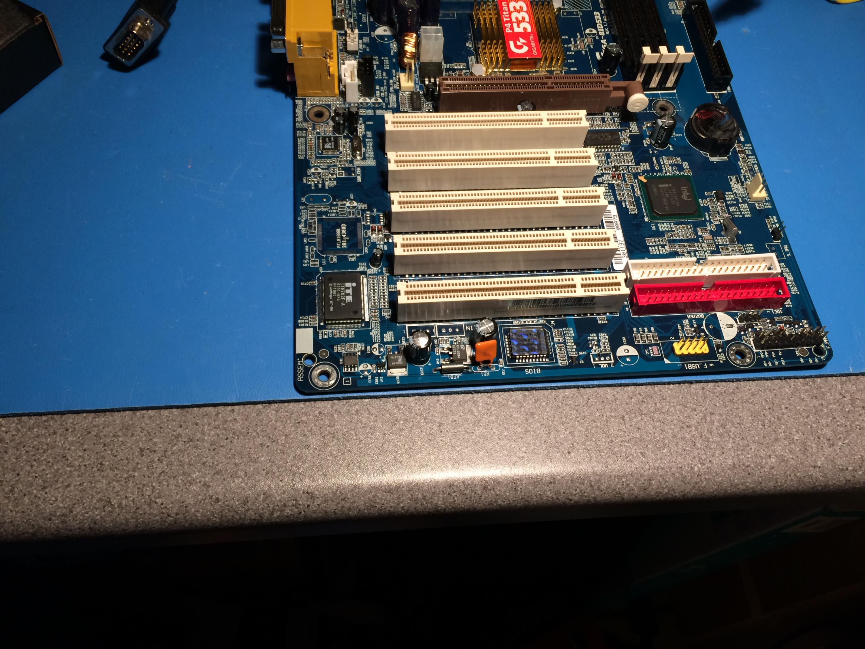

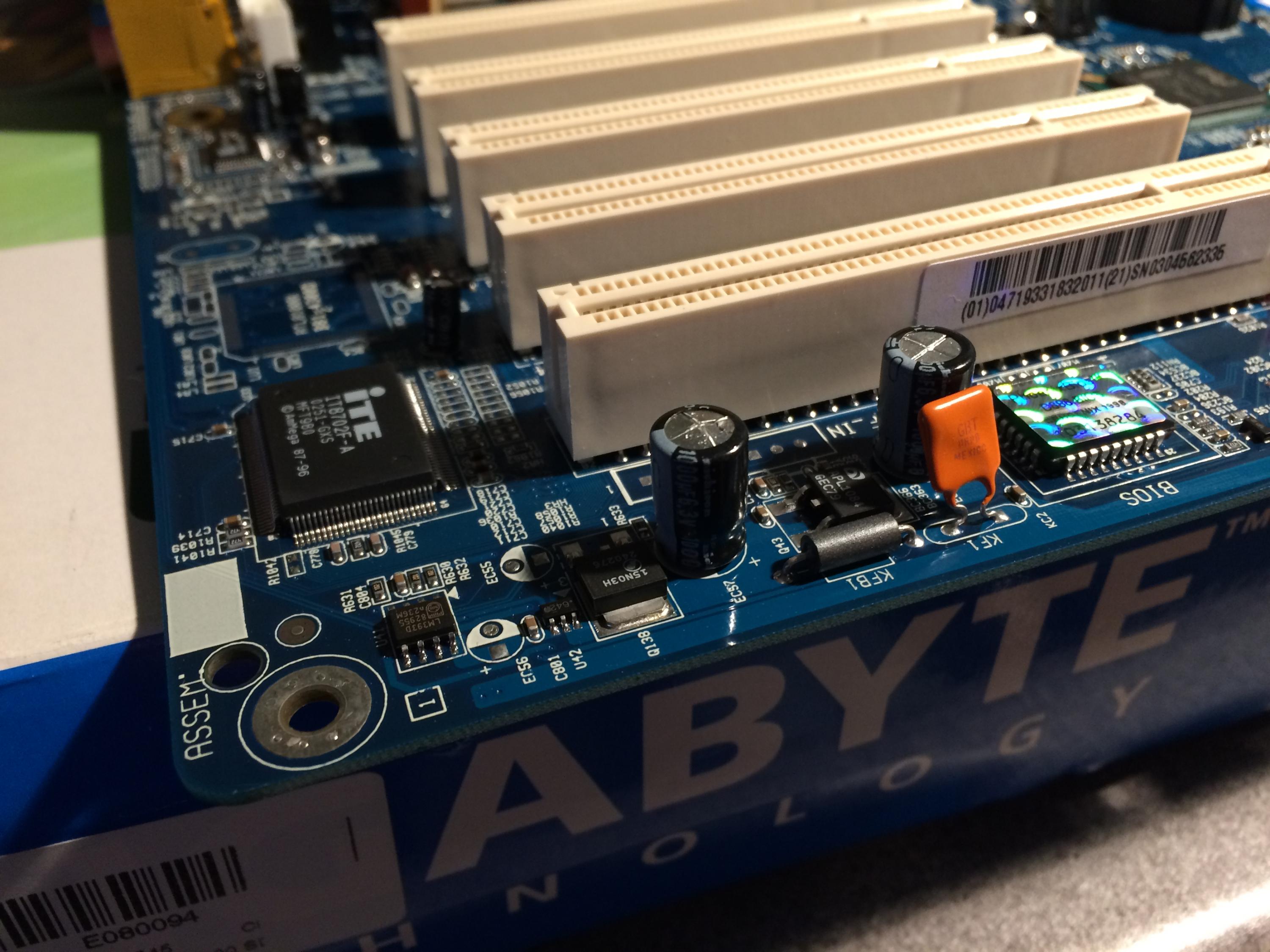

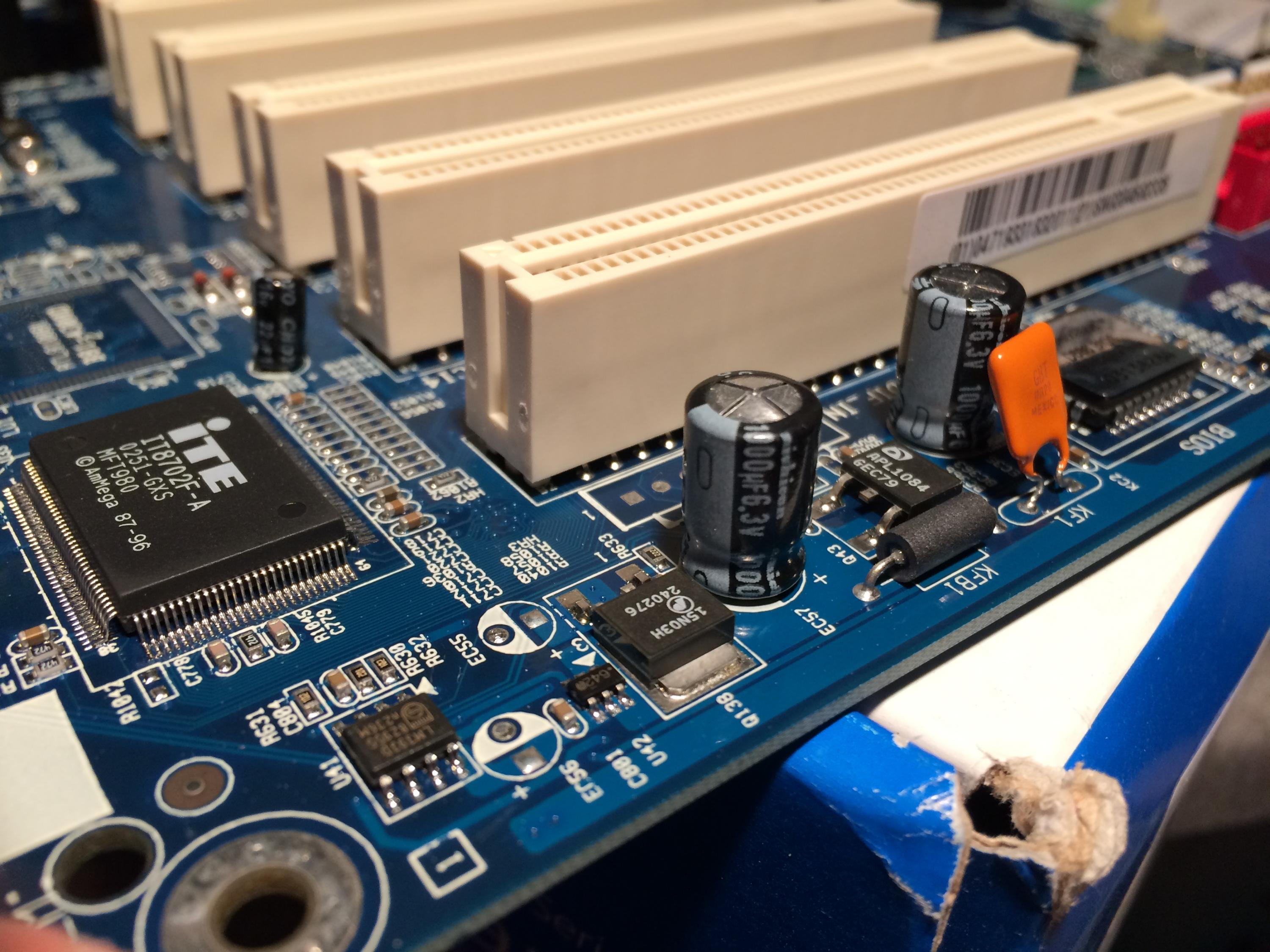

    hello,
    I just wanted to ask if anyone has had any experience with this motherboard (gigabyte GA-8ID533) and if anyone has had dodgy caps on it.
    I recently purchased a brand new (open box, anti static bag still sealed) GA-8ID533 mobo and one of the caps vented about 5 seconds after it posted.
    The mobo did not shut itself off, and DID post again (used a different PSU) after the venting (which I probably shouldn't have done).
    The cap in question is a Nichicon 1000uF 6.3v 8mm x 13mm cap located below the 5th PCI slot (hopefully shown in the picture if it uploads right) with "EC57" printed on the PCB next to it.
    From what I have read, I understand that Nichicons are high quality caps, so this has me confused a little bit.
    My questions are:
    1. Does anyone know what this cap is for?
    2. What could have caused it?
    3. Could it have been caused by the PSU I used? PSU was a CWT PUFP305P.
    Any info I have missed, please let me know.

    what else is writen on the cap?
    i see "HN" ??

      It's HM(M).
      Also says A0301.
      Cant believe I missed those.

              That's a Socket 478 board. A0301 means it was manufactured during the 1st week of 2003 (January) in Asahi, Japan. Nichicon had a large, bad batch of ultra low impedance capacitors (HM and HN series) from 2001-2005. They make good caps otherwise. I'm not surprised they would fail upon POST, after all those years of sitting in a sealed bag. It sounds like the electrolyte had attacked the aluminum oxide layer as it continually thinned in storage (when the electrolyte broke down, it could not repair the oxide film), so when bias was finally applied to the plates, BANG! Even the circuit voltage proved too much for those defective caps. That particular cap appears to be on the output of a linear regulator but tracing the underside may reveal otherwise. (M) is the capacitance tolerance (-+20%), not part of the series name.

                yes what he said. this is why i avoid gigabyte boards during the p4 and athlon xp and 64 eras. i saw a lot of gigabyte boards from that time period use nichicon hms. if u get one of those, it usually means a time consuming full recap of the board due to the faulty batch in the 2001-2005 time period when p4s and athlon xp/64s were being made.
                suitable replacements for your recapping exercise would be rubycon mbz, sanyo wg and panasonic fj.

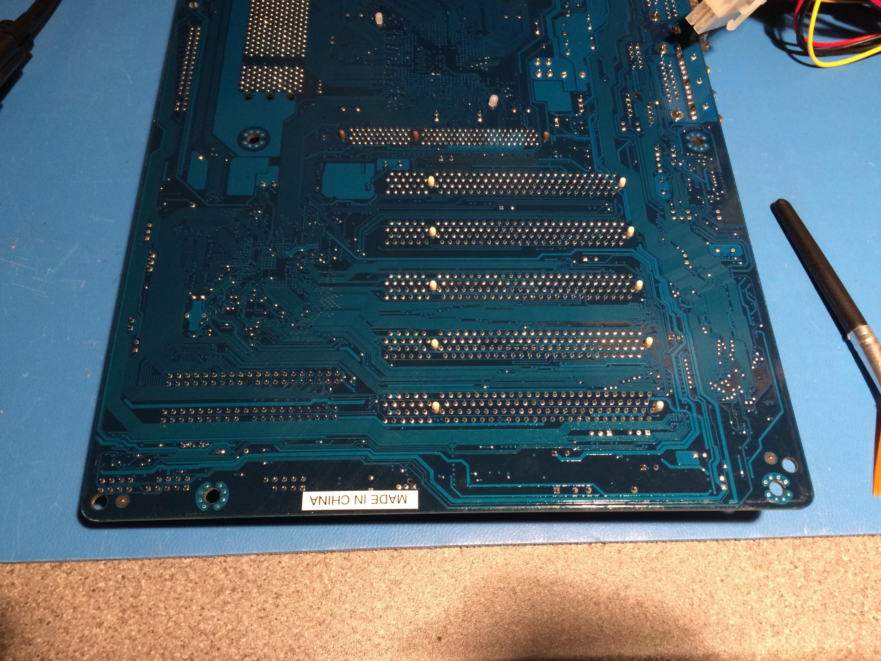

                  Got a pic of the underside in case that helps (top side pic for reference):
                  I presume that the chances of this being caused by my CWT featherweight PSU are slim?
                  And I bet you knew this question was coming: what should I replace it with and would it be a good idea to replace all the caps of the same type (total of 6)?
                  I know that I need a 1000uf 6.3v, would something like a Panasonic FC series or a Nichicon FW be suitable?
                  All the ebay listings for them say "for audio" or some such nonsense, I presume this is just a marketing term to get more hits?
                  And I suppose I should ask about the other caps on the mobo, which are 4x Rubycon MBZ 1500uF 6.3v T0245, 2x Rubycon MBZ 3300uF 6.3v T0242, 3x Rubycon MBZ 1500uF 16v T0241, 4x CHOYO MR 22uF 16v 11YJ and 6x TEAPO SS A3 100uF 10v.
                  Any of those out of a bad batch?
