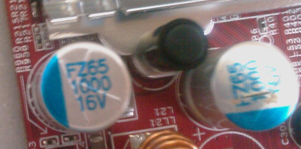

    Please help identify bad cap on ATI Radeon X300 SE Video Card
    I had a problem with my graphics card which ended up in the trash. I stumbled on to this site then fished the card out of the trash and noticed the popped cap.
    The problem is that I'm unsure what cap to buy as a replacement. I've attached a photo which shows a silver cap with the following printed on the top:
    FZ65
    1000
    16V
    I'm assuming this is a 1000uF/16V cap, but I'm not sure of the type or whether FZ65 means anything important.
    Can anyone point me in the right direction?
    Note: Sorry for the blurry pic. The camera on my phone isn't too good.

    Re: Please help identify bad cap on ATI Radeon X300 SE Video Card
    panasonic fm 1000@16 will do fine.
    replace all fz caps as they are known bad.
    those are sacon fz series.junk.

      Thank you for the prompt response. I've found these:
      http://uk.farnell.com/1219463/passiv...equestid=66915
      But they are 20mm in height. As it's a video card, I need one that is equal to or smaller than 16mm in height.
      Do you know of any which would be suitable?

        As I can't seem to find a panasonic FM that is less than 20mm in height. I've found the following:
        http://uk.rs-online.com/web/search/s...duct&R=3654098
        Which is a Panasonic ECA1CHG102, would this be OK?
          The NHG series can work, but I don't think they're low ESR caps that are recommended for use in video cards and motherboards.
