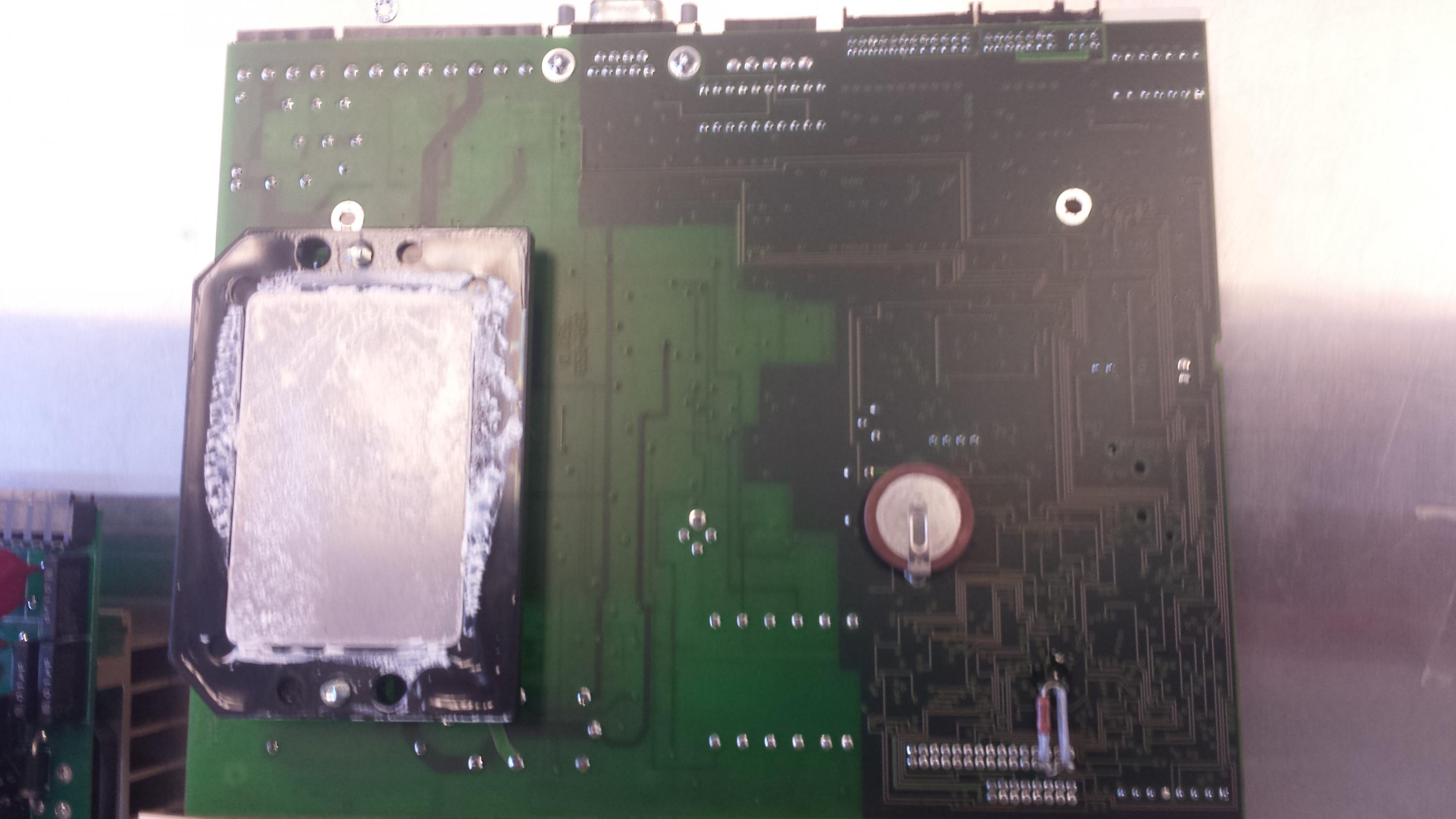

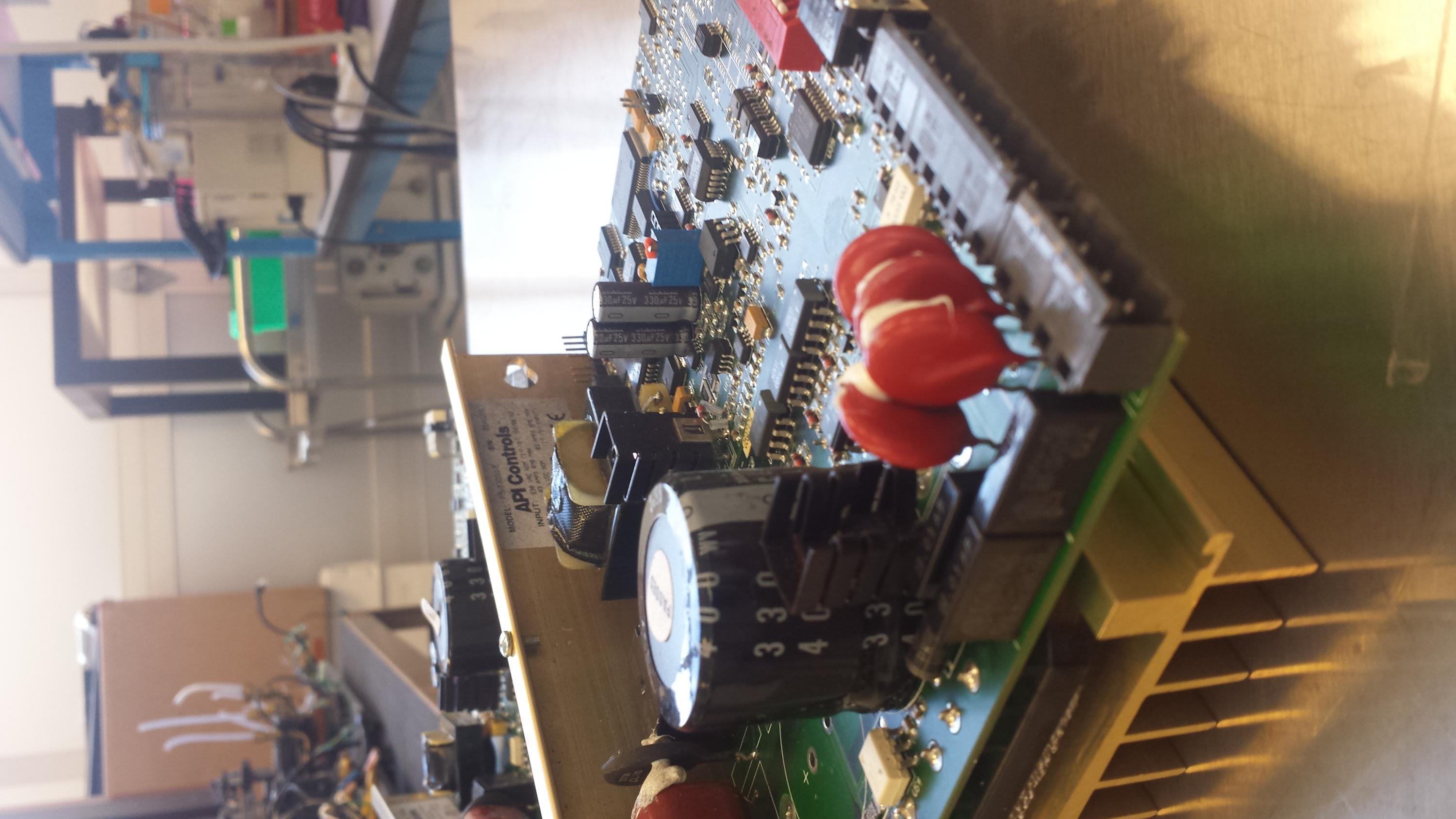

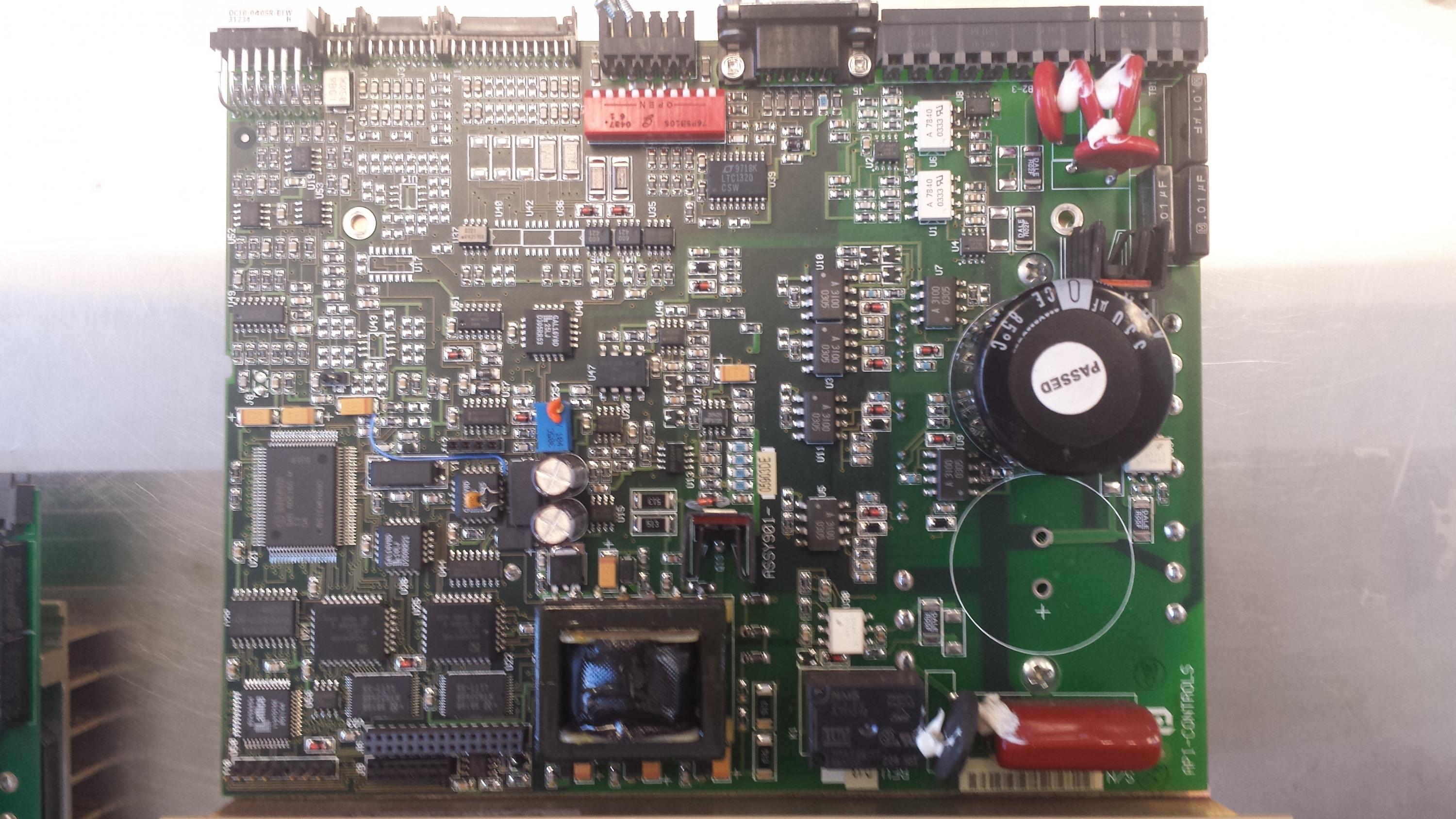

    Having trouble with an API Controls brushless servo drive; drive does not properly control motor, rather, motor just stutters and hums rather than rotating smoothly. Have positively tested the motors against working drives. There look to be only a few caps and some other diodey type things. The tall cylindrical caps are not bulging but might be a little less than perpendicular to the plane of the PCB. No juices or sauce exploding from any of the caps either. Anything look funky to you professionals out there? Many thanks in advance.

    My first guess would be the block (igbt ipm) attached to the heat sync, I can't see the number but it is most likely a bunch of fets and drivers that control the output to the motor. I have not worked on any that small but the ones I repair us a 7mbp150ra-060 which are for larger motors. look up that parts pdf and you should be able to check if the output fets are shorted

        So this is a 3 phase motor. Have you made sure the diode are not blown on one of the phases?
