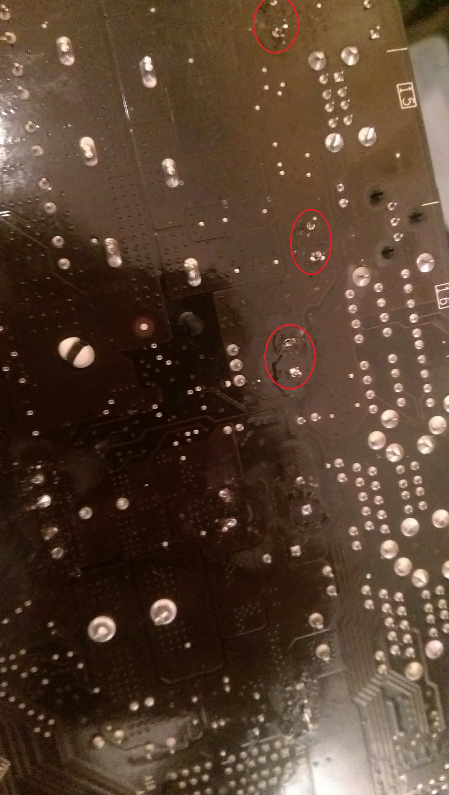

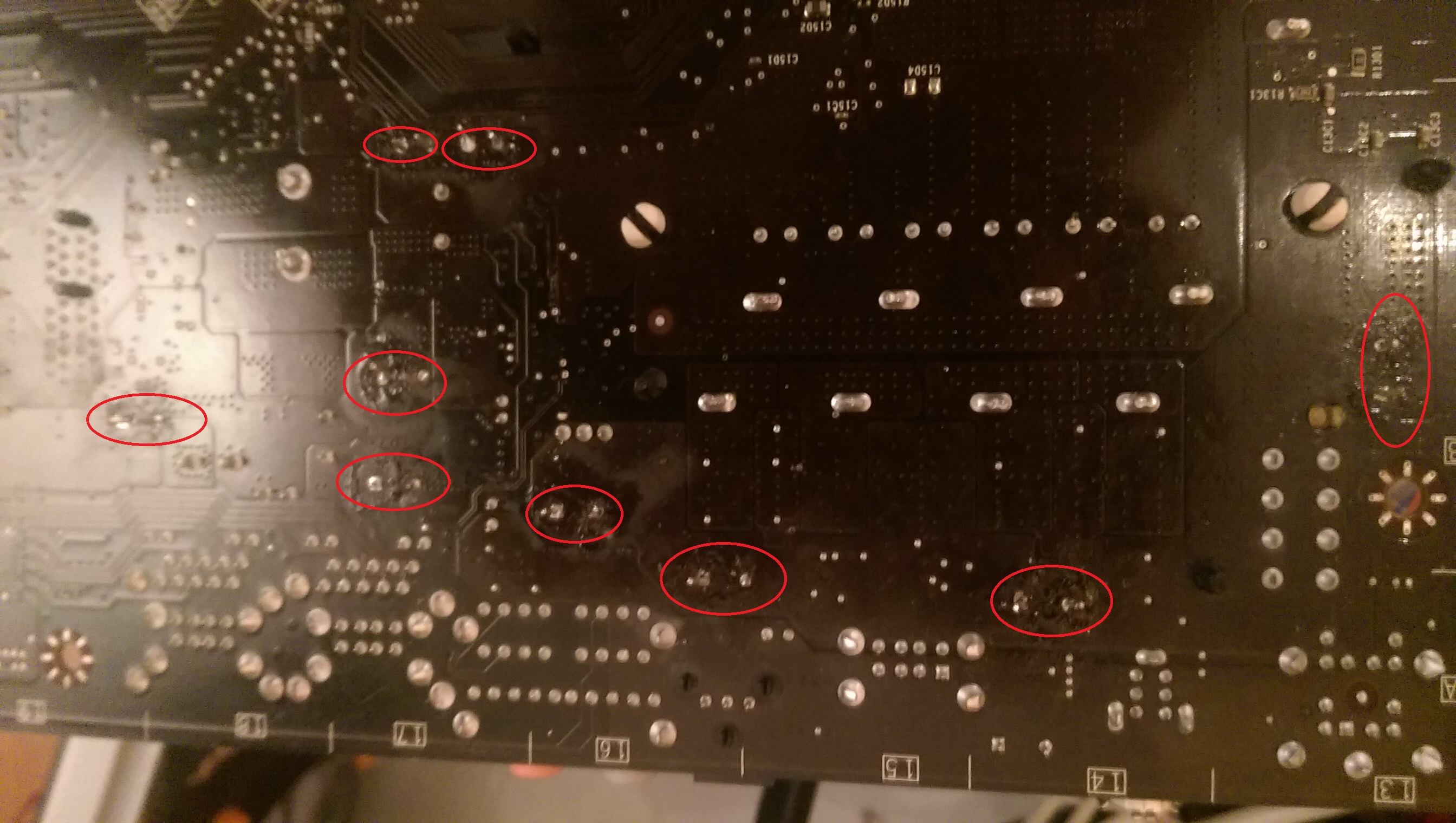

                        So I received the capacitors and replaced them. It wasn't too bad actually, pretty simple to replace. The only issue now is, my computer won't turn on. Most likely I either damaged the board, the parts are not correct, or I didn't actually do a good job with replacing them like I thought I did.
                        Does anyone know how I can test the board alone? When I plug it into power, an LED (SV STBY is what it says next to it) on the board lights up, so maybe I just have a loose connection, but I'd like to test the board if thats possible.

                          #32
                          Re: Do I need to use the same exact model and series or can I use any similar capacit
                          errr did u remember to remove the cmos battery before u recapped the board? if u didnt, try clearing cmos to see if the board starts up after that.

                              #34
                              figuring out and troubleshooting why a motherboard wont start post can be technically challenging and complex. u need at least a multimeter. do u have one? if u also have a post card, that will help as well.
                              u can start by just visually checking if u inserted the caps with the right polarity in the board. also, was the board still able to start post before u recapped the board?

                                #35
                                I can get a multimeter, haven't ever used one, but this has been a fun learning experience. Not sure what you mean by a post card?
                                I know I inserted the caps correctly, at least polarity wise. Regarding it being able to start post,the computer would actually boot all the way into my operating system for about 5 seconds before restarting prior to me recapping it. I took it apart and saw the busted caps, so I figured that was the issue.

                                  #36
                                  a post card is a pci diagnostic device card and inserts into the pci slot and displays various post checkpoint codes as the board boots up. that way u can figure out what is causing the pc to hang and not boot. however, in your case its not necessary as your board wont even power on!
                                  you could also have multiple faulty components. what psu are u using? im inclined to think it may be a bad psu as the system self reboots abruptly and now it wont even power on. also, bad psus are known to make mobo caps fail and go bad! do u have another system to test the psu in to see if it powers on as well?

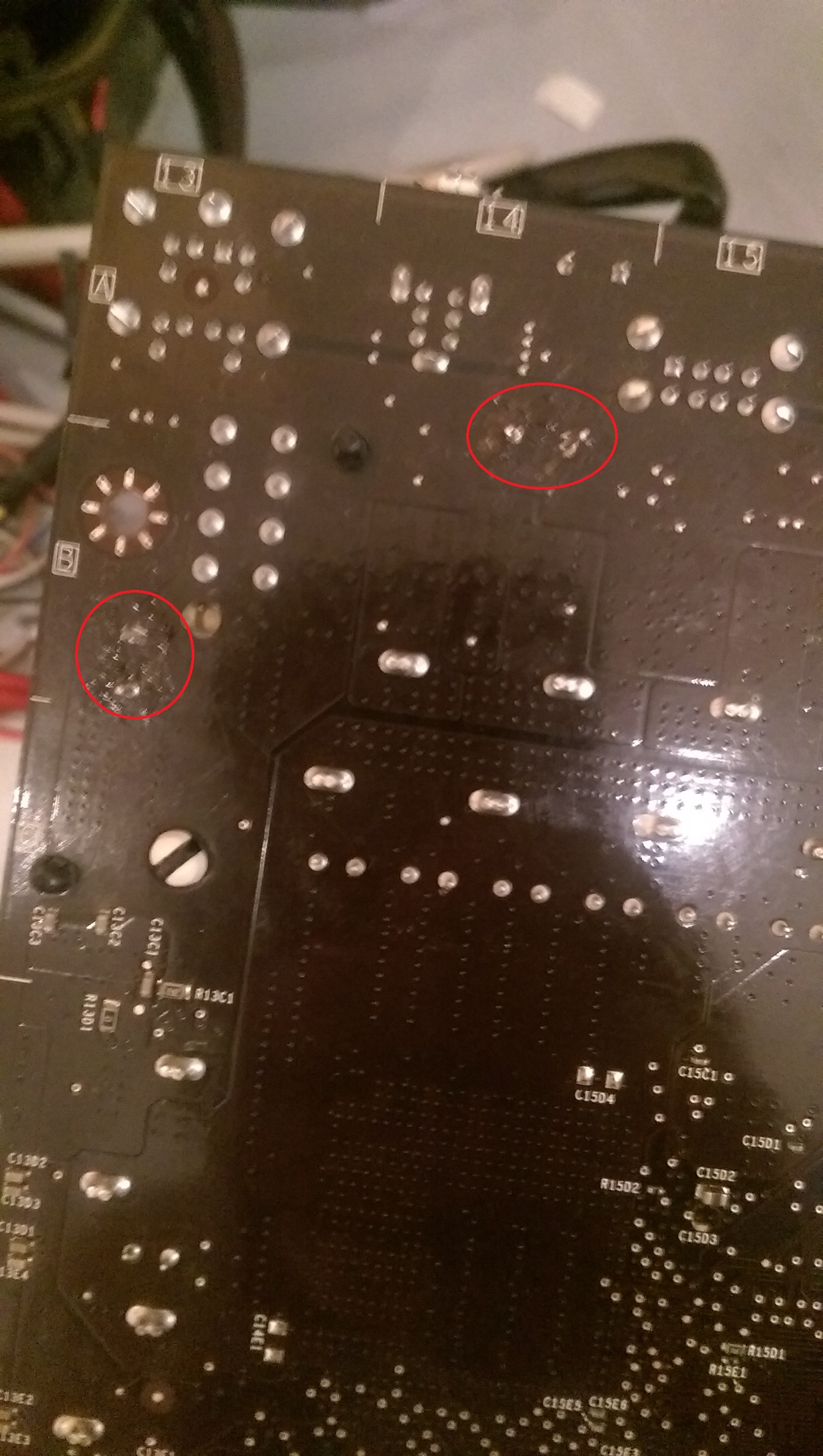

                                    #37
                                    I don't have another system to test the PSU on, at least not a system I'm willing to mess with. Although I doubt it was the PSU because it should still let the motherbard POST as it was before right?

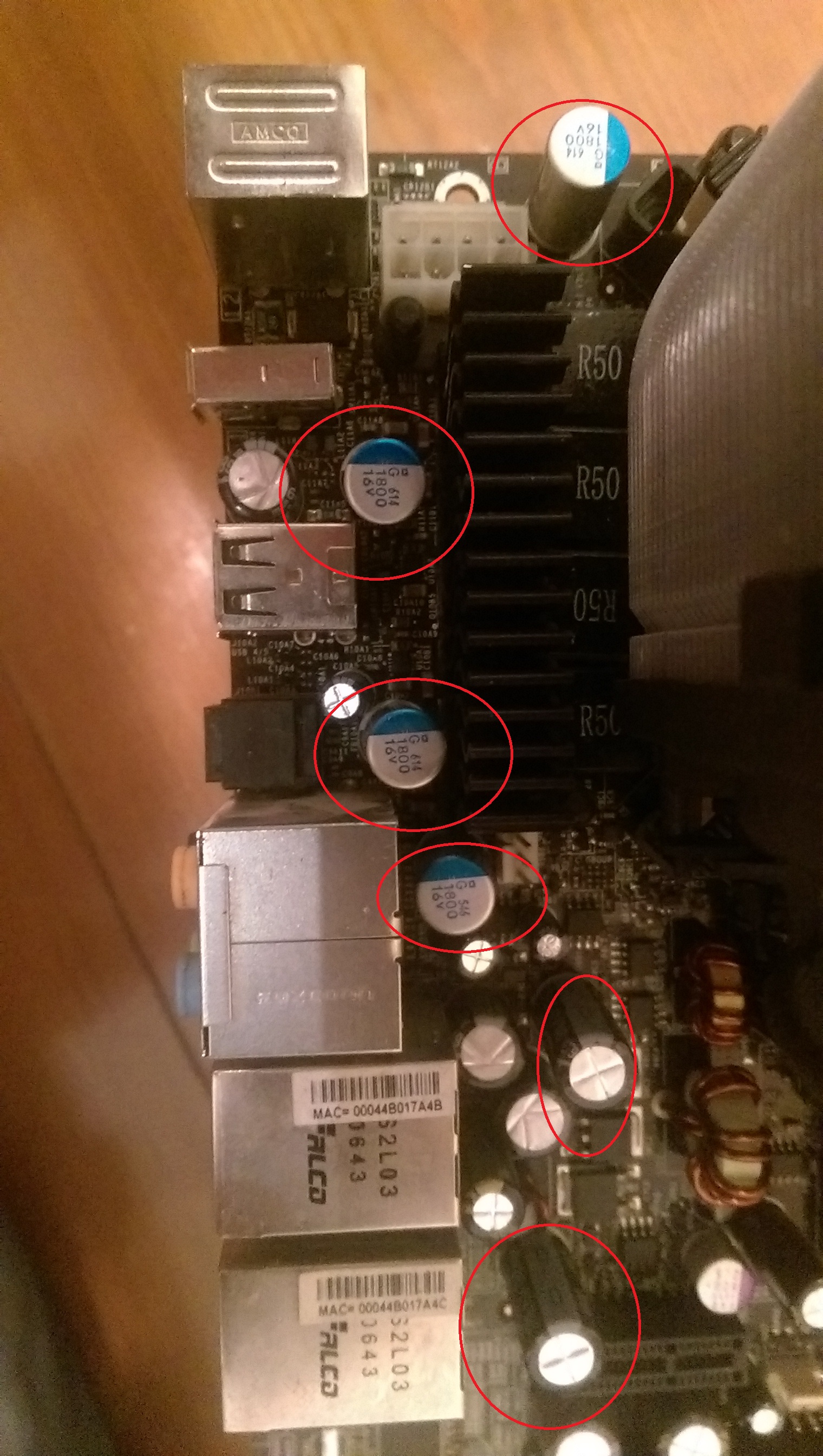

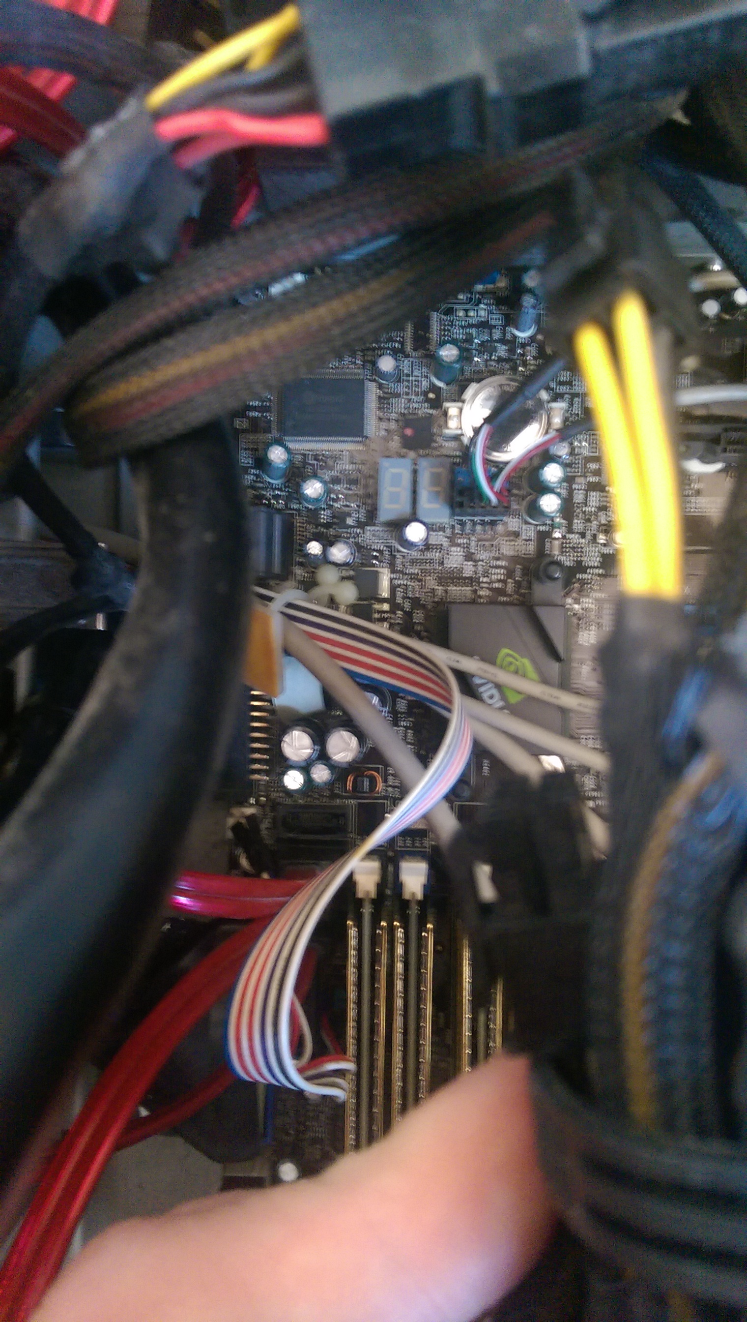

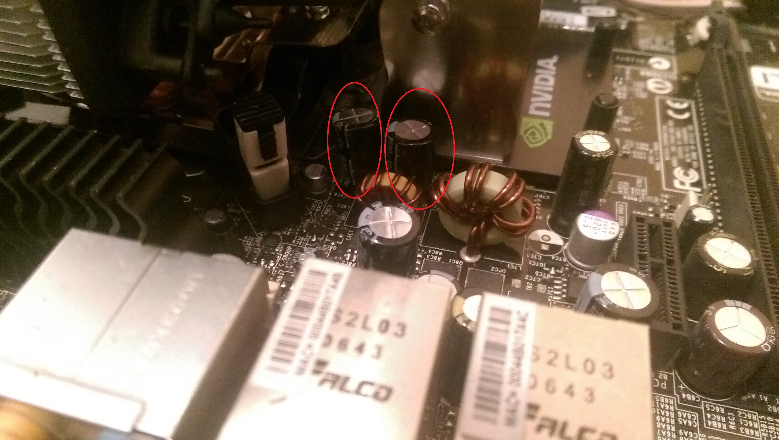

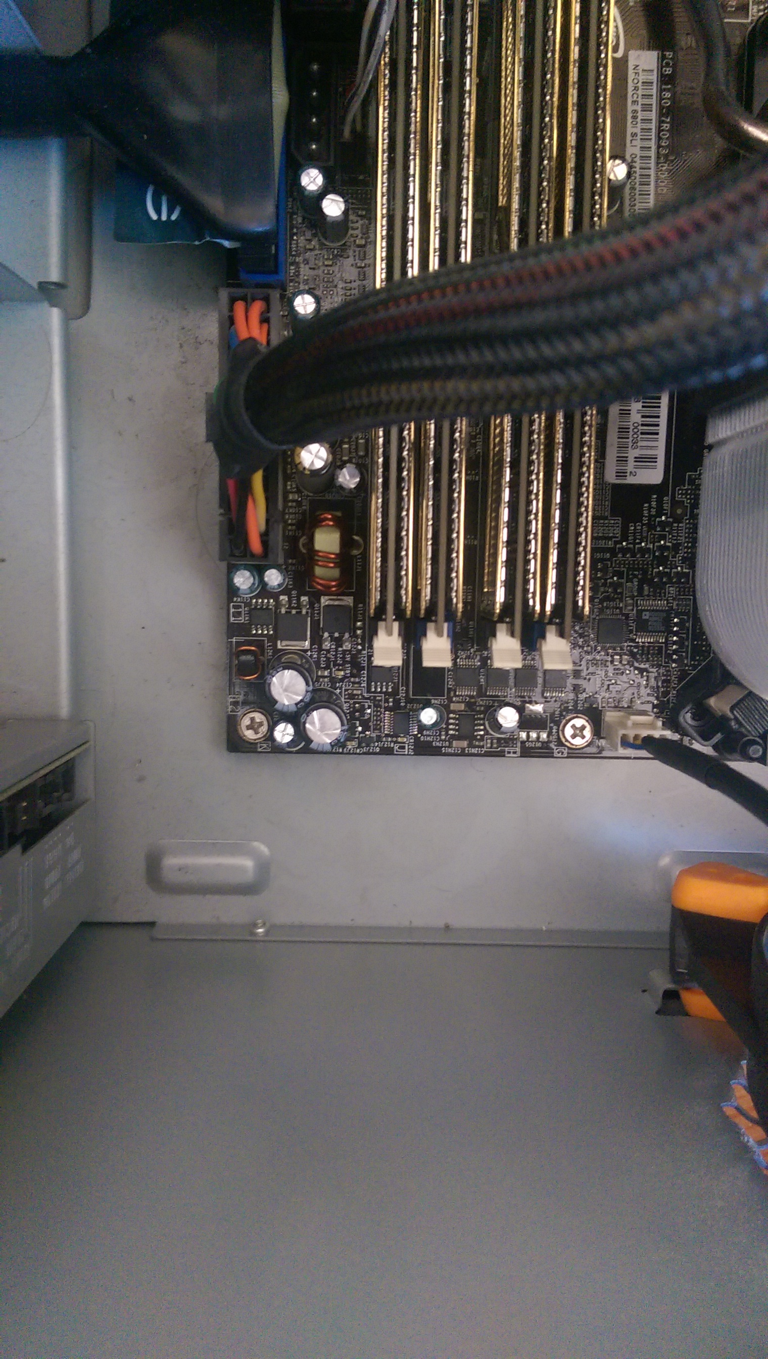

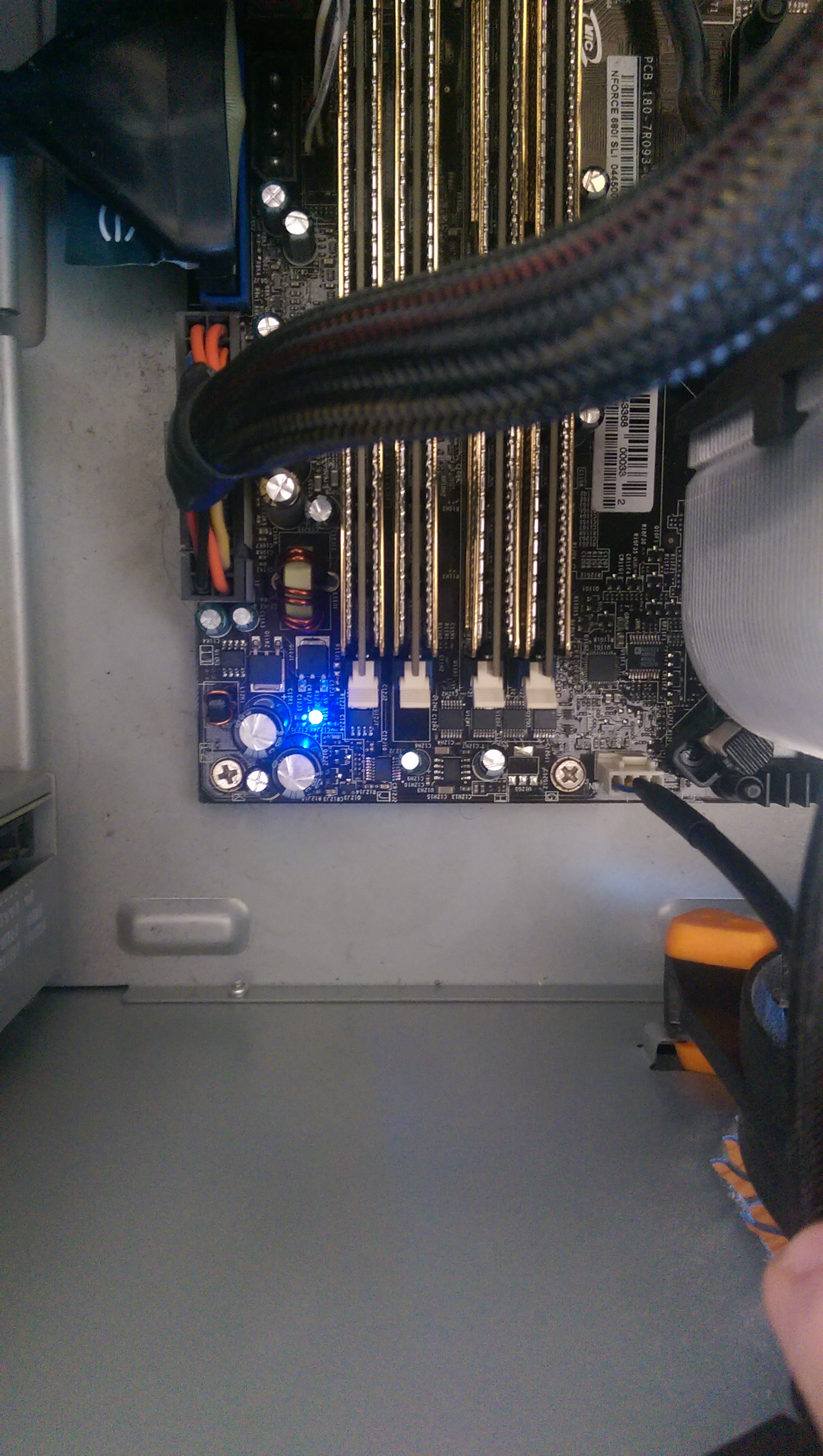

                                    I do want to show you guys the results of my cap replacements (5 pics attached, sorry its really hard to take a picture of the back of the board so that probably won't be very useful), as well as the LED which lights up on the board (2 pics attached, one for on and one for off) when I give it power. The last picture attached is just to show how there is something on the board, not sure what it is, that looks like it should be lighting up as well but is not. I saw it on some pictures of a POST card, so I assume the fact that this is not lighting up is a big deal.

                                      #38
                                      the numerical leds in the other led pic are most likely post diagnostic leds. your board has a post card function built in so u dont need a post card. however, they are only meant to work when the motherboard is powered on and starts the bios boot process.
                                      since, it wont even power on. we have to check first if the psu is working. does the psu fan jerk a bit when u push the power button? also, unplug everything connected to the psu except the fans then try to use a piece of jumper wire and short the green wire on the atx connector to any black wire. this forces the psu to turn on without a board. does the psu fan remain spinning and do the case fans remain spinning? this usually just indicates the main rail side of the psu is not dead.

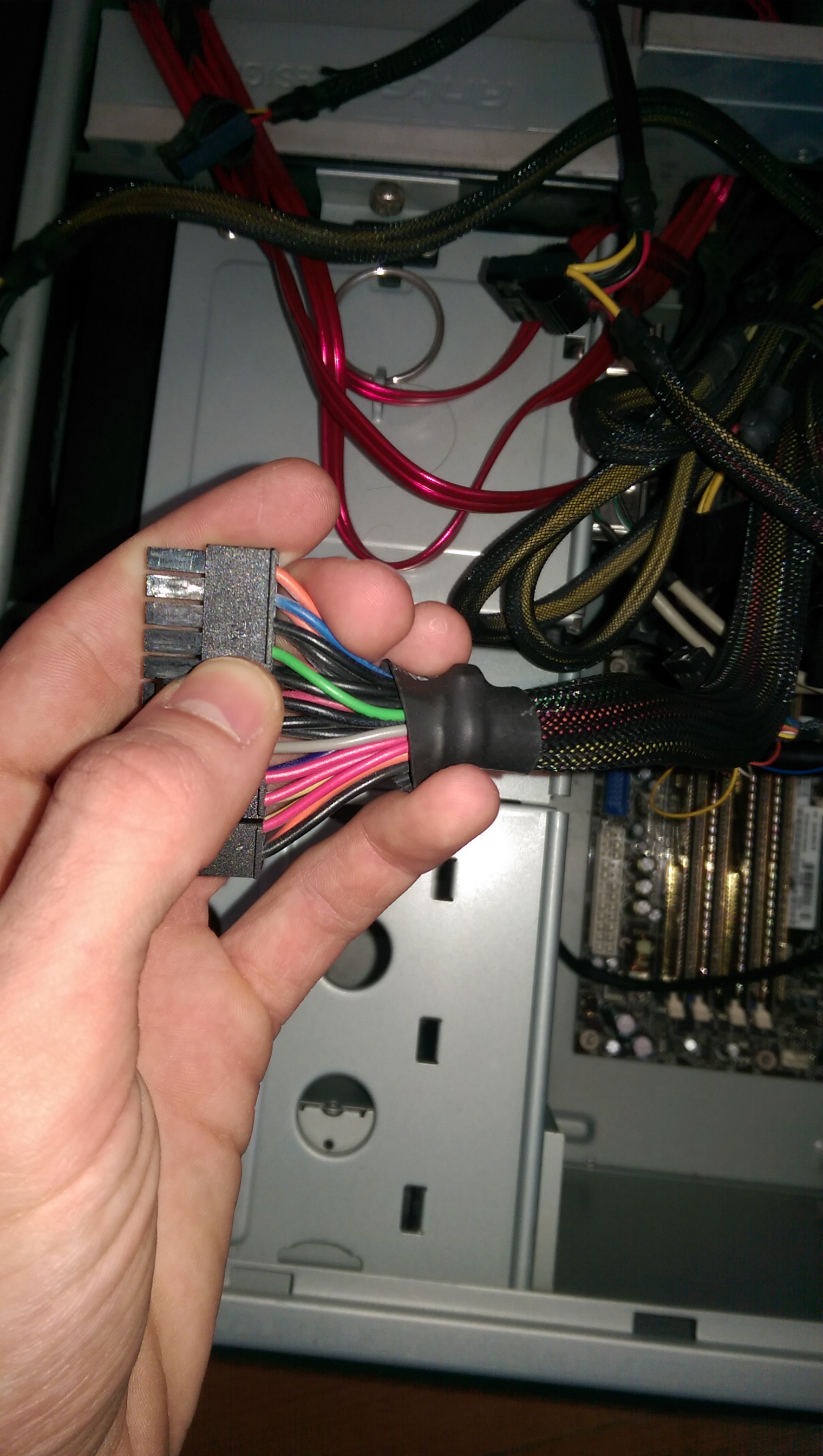

                                        #39
                                        OK, so I tried unplugging everything and only leaving in two of the fans connected to the PSU. When I turn the power on the PSU on, I don't get any movement whatsoever, I don't even hear a sound. The PSU fan doesn't jerk at all, not even when everything was plugged in, let alone only the case fans.
                                        I'm not sure which green wire you're talking about, is it the one in the picture i attached? Also don't know what jumper wire is, do I just take any wire I have lying around, stick it in the connector where the green wire is, and then connect that to one of the black wires on the atx connector too? Sorry for making you dumb it down so much

                                          #40
                                          yes, i said green wire on the main atx connector. jumper wire looks something like this.
                                          if u arent an electronics hobbyist and dont have any loose wires lying around that u can pull out and use, then prolly head over to whatever nearest electronics store closest to you and show them the pic of the jumper wire u want and buy some. its less than a dollar for one or a few of 'em.
                                          for safety reasons, do NOT use any bare or exposed wire and have that bare exposed wire touching your skin when shorting the green wire as we dont know the condition of the psu.
