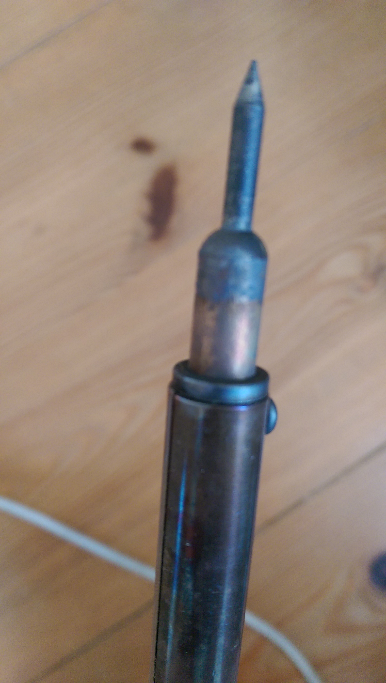

    Also, when soldering, I'm new to this as well, I notice that my iron doesn't melt the solder to liquid, it melts it and then it falls down into a ball. Is my soldering iron not hot enough? Its a radioshack brand, and I'm using the 40W setting (highest it goes). Ive never tinned my iron because as I try to it just makes the solder fall off into a ball, so it doesn't stick to the iron.

    Manufacturer and series doesn't matter as far as replacements. It's the type, low noise or low leakage or low ESR and the values that matter. Also use good quality Panasonic, Nichicon, or United Chemi-con, something like that. Epcos or Cornell-Dubillier. Stay far away from Chinese capacitors. If the unit is old it will be hard to find the same diameter without getting a higher voltage. The caps are much smaller than they were 40 years ago. In the eighties they made major improvements to caps.
    Your soldering iron tip is unsolderable. You can try filing it down to fresh metal or get a new tip or just take it back and get a new one. Corrosion will cause it to not be solderable. One time I got a bunch of banana jacks out of stock, 130 of them, got them all mounted and then tried to attach wires. They were ruined, had to throw all of them out and get new. If you want, try chucking up your tip in a drill and hold it against a file. Let it spin against the file until your down to new metal, you can put a new tip on it too when it gets thick and dull.
                  your tip is badly oxidised thus the solder will no longer adhere to it. an oxidised tip can also no longer transfer heat as effectively to the solder joint thus the solder on the pcb wont melt. always tin your tip the first time u use it and then wipe it with the wet sponge to prevent it from oxidising. also dont let it heat up for too long the first time or it becomes oxidised and u can no longer tin it due to non-adherence of the solder.
                  u can also use a tip refresher like this goot tip refresher which burns off the oxide layer and retins the tip for u at the same time. however, be warned that it is acidic so u will need to wipe the tip with a wet sponge after dipping it in the tip refresher then rinsing the sponge and wiping the tip a few times to get rid of all traces of acid or else the acidic residue will corrode the pcb traces.

                    you may be using shit solder,
                    the chemical mix in the flux makes a huge difference between solders.
                    if you need to solder brass btw, make sure the flux has Halide in it.

                        Does the image I attached of my tip look like its oxidized? Its the first time I use the soldering iron, so it shouldn't be oxidized, but my .022" diameter lead-free solder is not sticking to the tip.

                          your iron got too hot - it takes a lot to blue the metal!

                            It can get too hot?
                            I filed it down and got it shiny again, and then tried to get some solder on it. I actually was able to, but not on the tip of the tip, just around the angle. I tried then putting it to my board, but the caps are soldered on there pretty well, I guess I need some solder braid to make sure the solder comes off before it just hardens back on.
                              eeks, i just saw the image of your board as i was posting my msg. at first, i thought we were dealing with a p4 or pentium-d era leaded solder board due to the electrolytics caps. but then i saw the q6600 lga775 socket and the nvidia logo on the northbridge heatsink and i realised we were dealing with a rohs lead-free solder board! u said u had a 40w iron? im afraid that is inadequate wattage for desoldering/soldering a lead-free solder board. u need at least 60w or maybe even 80w or more because lead-free solder melts at a much higher temperature than leaded solder so u need a high wattage iron to maintain the high temps to keep the solder at its liquidus temperature while u desolder.
                              so i dont think its your tip. its just the wattage of your iron is inadequate for lead-free soldering/desoldering.
                              also, lead-free solder is a pain to work with by hand especially for a newbie soldering for the first time. i suggest u use rosin core 60/40 leaded solder instead. dont worry, u wont get poisoned by the lead. just dont inhale the soldering fumes and wash your hands after u're done soldering and u'll be fine. u need to add a dab of leaded solder to the lead-free solder joint, its okay to do this. this lowers the melting temp of the lead-free solder making it much more easier to melt and desolder the caps.

                              i thought soldering irons are supposed to come with a thermostat to cut off the heating element if the temperature got too hot. i dont know much about the build quality of radioshack irons to comment further. i.e. if they properly calibrated their thermostats or not.
                                  no, only variable ones do.
                                  the cheap-assed "hobby" irons are just a directly connected element.

                                    I did use a similar iron a few years back to repair the caps on a monitor, that worked out well, and I used the same lead-free solder. I'll get a better iron if that is what you think is the issue with my board though.
                                    umm... a monitor pcb is different from a motherboard pcb which is a many multi layer pcb. a monitor pcb may have less layers than a mobo pcb so u can get away with using lower wattage irons. mobo pcbs also have a LOT of copper in them compared to monitor pcbs. the copper acts as a heatsink sucking the heat away from your iron tip.
                                    unfortunately, i cannot advise u on soldering irons as i only use cheapskate generic "disposable" irons. maybe someone else more "professional" with soldering irons can help u with that.
