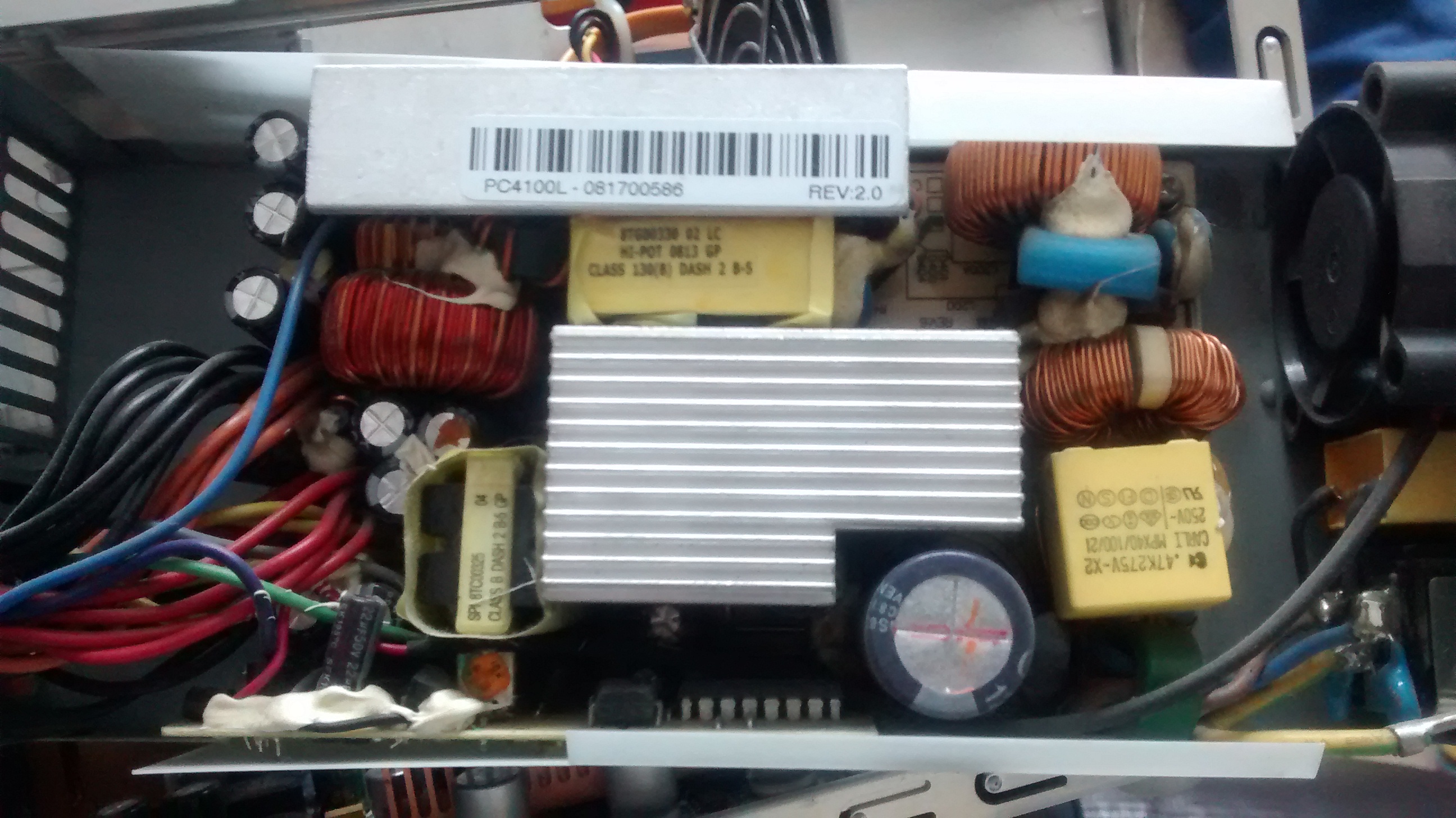

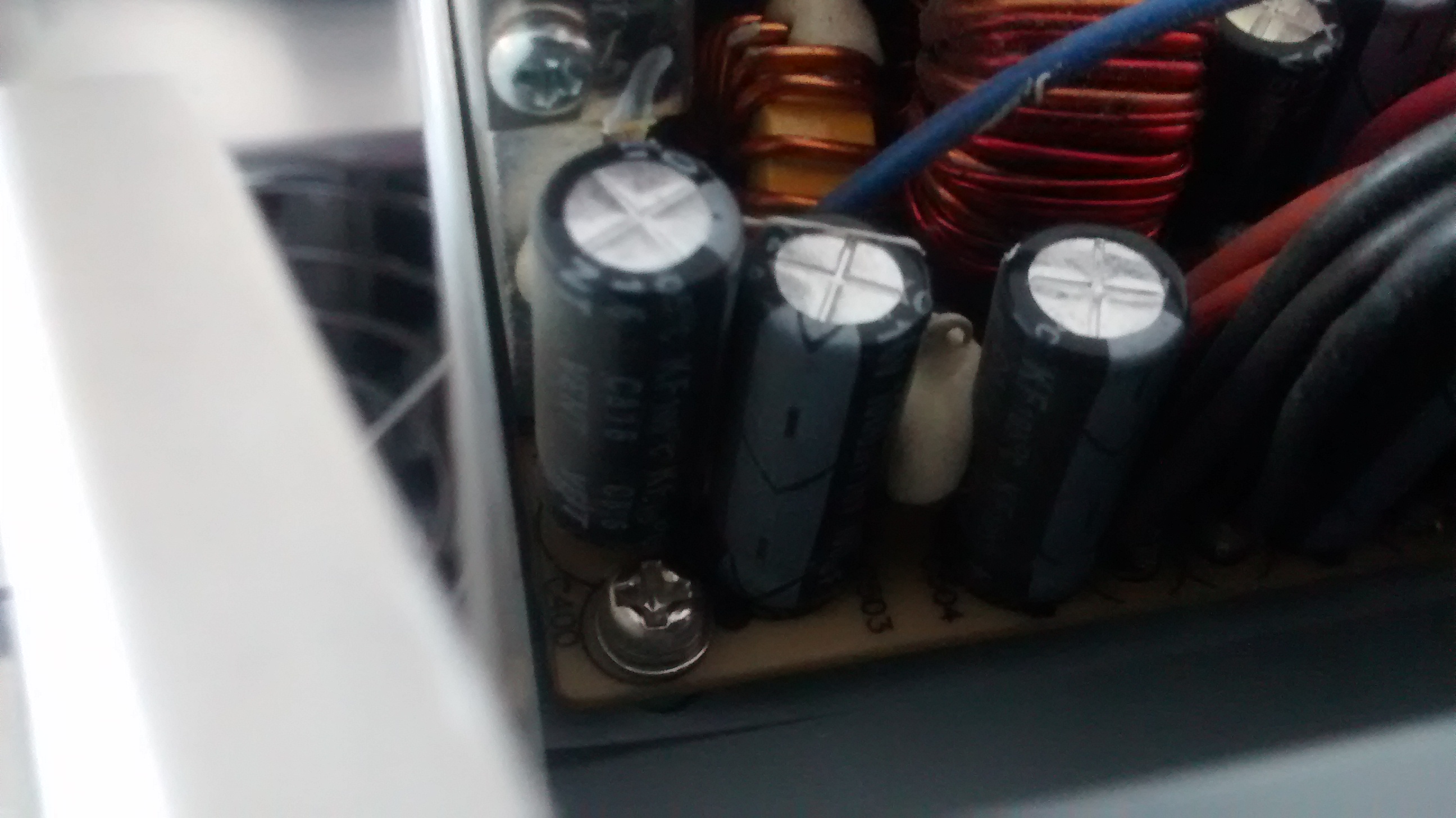

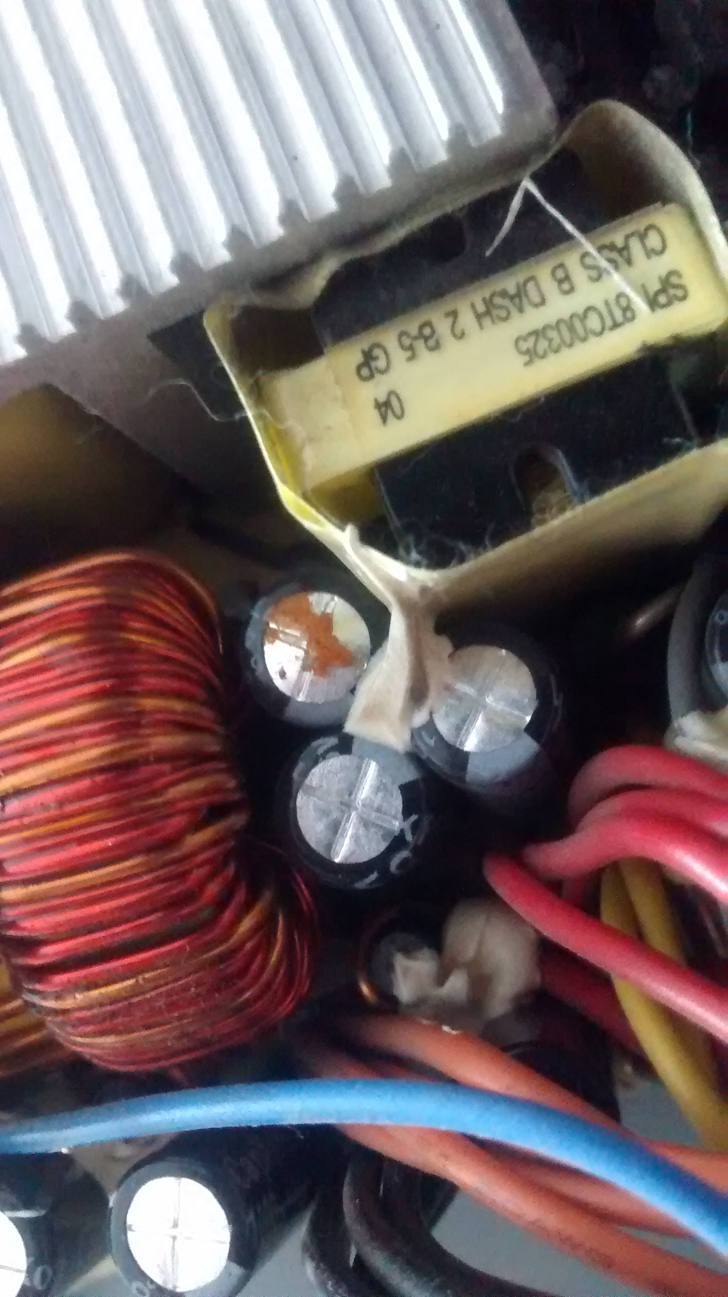

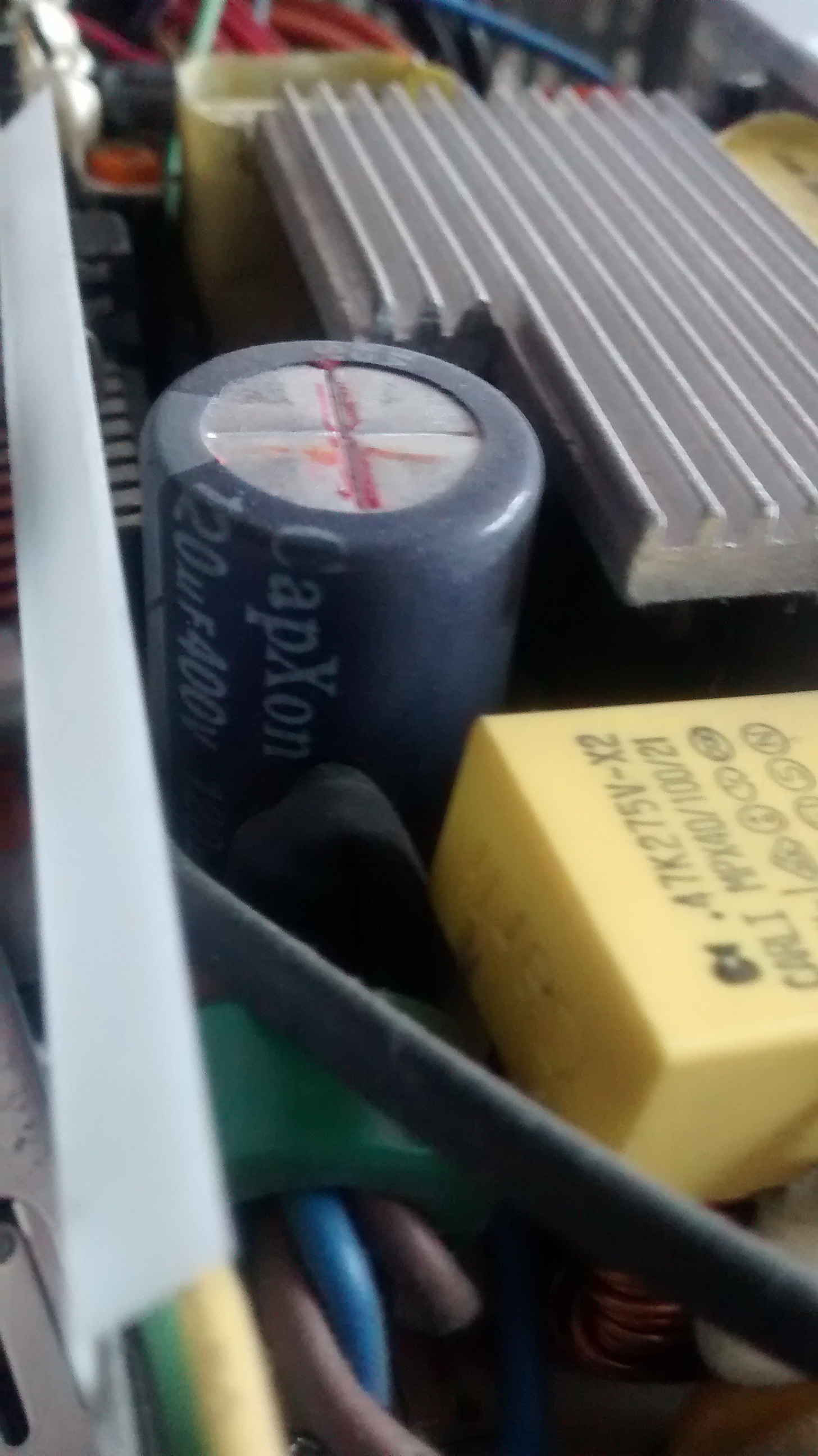

          PSU is a 250W Elanpower unit, pretty much 100% CrapXon, one already popped.
          Sorry for the quality of the pics, only have my phone to hand at the moment.
          So, is this PSU worth fixing do you think? The alternative is to pick up a new compatible FSP unit that I found, and hope there's less to fix in there...
          Edit: Scored a cheap Hipro that should fit, I have a weakness for Hipros

            • 30991
            Re: Pre-emptive recap on Shuttle SG31G2?
            FSP used to have an obsesion with Teapo,
            the few HiPro i have seen use Lelon
            better to get new caps i suspect.

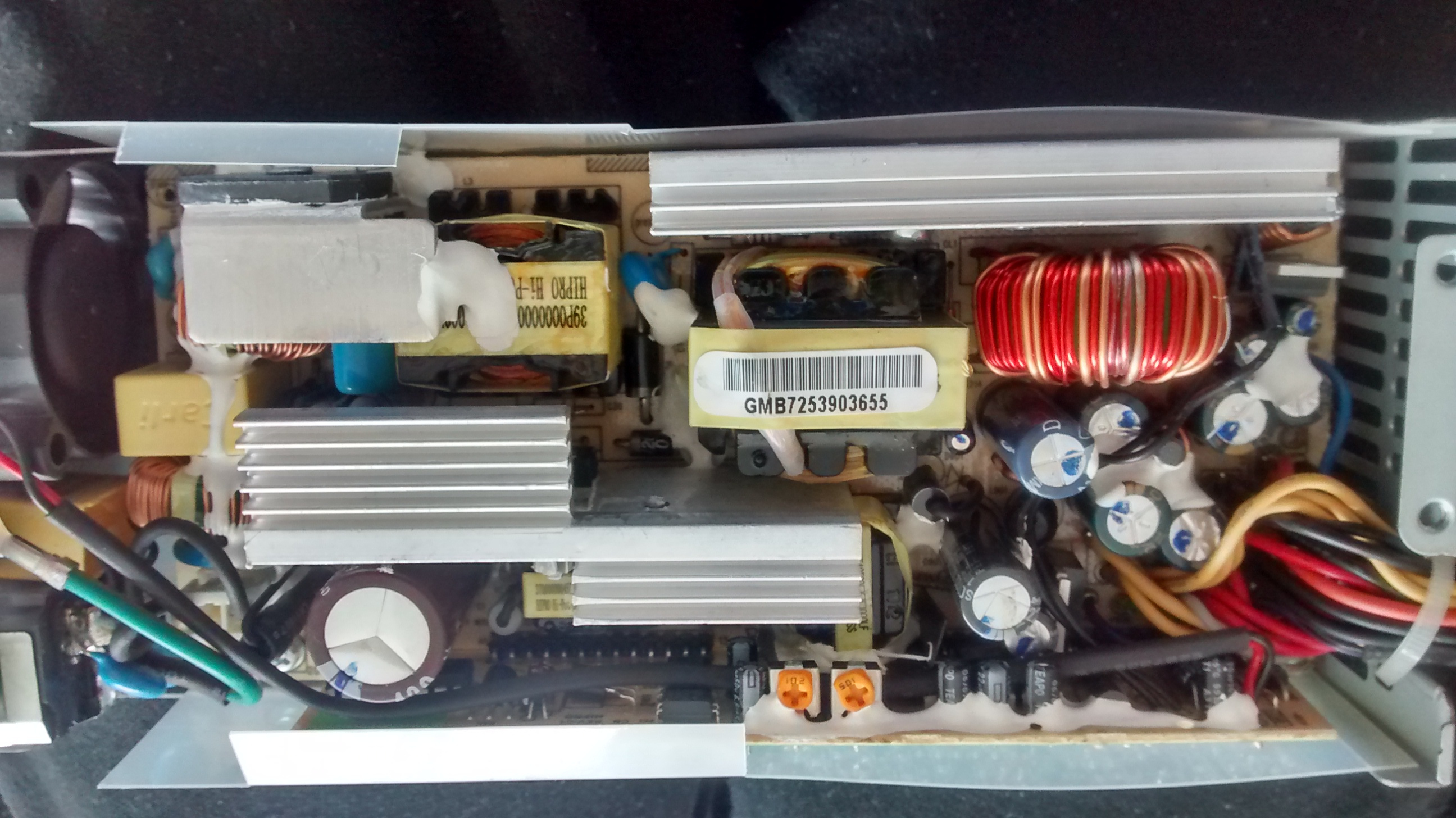

              Oh yes, the PSU will be recapped. I'll take a look at the HiPro when it arrives and check with you guys to see which one is most worthy. Then I'll recap the other one anyway as a spare.
              I've got a stack of Panasonic FRs ready to do the motherboard after that. The Sanyos currently on there are SGs, but I'll replace them anyway.

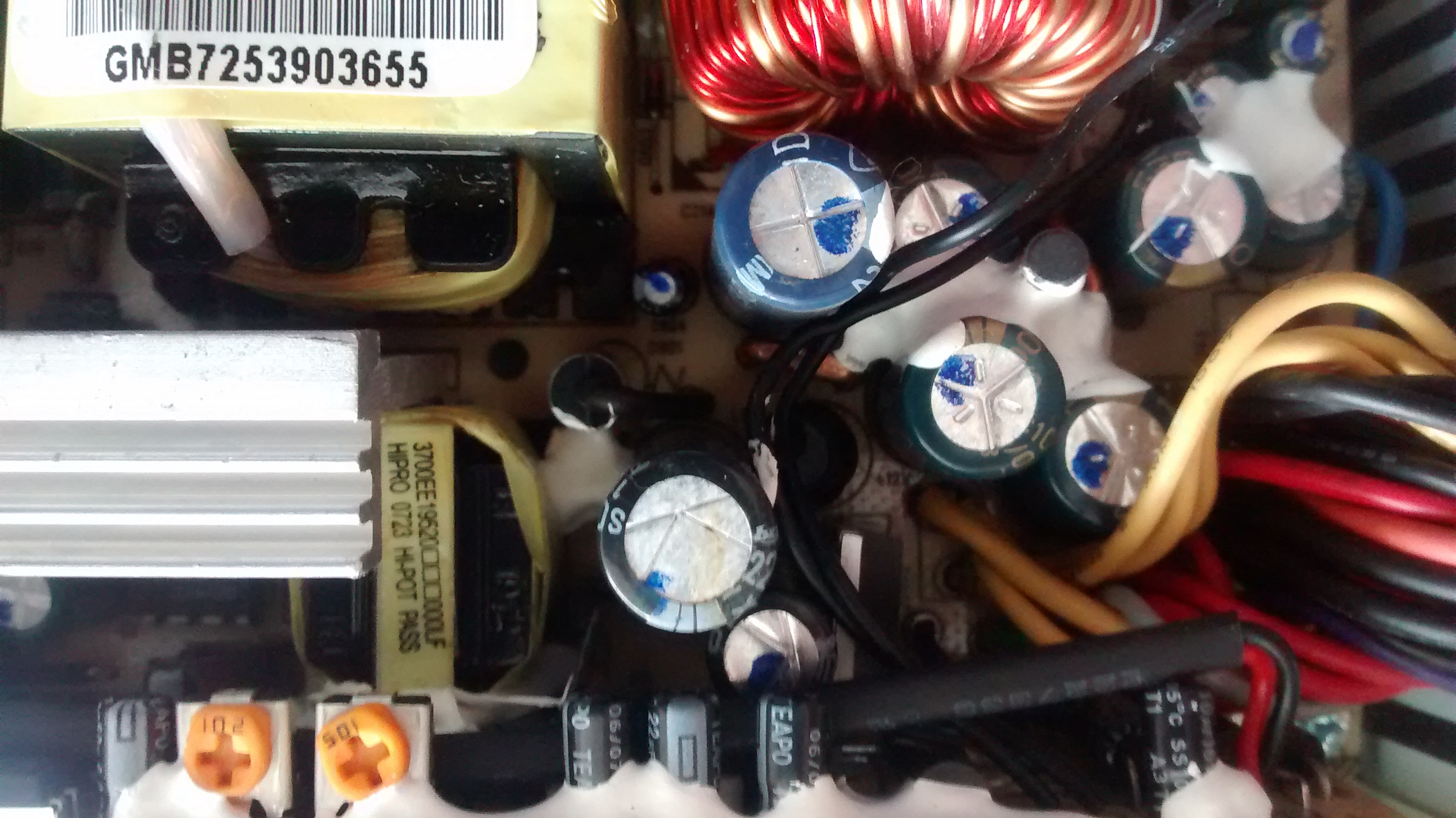

              • chowder
                • Feb 2016
                • 44
                The HiPro has a KMG primary, an Ltec (ugh), 2 Rubycons (yay!) and the rest are Teapo (blah). The layout is a lot less cluttered than the Elanpower though, so it should stay cooler.
                The mobo has been partially recapped - I ran out of time to do the 1000uF OSTs, but the main caps have been swapped for Panasonic FRs.

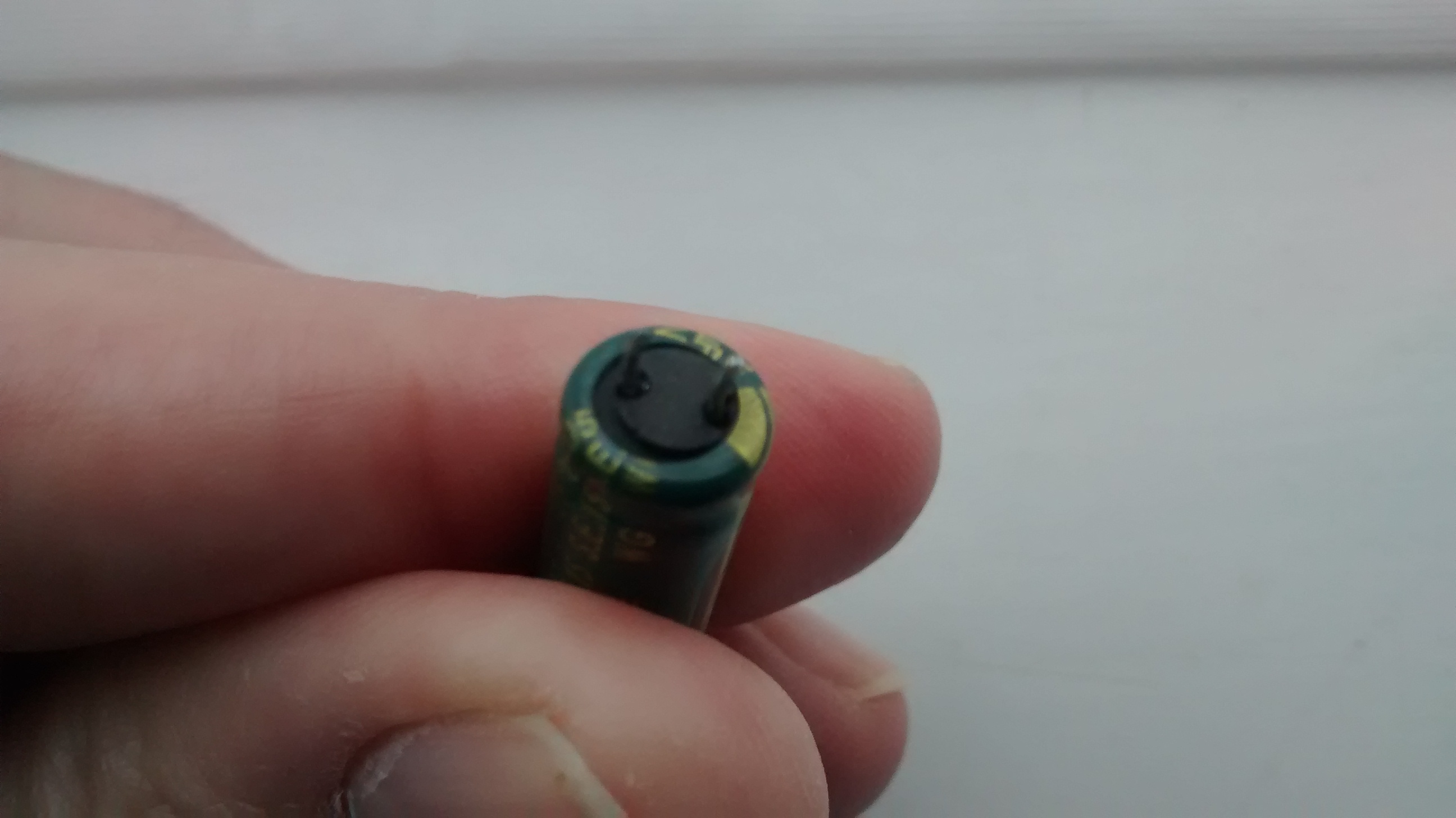

                    Originally posted by chowder
                    The Sanyo WGs were not original, someone had recapped whatever was there before me! I'm betting they were OSTs, those three 6.3v 1800uF caps seem to be a weak link, they're next to the NB, so likely responsible for the problems momaka had. I debated leaving them, but in the end swapped them out too.
                    Good thing you got rid of them. For all you know, those Sanyo WGs could be counterfeit if the person who did this before you got them online. Mind posting a picture of them? (bungs, vent, and case/body)

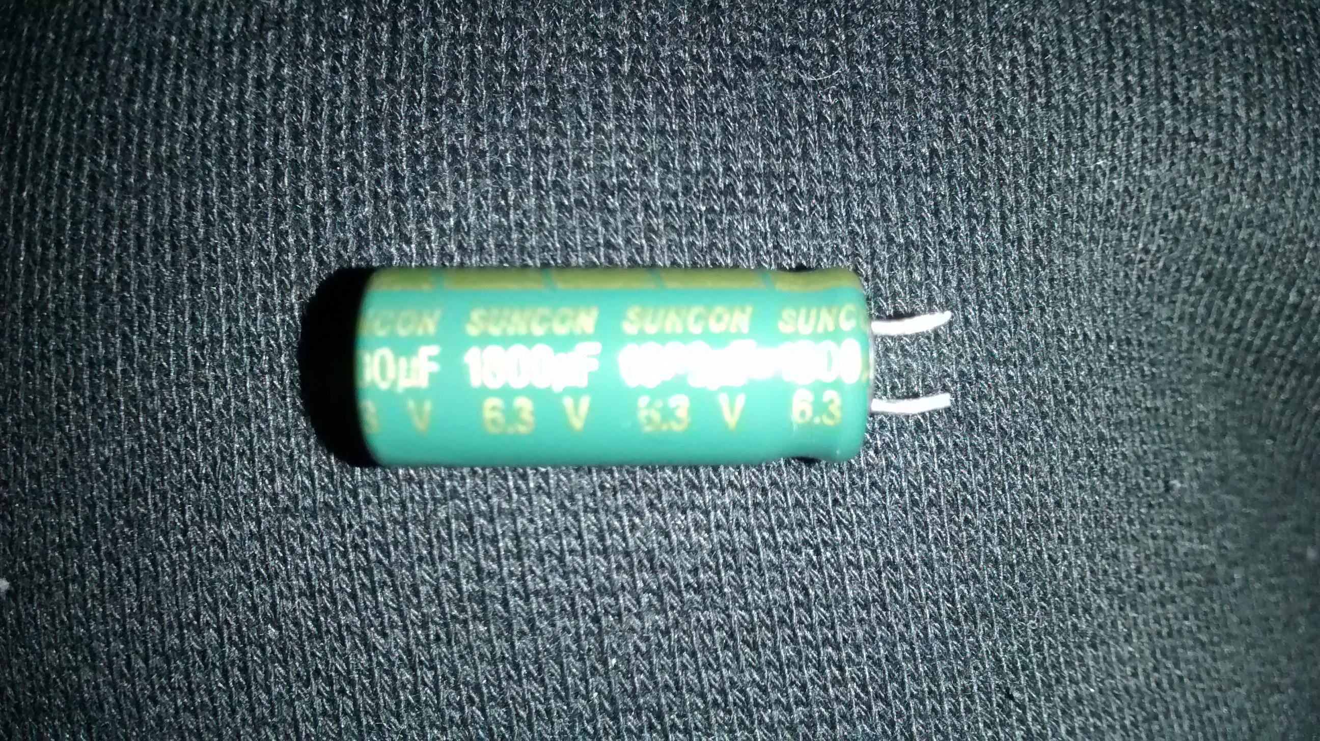

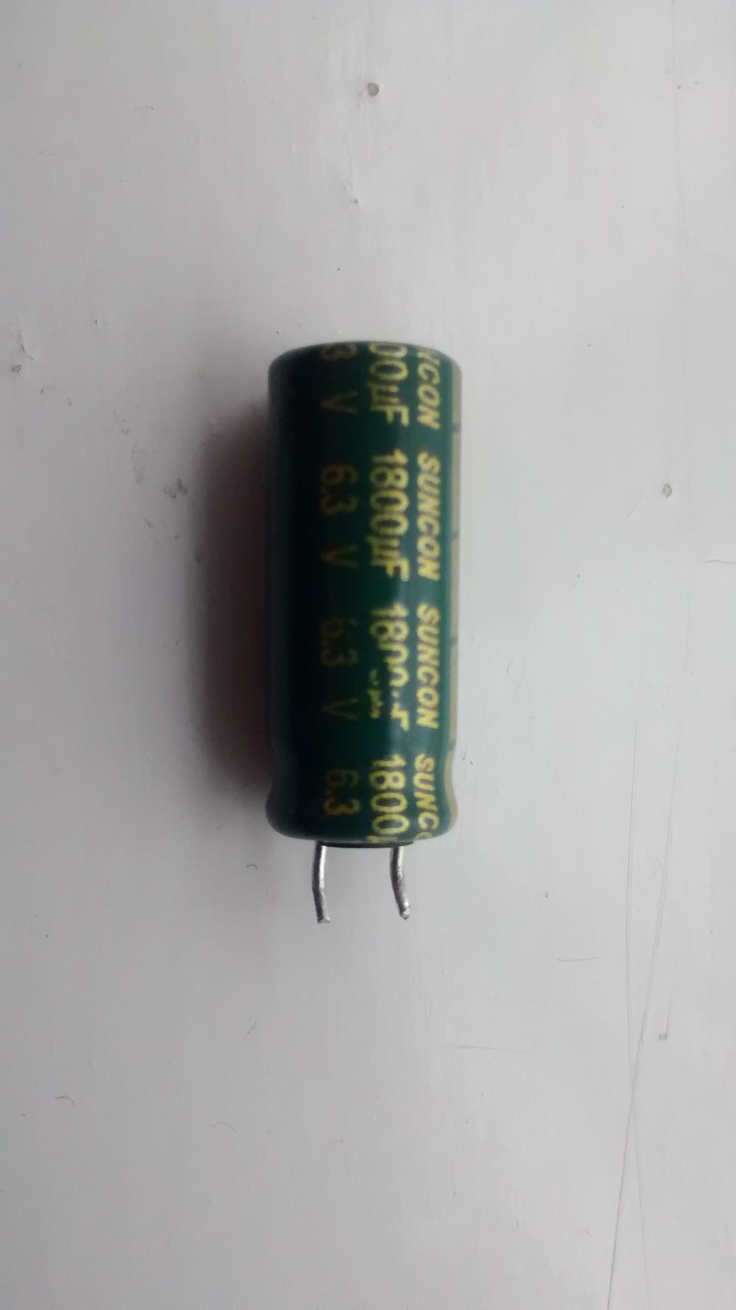

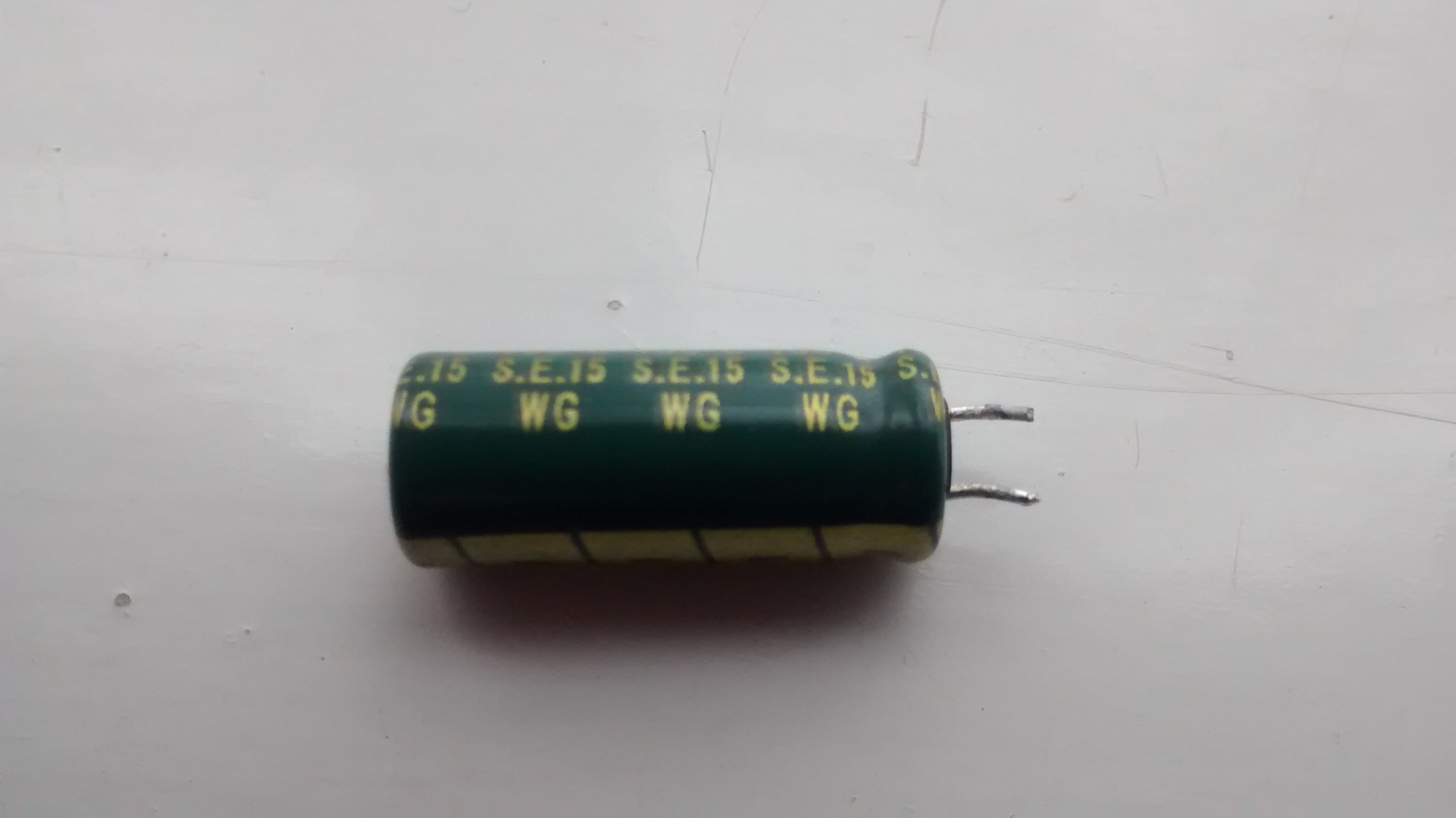

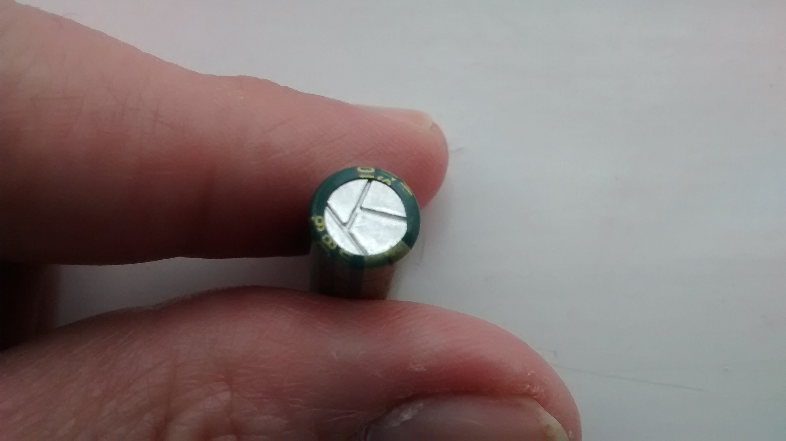

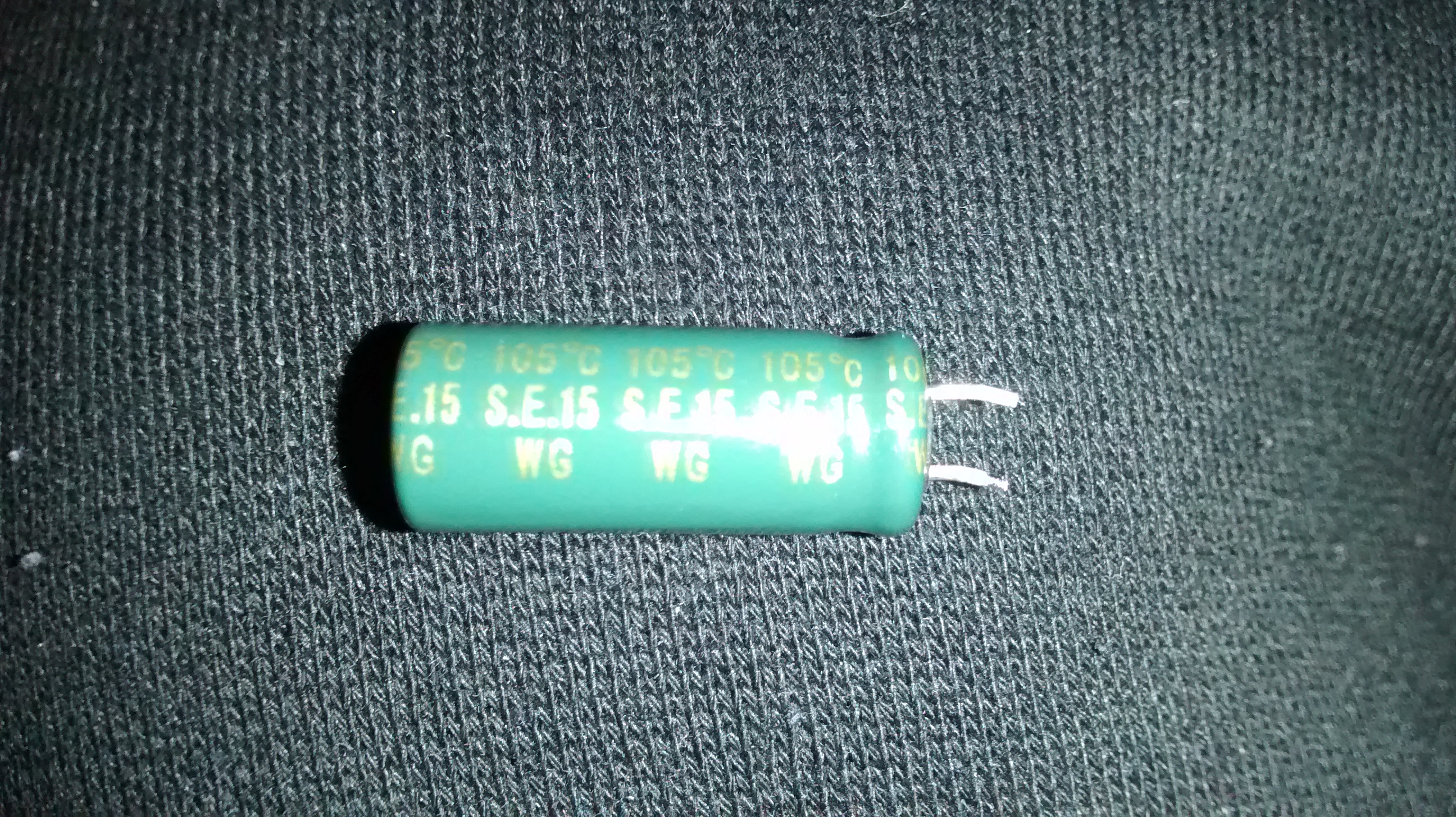

                          Pics attached. My camera is still out of action, hopefully they're good enough. They look OK to me, but I don't think I've ever seen them in person before, so what would I know Definitely more legit looking than some of the ones I've seen on eBay!
                            • 30991
                            those foto's say SunCon not Sanyo !!!
                            • chowder
                              • Feb 2016
                              • 44
                              Suncon make Sanyo caps, don't they?
                              https://www.badcaps.net/forum/showthread.php?t=14734

                                  • ChaosLegionnaire
                                    HC Overclocker
                                    • Jul 2012
                                    • 3264
                                    • Singapore
                                    the suncons in the first four pics look genuine to me. the vent is right, the bung is right (chain link fence style bung), the colour of the sleeve printing and font look right. the "V" and the "F" are the same size/height as the numbers. but could be a very good fake as there are tons of fake sanyos/suncons out there and forgers seem to love faking sanyo/suncon caps. no idea why.
                                    as for the last two pics, i cant comment because the flash may be too bright and its affecting the color of the sleeve printing.

                                        master hoarder
                                        • May 2008
                                        • 12170
                                        • Bulgaria
                                        I second that.
                                        If they are fakes, they look pretty darn close to the originals. Probably okay to re-use in non-critical projects or ones that aren't really worth getting new caps (but maybe still worth repairing just for the heck of it?)
