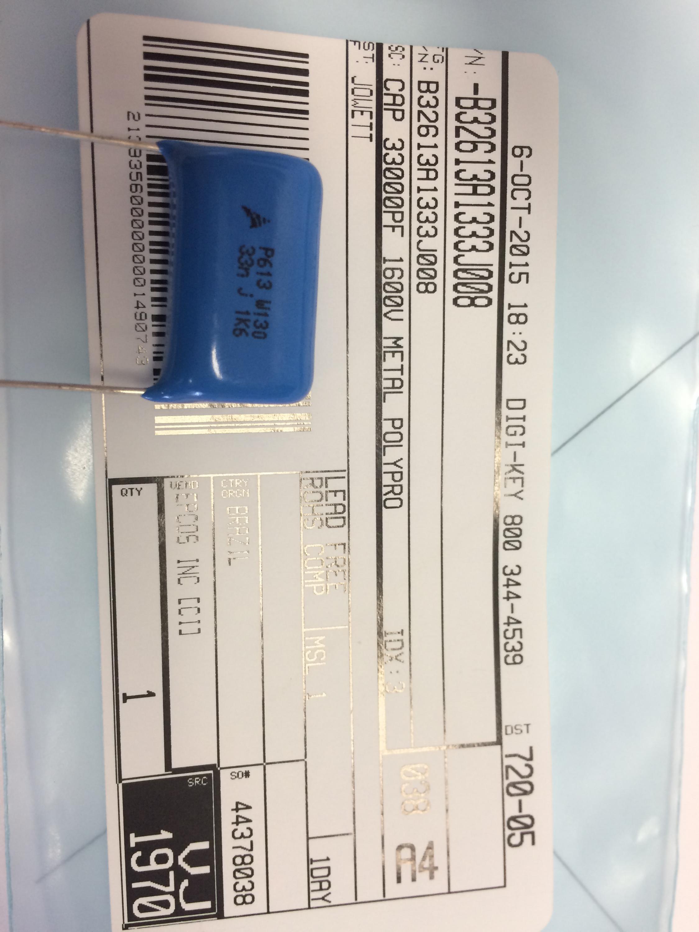

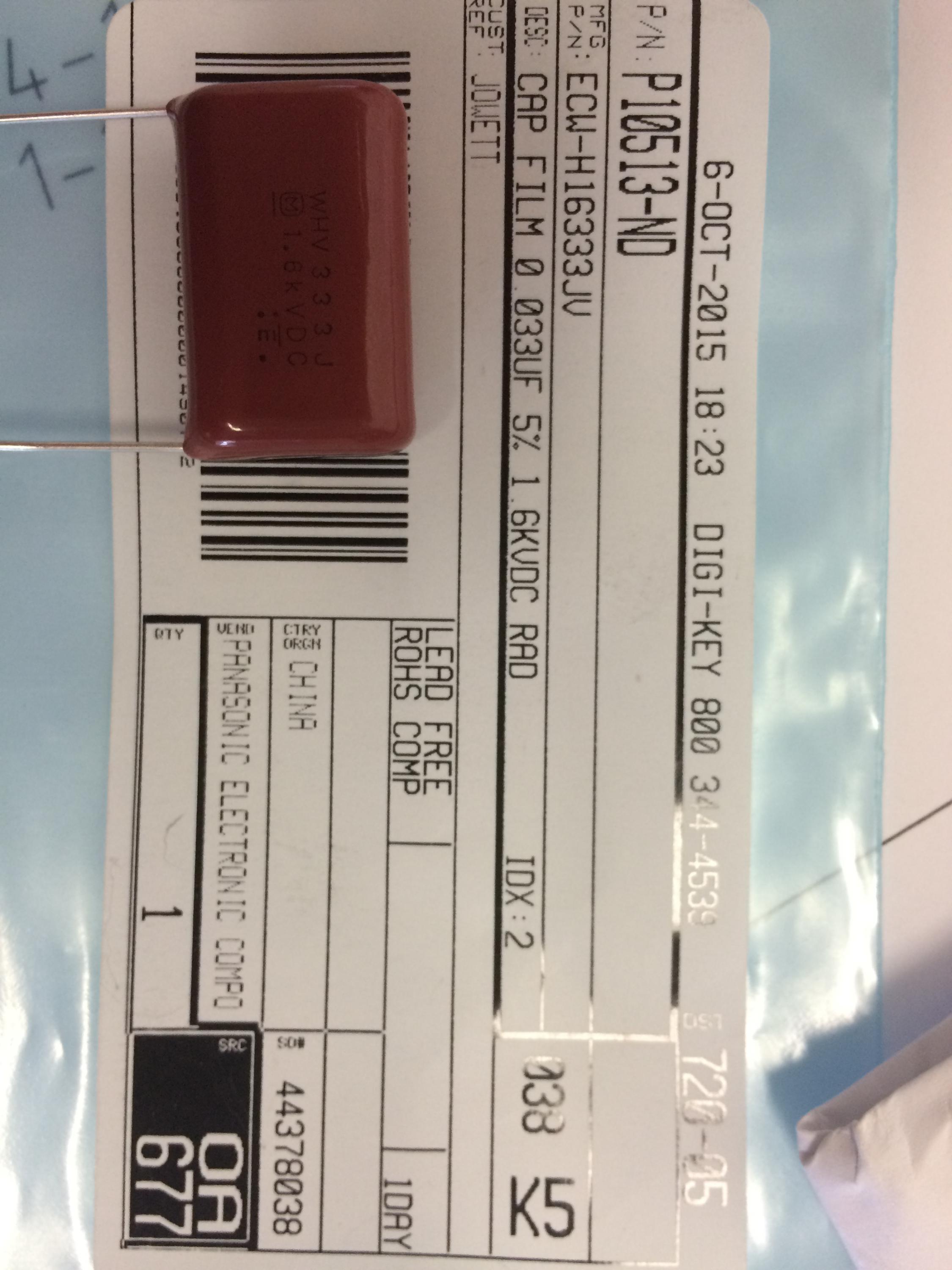

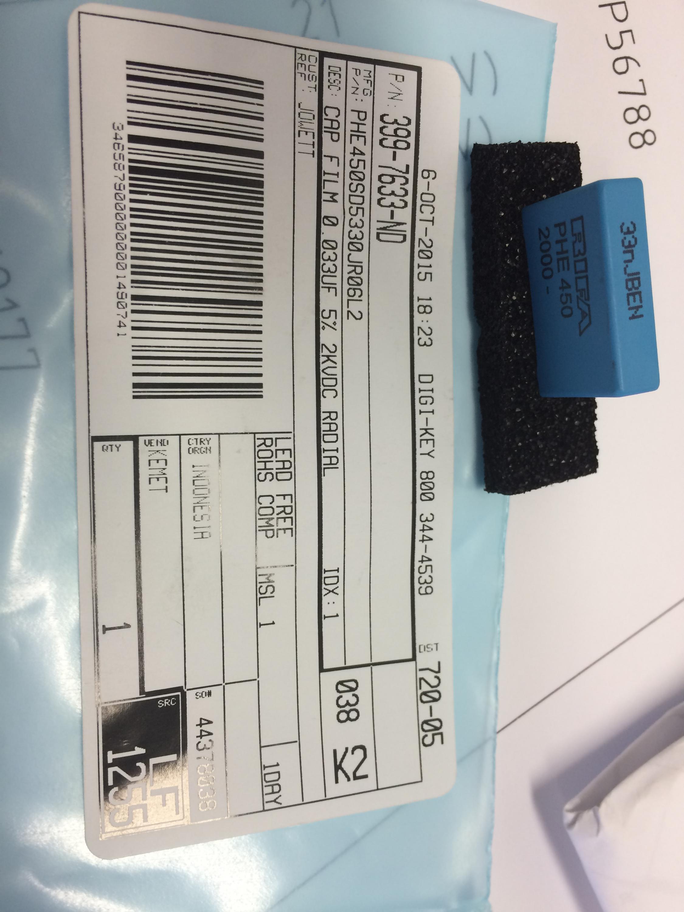

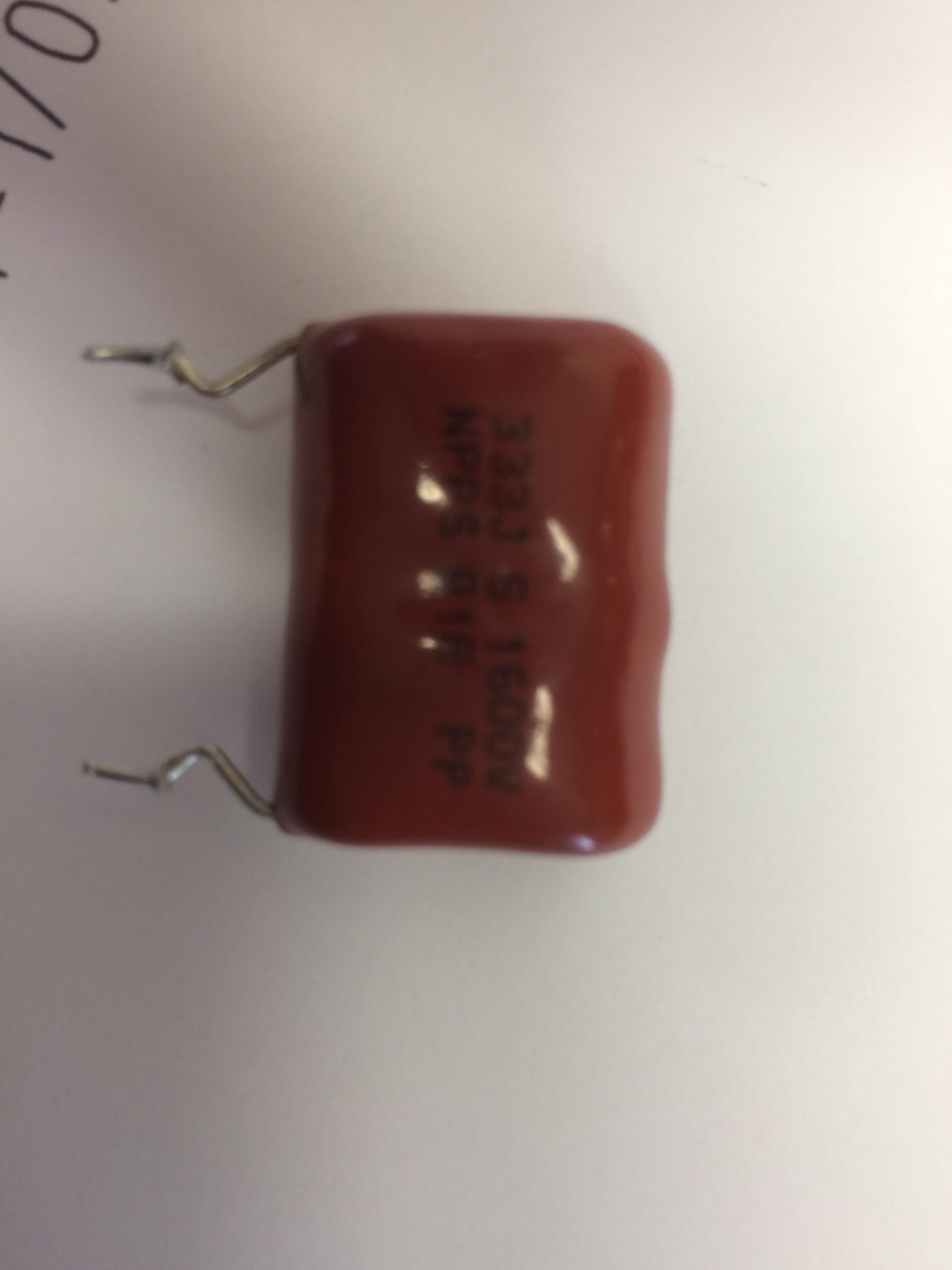

    Hi guys,
    My LG 60PZ570-TB plasma turned itself off the other day. I suspected the C802 capacitor after reading other users experiences. I removed the capacitor and upon inspecting it I could see it was bulged a little bit.
    I have 3 new film capacitors, just wondering if someone could confirm which one (if any) are a suitable replacement. I've attached pics of the existing and the 3 new capacitors.
    Thanks in advance.
    Cheers,
    AJ

    Polypropylene (PP), PANASONIC Designed for high frequency and current applications will be my choice.

      Thanks for the reply Budm. Am I correct in saying that the one you suggested is rated to low for this application? The one I removed was rated at 1.6kV, I have read that people upgrade to a 2kV to prevent the cap from blowing again. Forgive me if i'm wrong, still trying to learn.
      I have the following PP cap, will this do the job?
      http://www.digikey.com/product-detai...593-ND/1647874
      Cheers.
