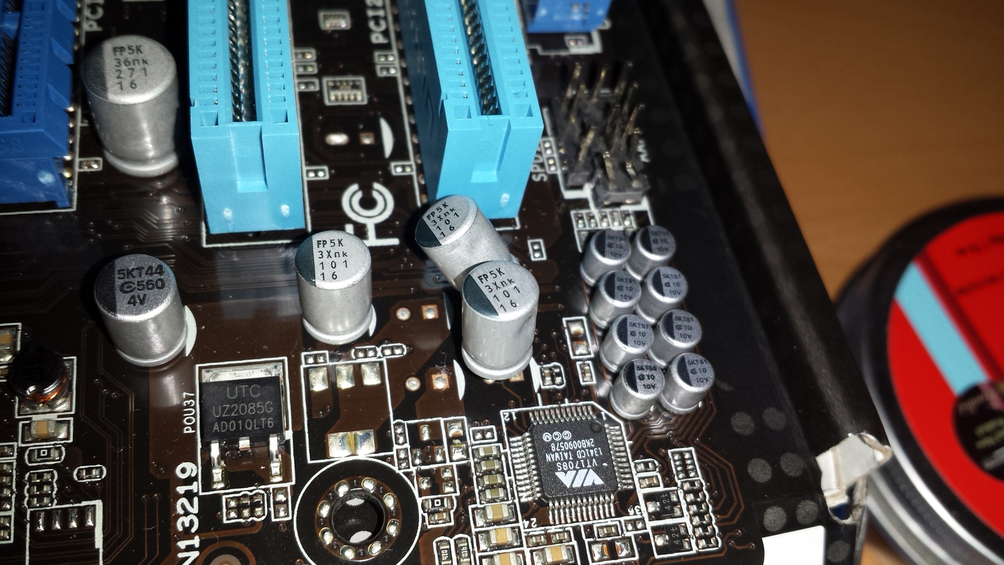

    Hi
    Need Help identifying a capacitor on my Asus m5a78l-m Mother board, or where i can buy replacements?
    Fp5k
    3xnk
    101
    16

    Re: broken motherboard caps
    100uf 16v polymer.
      As stj says. I'd replace the one below as well, it seems to me like it's dented (probably hit by something that damaged the other one more)
      As to where to buy, this would work : http://www.tme.eu/en/details/ulr100_.../ulr107m1ce11/
      If it's more convenient, any of these should also work (though I don't know who makes them, wurth is a company that rebrands other manufacturer's capacitors) :
      http://uk.farnell.com/wurth-elektron...ial/dp/2466590
      http://uk.farnell.com/wurth-elektron...ial/dp/2466522
        Thanks guys, where can i buy them from?
            No preference, Mate would like to stick to the similar types of caps on the board.
              Hi are these panasonic caps ok for my motherboard ?
              http://uk.farnell.com/panasonic-elec...rad/dp/2354601
                Yes, those will work just fine.
                  those are good if the diameter is the same - you never said the size.
                  that's a surprise btw, oscon caps used to be from sanyo.
                    thanks guys
                    just ordered them with free shipping happy days the diameter is 6
                      Yup. Panny bought out Sanyo's OS-CON division.
