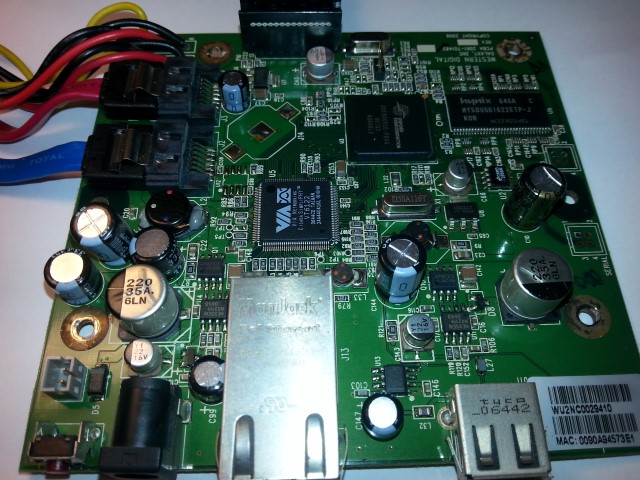

    I need help. I have to replace the capacitors of my PCB My book (Western Digital).
    I identified a UHM0J102MPD3 with a low impedance. The Nichicon no longer producing this capacitor (HM series), and is only paying the shipping costs and import too high. I could not find anything with the same characteristics respecting the low impedance:
    ORIGINAL
    UHM0J102MPD3
    1000 uf v 6.3
    Impedance (Ω) MAX.20˚C / 100kHz = 0.030
    Rated ripple (mArms) 105C / 100kHz = 1140
    8x11,5
    POSSIBLE REPLACEMENT??
    PANASONIC - EEUFR0J102
    1000 uf v 6.3
    Impedance (Ω) MAX.20˚C / 100kHz = 0.056
    Rated ripple (mArms) 105C / 100 kHz = 950
    8x11,5
    Impedance (Ω) MAX.20˚C / 100kHz = 0.041
    Rated ripple (mArms) 105C / 100kHz = 1240
    8x15
    With a bit of effort I could to put the 15 mm, but do you think I could have problems for the highest impedance?
    thanks and sorry for my bad English
    Marco

    Re: Capacitors Low impedance for Mother B
    the pana is not good enough,
    use poly's
    what's the website of your local parts supplier?
    maybe they sell Würth Elektronik caps.
    1000uf 6.3v
    ESR 0.009!!!
    ripple 6100ma!!!
      use poly's
      http://it.rs-online.com/, maybe the most given in Italy!
      thanks I'll try to look for Wurt .
        WOOW!!!!!!!!! I found it!!
        http://it.rs-online.com/web/p/conden...itici/8392271/
              I have Rubycons MBZ 1000/6,3 if you want.

                Re: Capacitors Low impedance for Motherboard
                ORIGINAL
                UHM0J102MPD3
                1000 uf v 6.3
                8x11,5
                1000 uf v 6.3
                8x11,5
                8x15
                Marco
                if you want to use Electrolytes, take a look at Pana FM, they are pretty close to NCC KZG
                What you are looking fore is an ultra low impedance capacitor...
                Sadly they don't deliver to consumers, you have to be a business...
