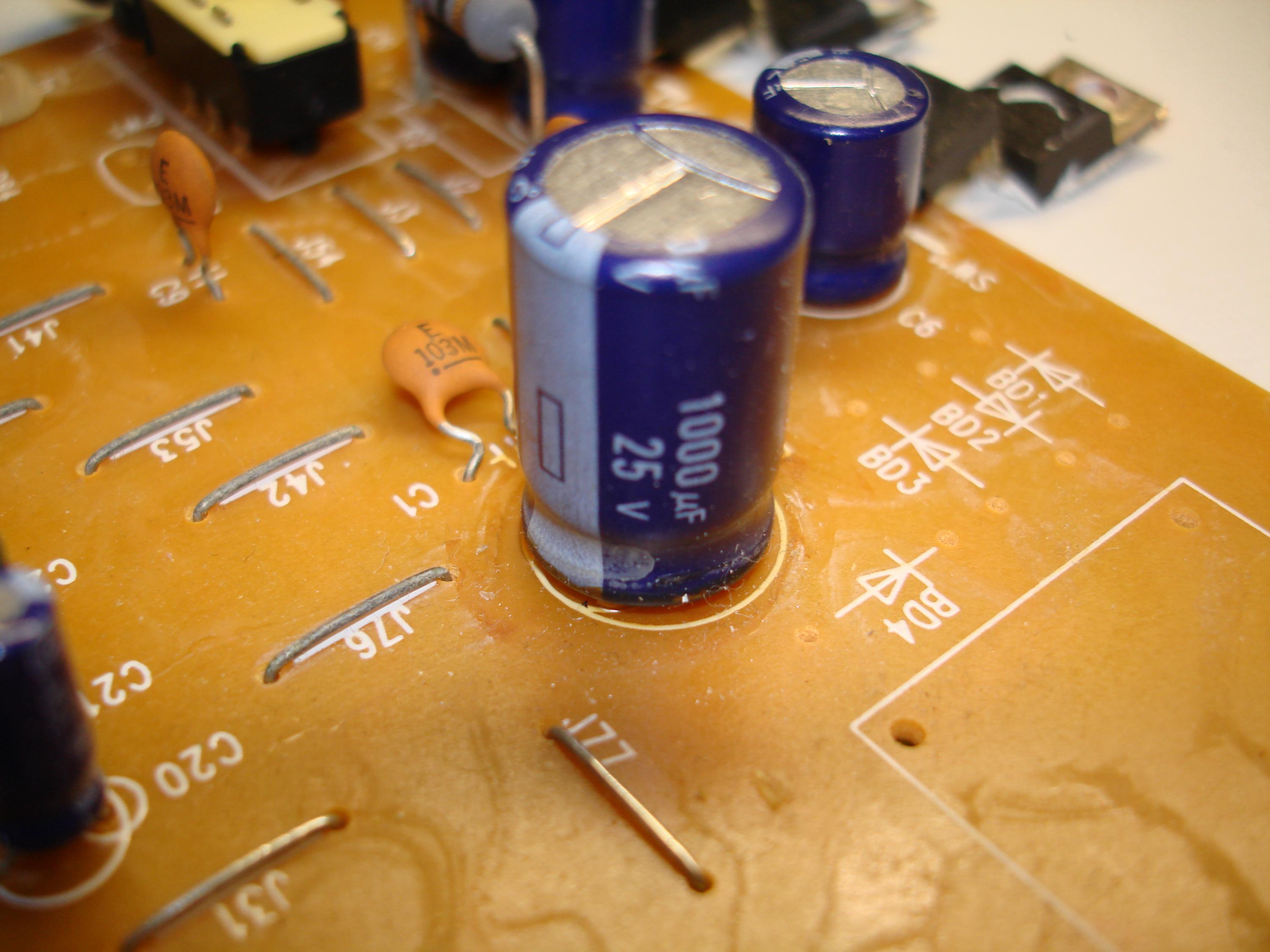

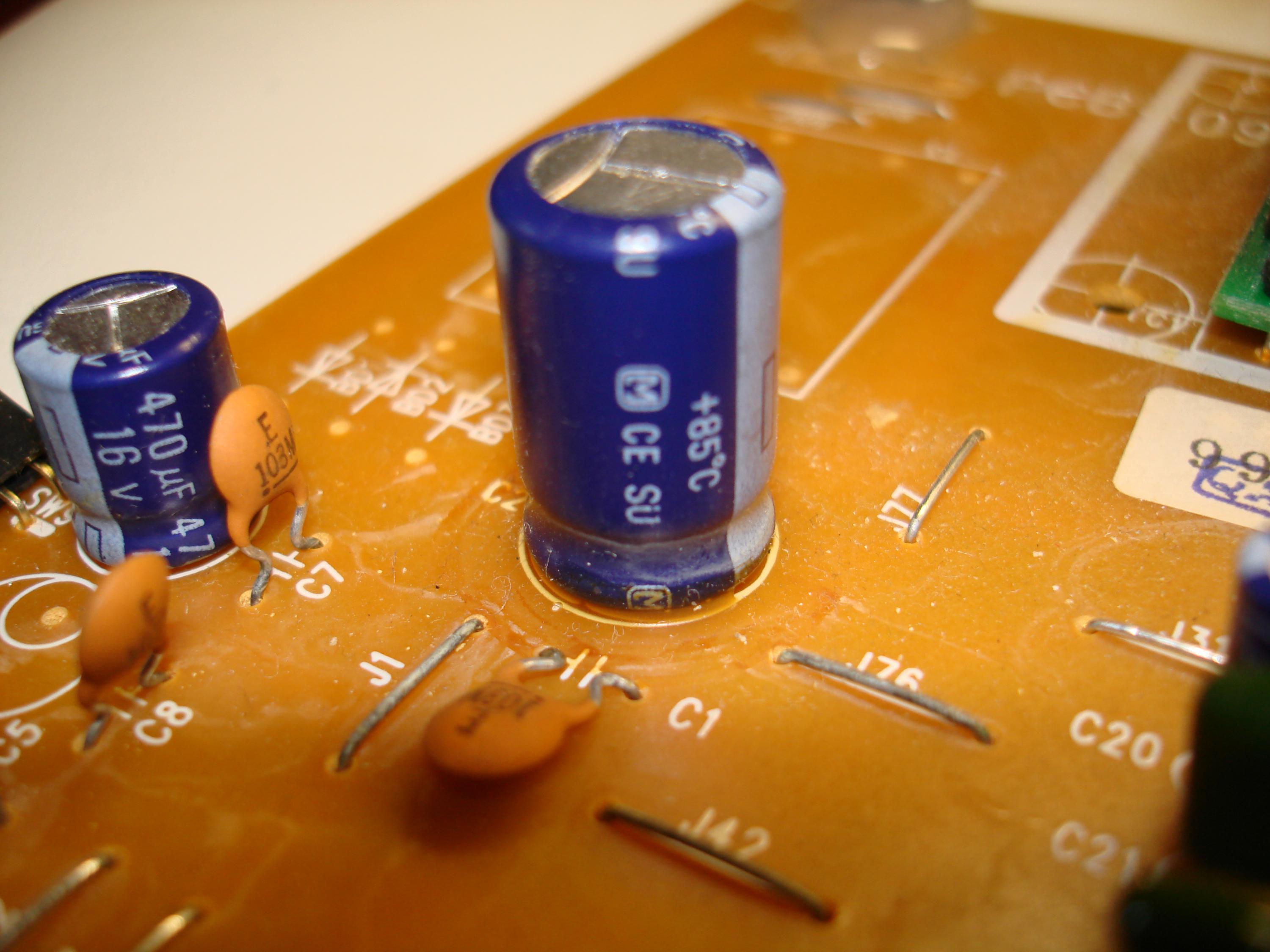

    Help identifying capacitor manufacturer
    Can anyone help identify this capacitor manufacturer?
    There seems to be a 'ce su' and a circled m.

    Re: Help identifying capacitor manufacturer
    Thats a panasonic su series capacitor designed for audio uses great caps btw
    See plenty of them in technics amps they are good caps.
      Thanks for the info. I've got a couple leaking on the board but wasn't sure who made these.
      This is in a piece of av gear.
