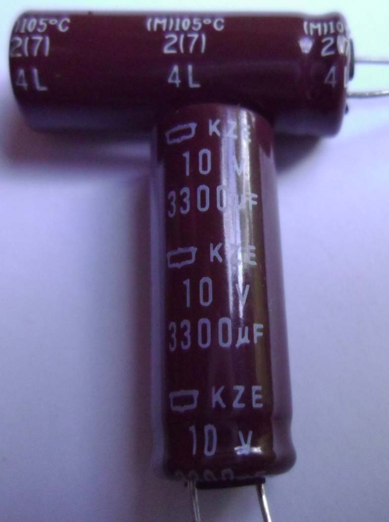

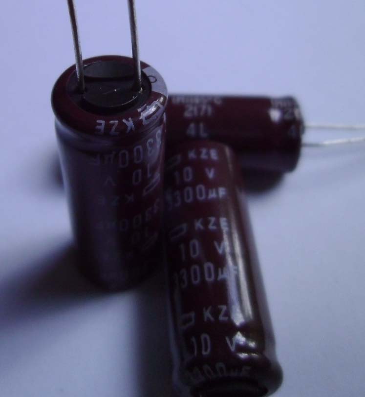

    Needing some 10mm diameter 3300uf 10v to try fixing an old power supply, I took a chance ordering these:
    http://www.ebay.com.au/itm/10pcs-10v...item338da933ad
    Pics show what arrived
    Measure ~0.05 on Dick Smith ESR meter, and ~3050uf on UT61E
    If counterfeits, they're very good ones
    I'm intending to leave positive feedback

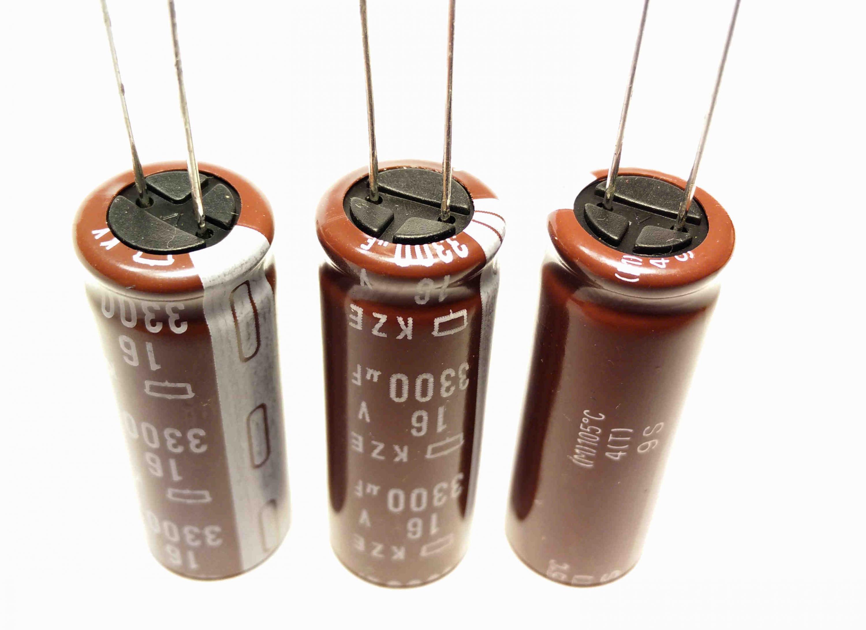

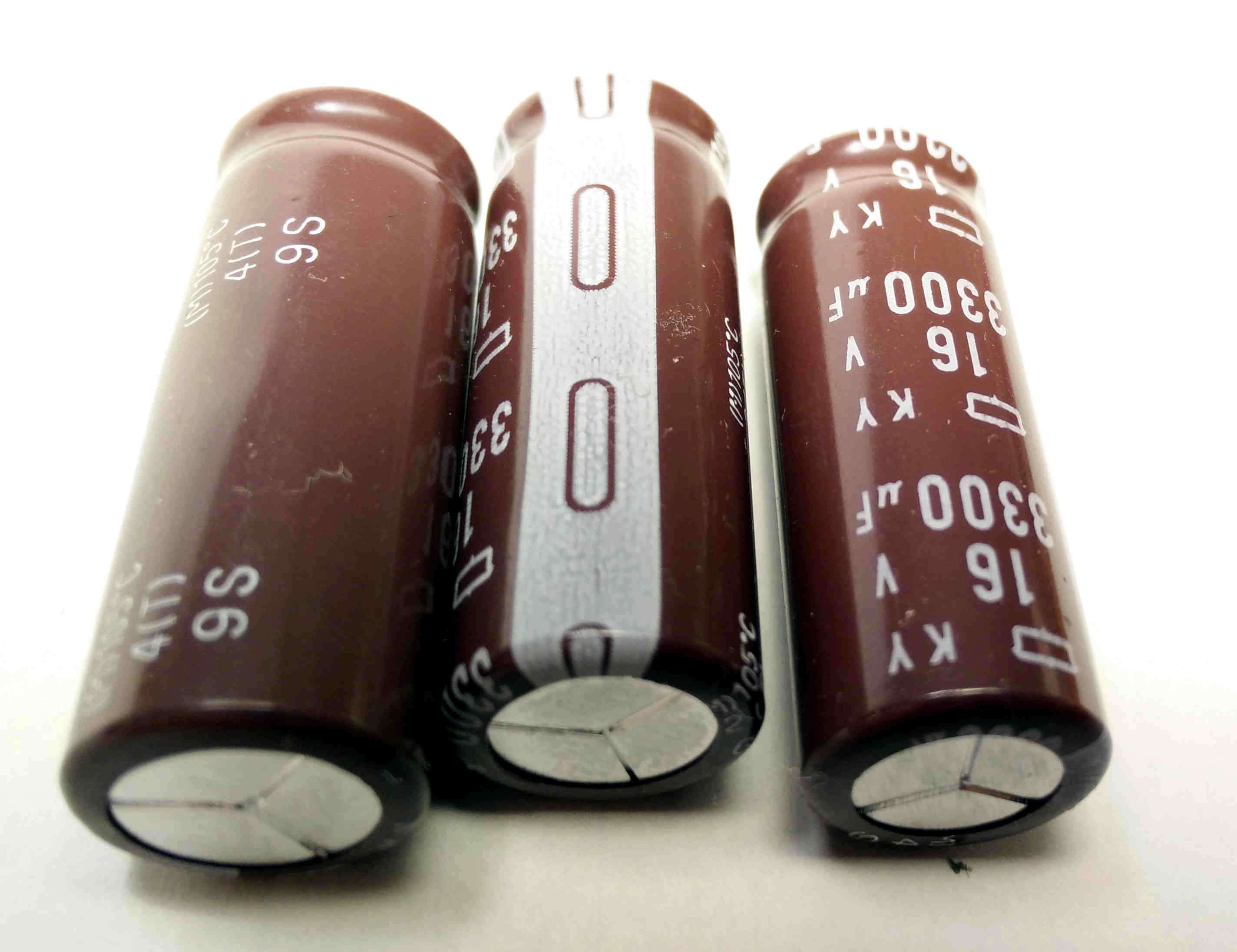

    Here's pics of KZE 3300uF 16V (12.5mm OD) they are fatter than yours. 25mm high, 5mm lead pitch. Purchased from Digi-Key Feb. 2015, country of origin is Japan. United Chemi-Con EKZE100ELL332MK25S
    I could not see a 3300uF 10V 10mm OD in the KZE series catalog. That's why I stuffed these in.
    The bung is different for 12.5mm KZE's, not sure about your vent. I look closely at the labeling to see if it's a fake. Usually the font is different and washed out. The "KZE" is square font and the logo larger on the ones I have.
    I'm not an expert on fakes.
