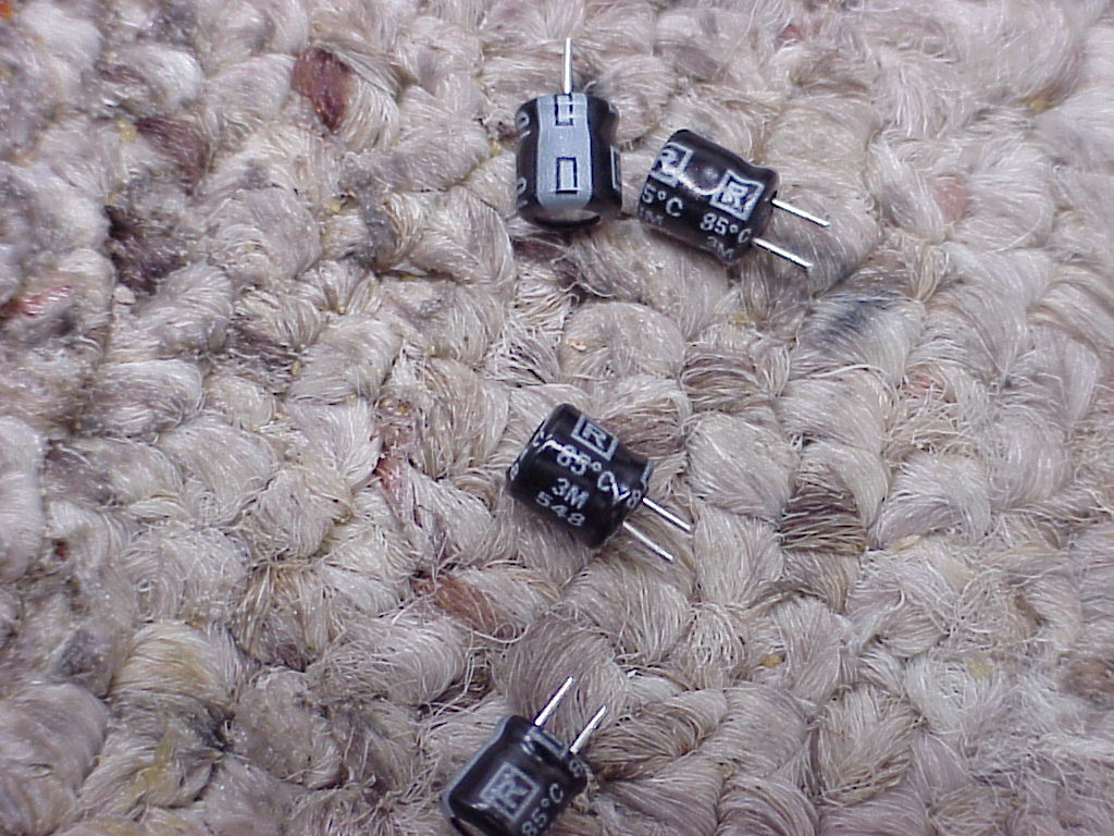

    r brand caps?
    anyone know what these are?
    i only have about 20,000 of them
  • Spacedye69
    • Nov 2005
    • 698
    • US
    Re: r brand caps?

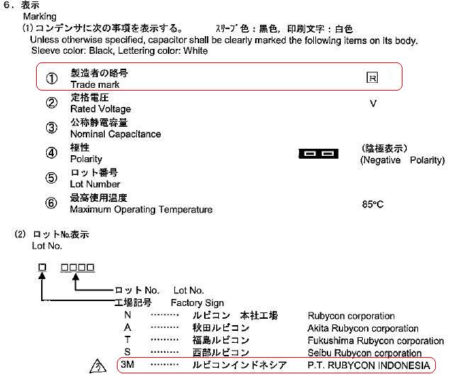

    I thought all the little baby Rubycon have R in a square.
    • Brian C
      • Dec 2006
      • 156
      Re: r brand caps?
      Yup... that is baby rubycon made in Indonesia....
      • kc8adu
        • Nov 2003
        • 8832
        • U.S.A!
        Re: r brand caps?
        thanks.
