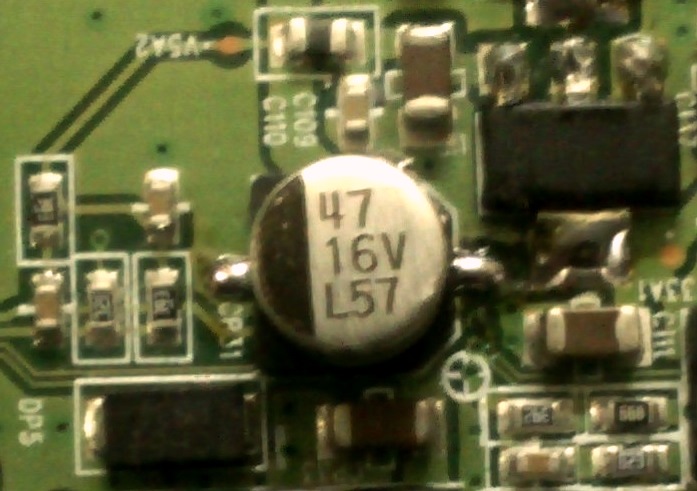

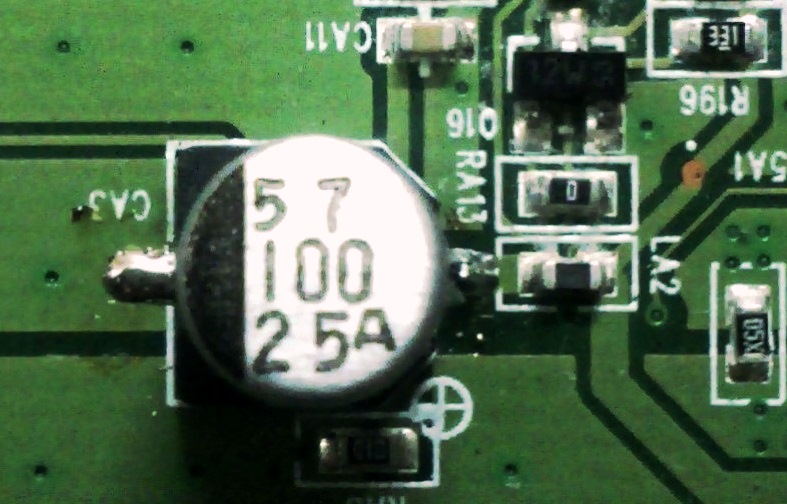

need help identifying tow capacitors
  • Laith
    • May 2013
    • 12
    • Jordan
    tow capacitors on an LCD main-board needs replacing and i need help identifying them... 1st one "47 16v L57" 2nd one "57 100 25A", i am confused the firs one is 16v but either 470mf or 47mf, the second i don't know .
    pictures included
    please help.. thanks
  • R_J
    • Jun 2012
    • 9624
    Re: need help identifying tow capacitors
    First one is 47Uf @16volts Second is 100uf @25volts
