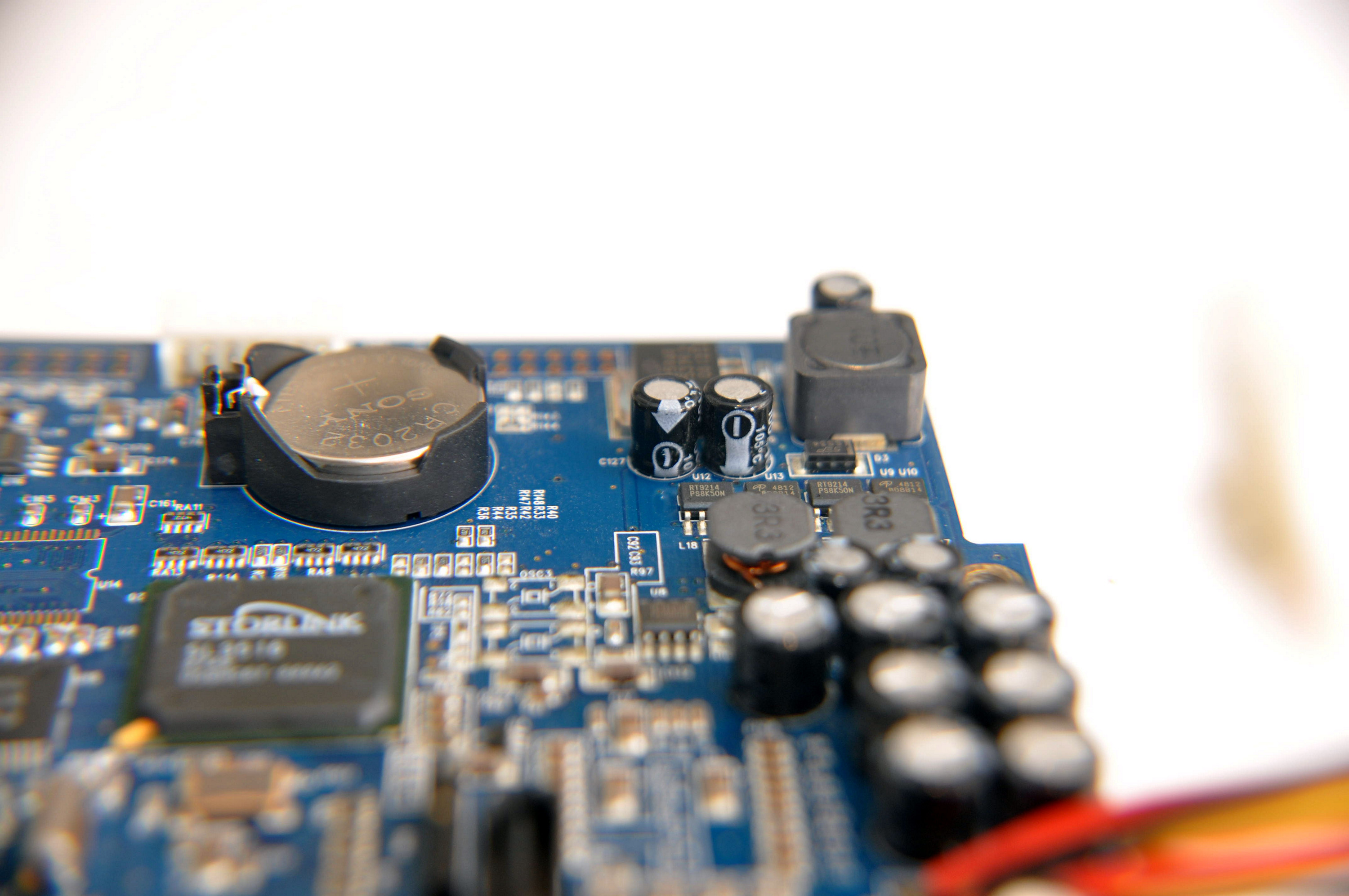

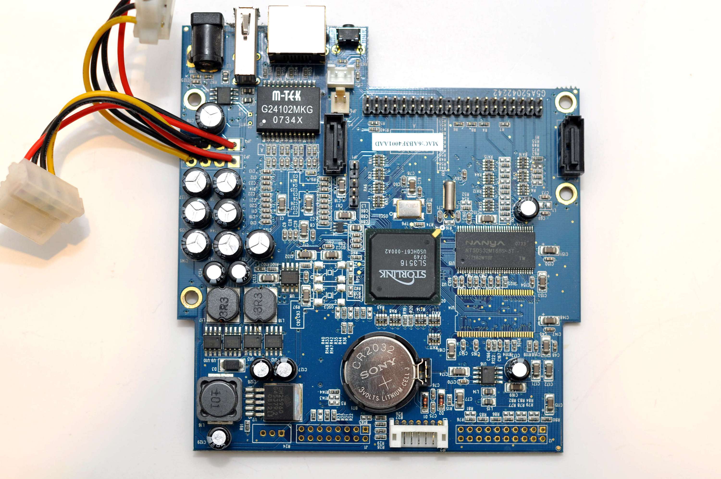

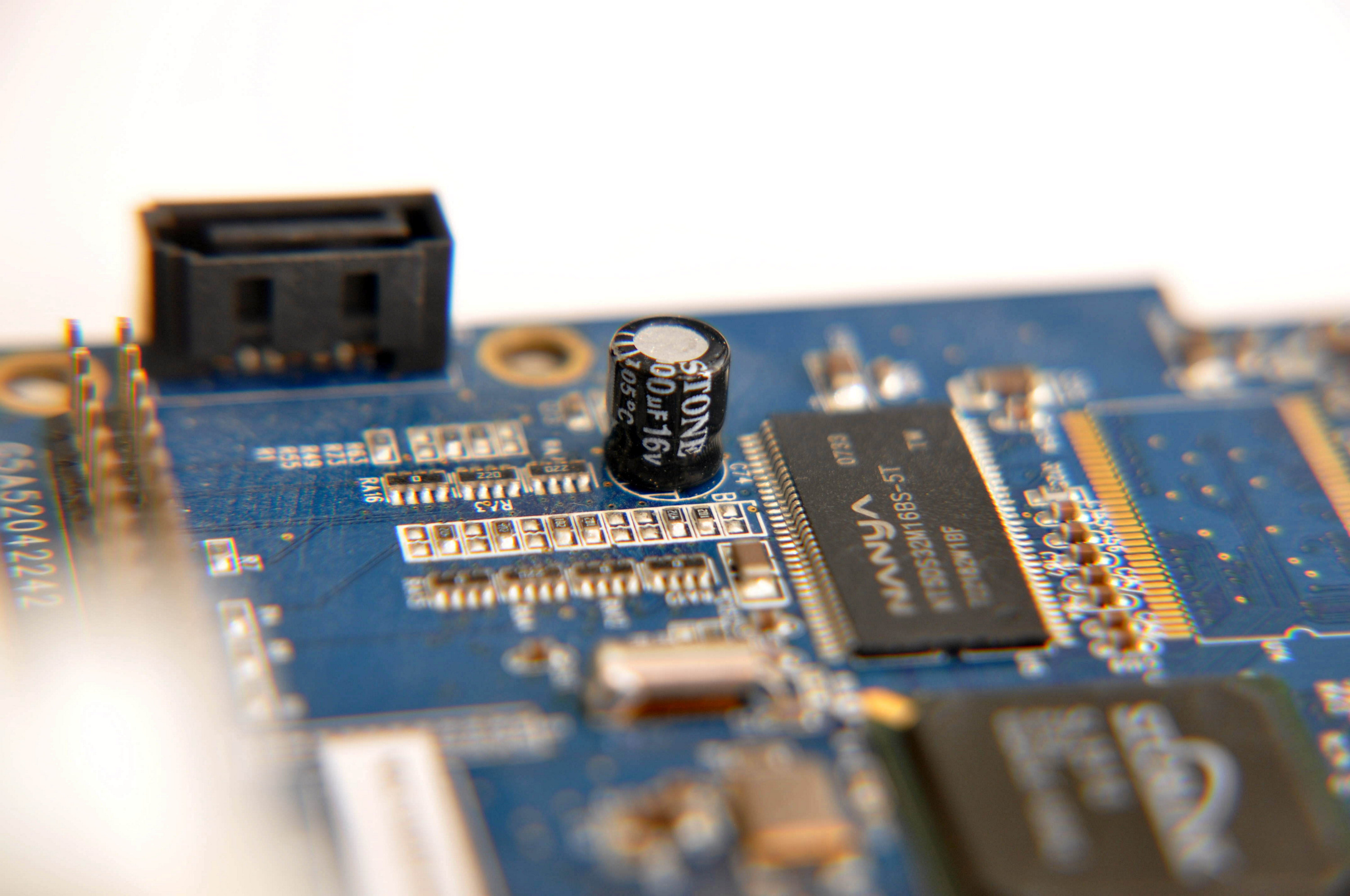

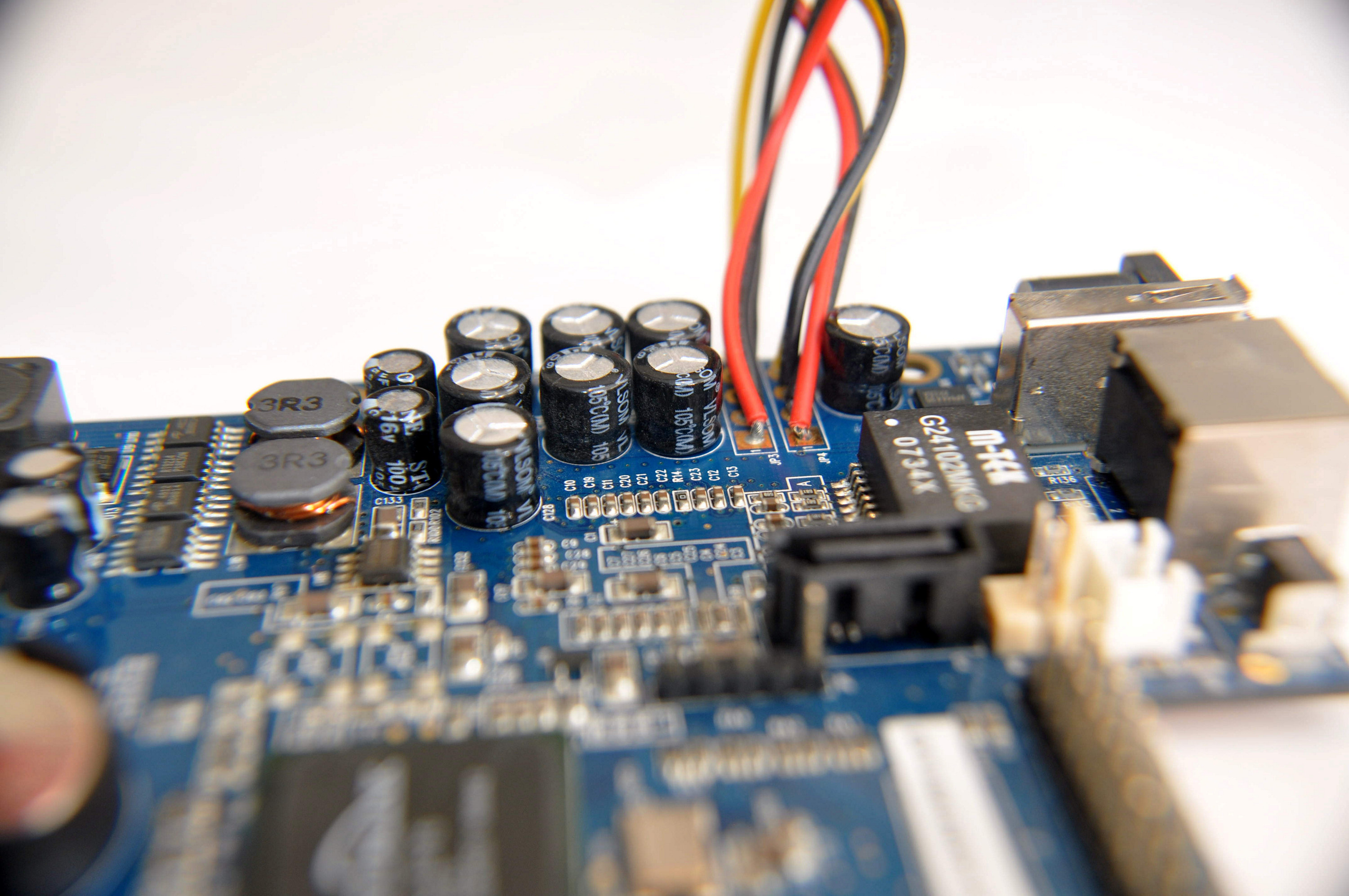

    Hi all needs some help please.
    I have a NAS drive which has stopped working. I've been told that the 3.3v rails can go on the board and to replace them, and been told to replace all other caps too as they are probably nearing their end of life.
    I have researched a fair amount but with so many different Brands/series for similar rated caps, I'm stumped.
    The original caps are : 330uF 16v 105oC VLSOM - (H)8MM W(8MM) X 8
    100uF 16v 105oC STONE - (8)8MM W(6MM) X 7
    From my viewpoint the height is most important for clearance of the HDD drives. The width can be accommodated.
    Thank you in advance. Btw - I have a another question posted regarding a motherboard if you could take a look please).

        Photo's would make it easier. I do hope these help somewhat.

            Great photos.
            Yeah, looks like the caps could be the issue as there appear to be two buck regulator circuits, and those don't function too well with bad caps. I don't see anything else potentially wrong.
            The VLSOM caps appear like typical cheap garbage, so probably best to replace them. Stone are known to fail all the time here (usually in Routers, Modems, and some cheap TVs).
            You didn't indicate what country you are from, so I will assume USA and post Digikey links. If you are from somewhere else, please say so, so that we can post links of suppliers relevant to your country.
            For the VLSOM 16V 330 uF caps, these could work:
            http://www.digikey.com/product-detai...616-ND/3528478
            And for the 16V 100 uF Stone caps:
            http://www.digikey.com/product-detai...302-ND/4204139
            The only reason I suggested polymer capacitors above is because they are a little bit smaller and easier to find (electrolytic caps are usually big, unless they are made as a custom order, such was probably the case with yours). Polymers caps are a bit more expensive though. I don't know how much the NAS drive enclosure is worth, so use your judgement and let me know. If it's cheap, I can look for some cheaper capacitors.

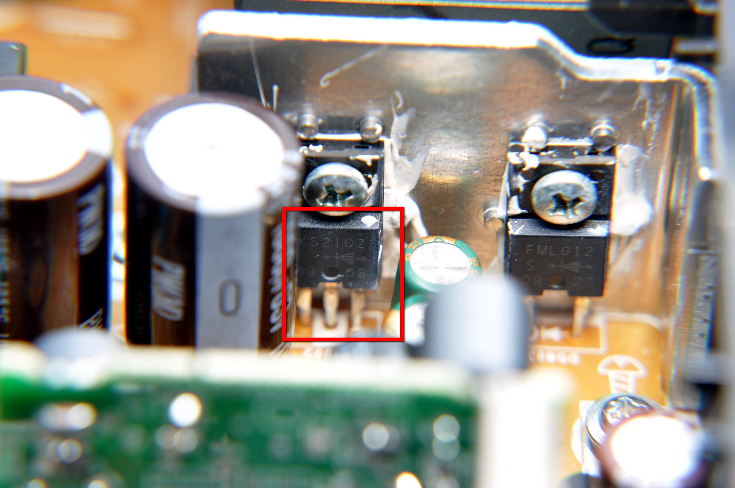

                        I have a component which I am uncertain of it's characteristics and I'm not sure whether the datasheet I have found is correct considering the different markings on the component itself.
                        It is a diode breed but what type, I am unsure of. I have uploaded a photo of the component and what I assume is it's datasheet. The actual part is in a Panasonic cinema system and the service manual lists it as a regulator diode and rectifier elsewhere in the same manual, and I'm confused as to what the datasheet says and it's use.
                        If it is indeed a dual diode then my meter readings, say one side to be .453 and the other to be .200. according to the research the .200 would mean its a fail? And to be fair, I don't understand the datasheet too much to substantiate that.
                              Can you post pictures from the top and bottom sides of the board? (actually, if you do that, I suggest you start a new thread with the device and model # in the title so that more people can find it and reply.)
                              I believe the datasheet you found is likely correct, but it doesn't specify whether it is a common-cathode dual rectifier or not. So that reading you got on the multimeter may or may not be right for that component.
                              All I can conclude is that if it is a dual-rectifier, then one side is likely bad.
                              Try measuring the resistance between the middle pin and two outer pins and see what you get. If you get a low resistance (200-300 Ohms or less), then that could be a bad or leaky rectifier.
