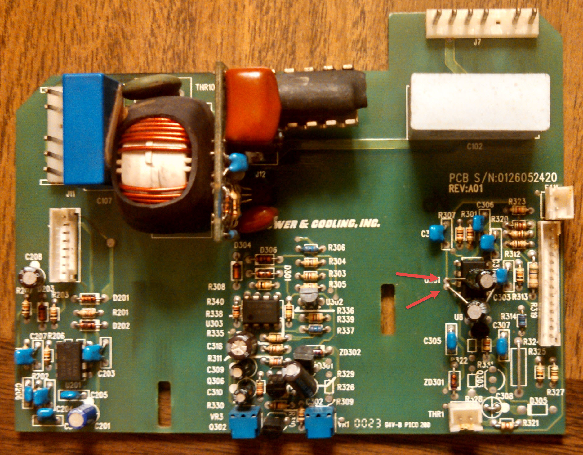

    I have a question, this is the daughter board on my PC Power & Cooling Turbo-Cool 450ATX Computer Power Supply where there are 2 x 50v 1uF capacitors that sits above a chip on the board which results in the leads being exposed. When I recap, do I need to trim the leads to the exact length since I read in another post here that the length of the cap's lead actually effects the electrical properties or does it really matter?

    Re: Replacing capacitors with leads
    The effect on the caps electrical specifications will be negligible. I wouldn't get to picky about the length.
      It only matters where ESR is critical, like PSU filtering caps, VRM, etc. For that application, it won't affect it
        Thanks everyone for the replies! I still wonder what the daughterboard is used for. C208 and C302 seems to have leads above the board too as the cap is sitting at a angle to prevent hitting something else like the primary cap and the transformer on the main PCB even though my replacement caps are 2mm shorter than the originals. I should probably try seating it all the way down and see if it hits anything, if it does, then just resolder it with a little more lead so it can sit in a angle before cutting the leads.
