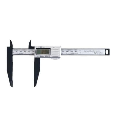

    For example, I need some way of measuring the bad caps so I can order replacements. This think is available at Home Depot for $30.00. Good buy?

    Dude, the capacitors are standard sizes most of the time. The most common sizes are 8mm, 10mm and 12.5 mm in diameter.
    The lead pitch is 3.5mm, 5mm, or some value in multiples of 0.1"
    You don't really need a such a tool to determine the diameter, a simple ruler with mm and cm gradations would be enough.
    In addition, you can just read the manufacturer and series from the capacitor and look up the dimensions in the datasheet. Now granted, sometimes there are custom batches or custom series of capacitors that don't match with the diameter and height listed in the datasheet, but then you can always fall back on the classic ruler.
    Now anyway, if you have some money laying around, they're a good tool to have around, for example to measure wire diameter, insulation diameter, thickness of some heatsink or some sheet of metal and so on. But fuck Homedepot, $30 is a lot of money for a tool that you can buy for a few dollars on eBay (and I guarantee it, it's just a rebranded chinese thing anyway).
    Here's a $17 one on Amazon.com : https://www.amazon.com/Neiko-01407A-...SIN=B000GSLKIW
    If you look around you can find noname ones for under $10... giving you the above because it's reviewed and rated well.
