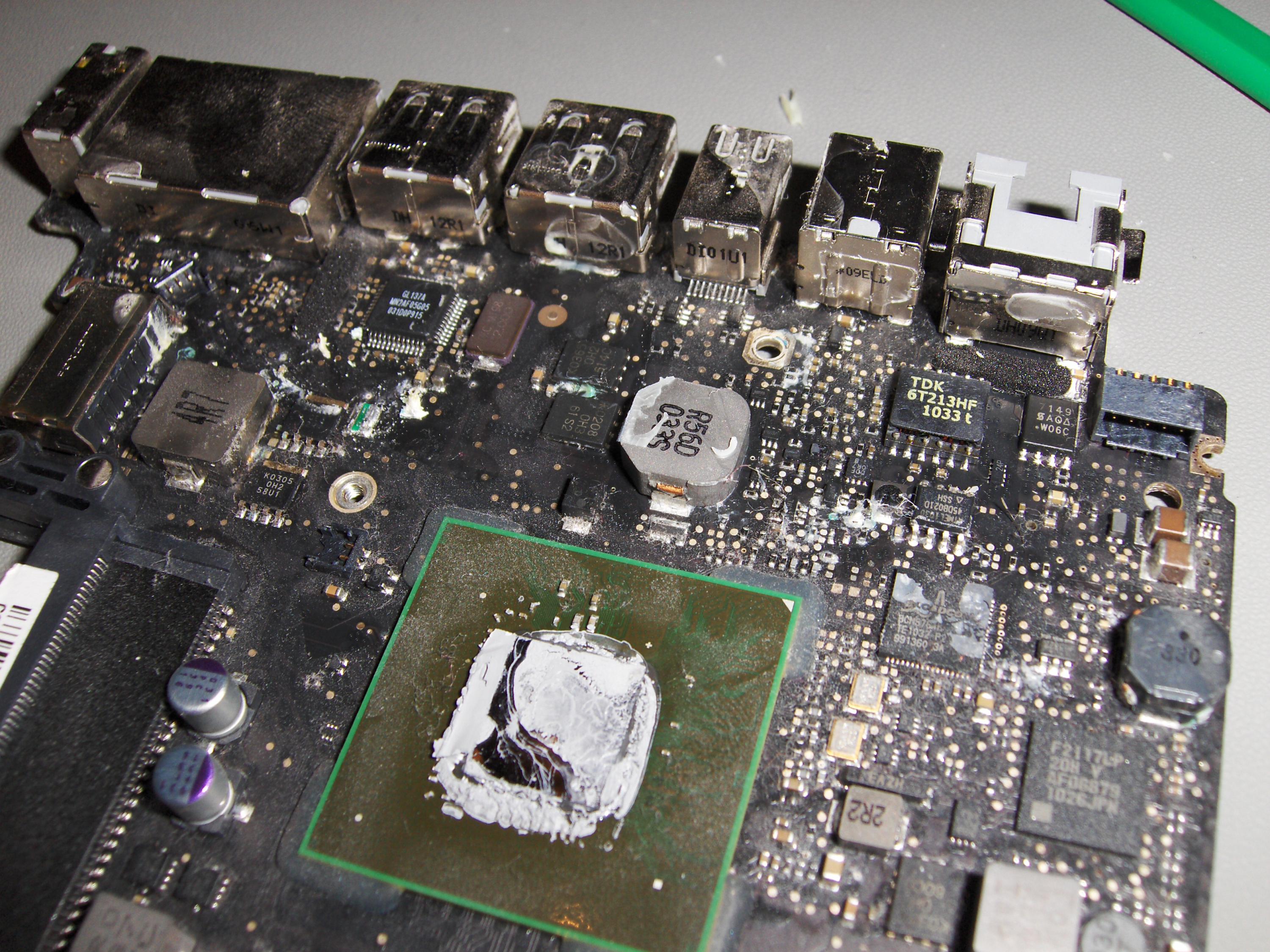

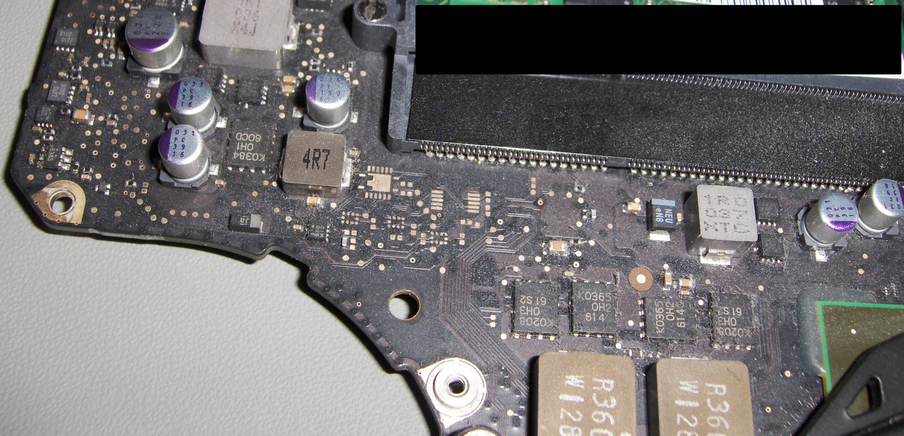

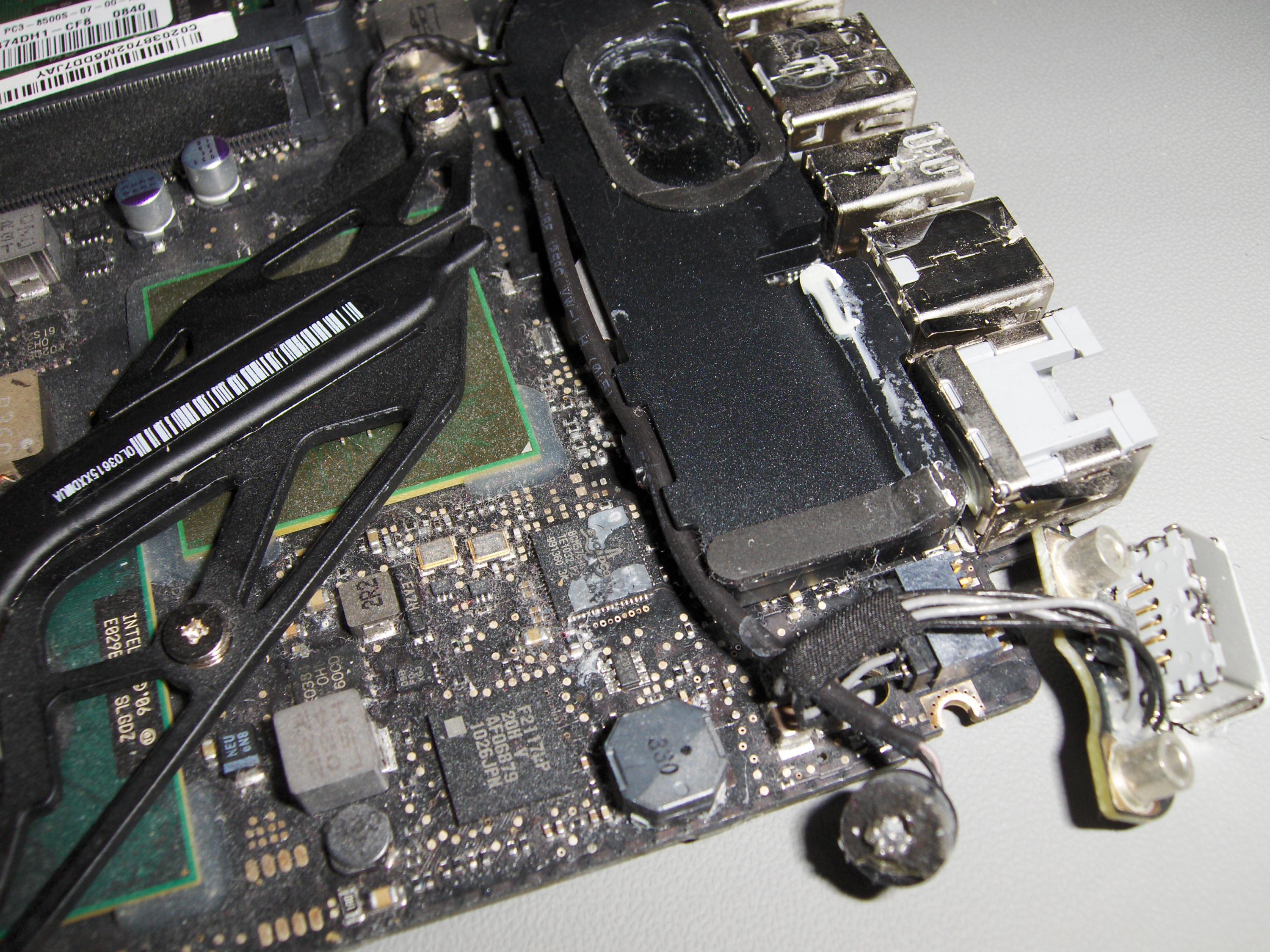

    I have a macbook pro that has some smd caps that looks like some kind of Sanyo Oscon, I'm not sure they will hold up submerged in water-looking at svp datasheet I don't see any warning for submerging them.
    I know some caps can't be submerged in liquid but will these ?
    There is dried milk all over the pcb and I though I would dip it in my sonic cleaner too see if it would clean it up.

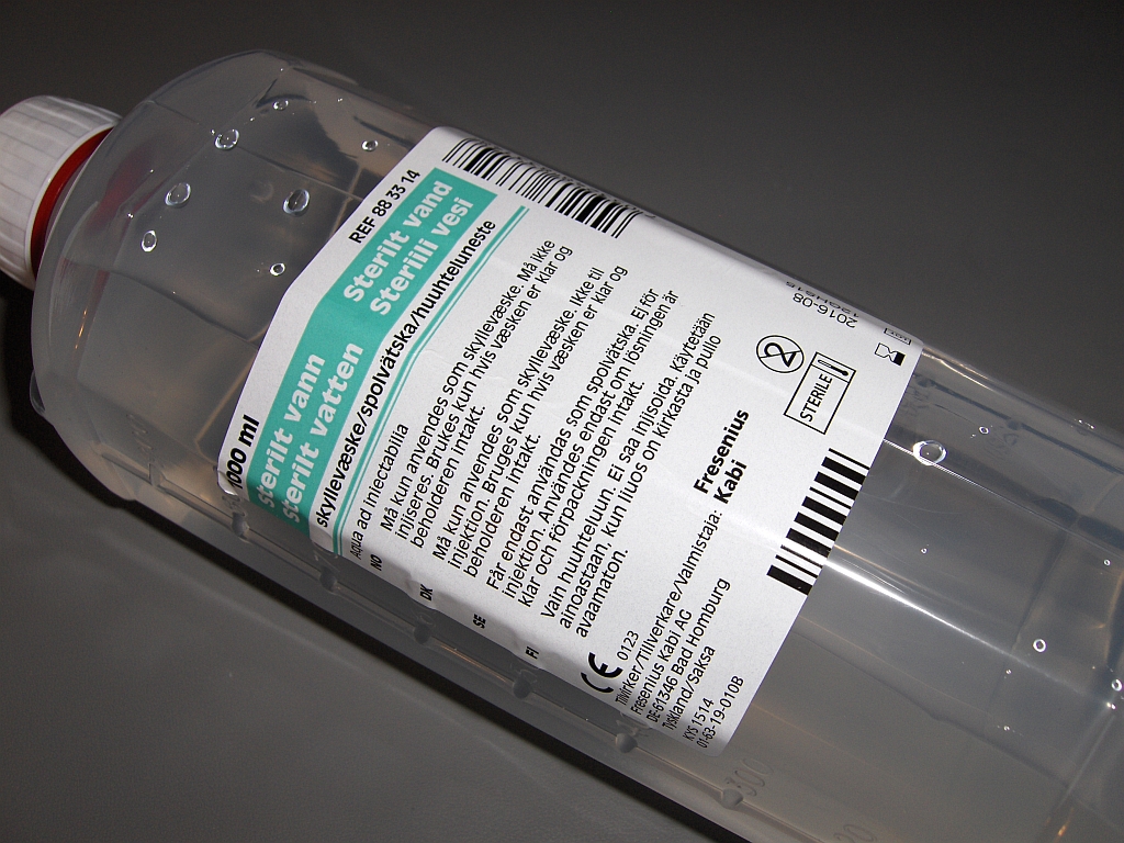

              I bought 1L of sterile water yesterday, thought I just would rinse it after the sonic job. Not submerging the board fully is also something I have thought of - I guess I will just hold the pcb by hand in the basket for a few minutes.

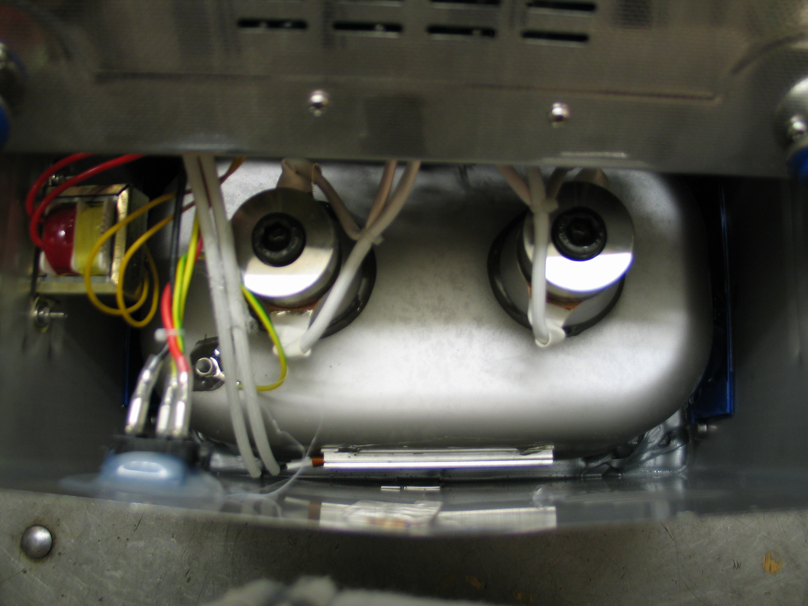

                  Too small heating element to do chips or sausages, it can barely heat up water sadly - think it stops at around 70 C.
                  You can see the element glued to the tank side.
