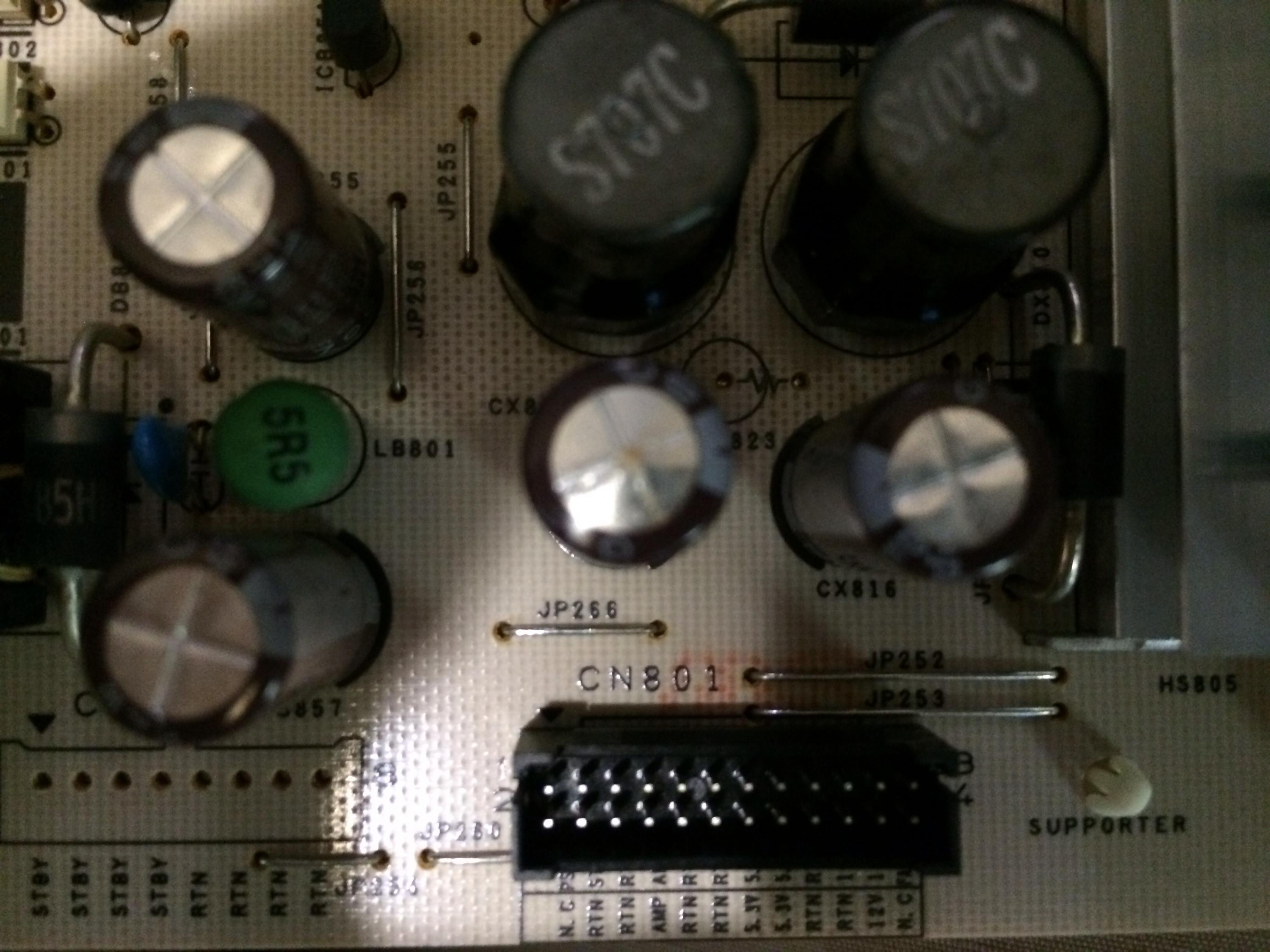

    Guys, I need to replace this. Where and what should I get? It's out of Samsung Plasma mainboard. It's a CapXom 1000uf 25v

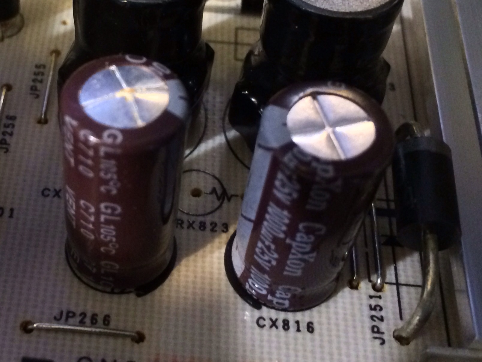

    Re: CapXon replacement
    Here's a better pic.

      what is the height of the cap? i would use the 2nd link if you have enough room that the cap won't stick up to high and hit anything. the other capxon caps i would replace those as well but that is completely up to you. always order atleast 1 extra just in case something goes wrong because shipping is gonna get you so your better off with an extra cap then having to pay for shipping twice since shipping is gonna be more than the extra cap or 2 that you purchase.

        They both far exceed the original ripple rating of the CapXon GL, so might as well get the FM (First link) They're shorter too. I highly recommend replacing all the CapXon as well, I've even seen 10uF 50V CapXon fail in monitors (Is that what your pictures are from?)

          I normally use FC when replacing CapXon GL, (specs are almost identical), but FM would work just fine too.

            Yeah, and Panasonic caps seem to be pretty expensive. If you're going to replace them all, you could buy nichicon PW, they're excellent caps at a better price

                Panasonic FC, Nichicon PW, and United Chemi-Con LXZ are basically interchangeable - impedance, ripple current ratings, case sizes, and quality.

                    They would do fine for a primary side cap, but they wouldn't be suitable on the secondary side of an SMPS, as they are not Low-ESR caps. one of the previously suggested series is a better option.

                        I've been using NCC KY, now I finally got KYA…1000 uF/25 V in D10x20 mm.
