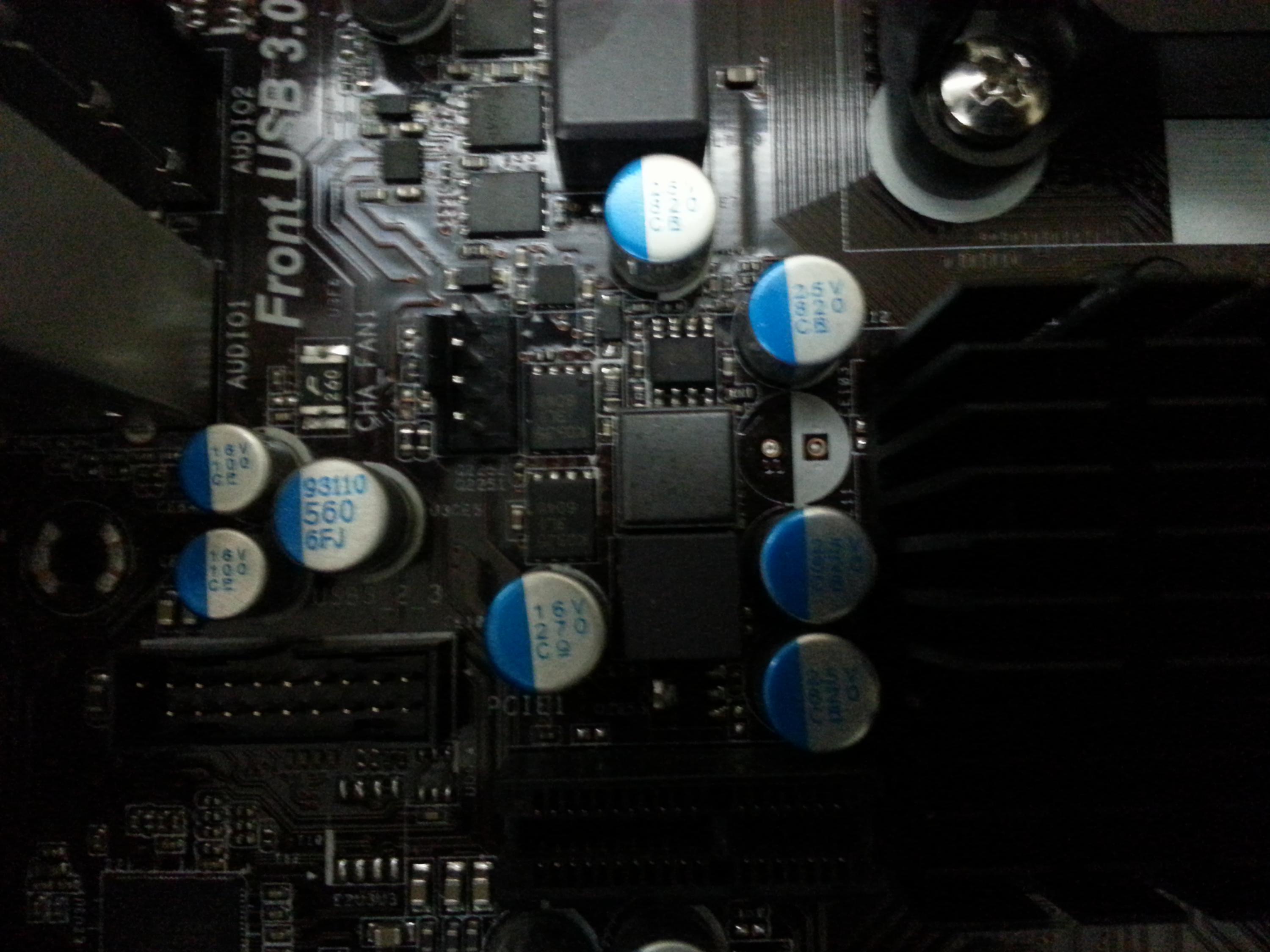

    I got a brand new ASRock 970 Pro3 R2.0 motherboard. After assembly, there were some strange symptoms:
    The board would not POST: no beep codes, no video. If I removed the video card, i got beeps. If i tapped F2 to enter BIOS, I would get into BIOS with video and all. If I discarded changes from there, I would get a very ordinary "Hard Disk Boot Failure".
    I managed to rule out everything except a possible short caused by one of the following:
    1. One of the rubber feet of the PSU was displaced.
    2. There was a screw wedged between the PSU and the case's motherboard tray.
    3. A motherboard pillar may have been contacting the board (most probable).
    Unfortunately, my diagnostic steps involved powering on the board ~10 times while it was being thus shorted which is probably what killed it- now i get no beeps or anything with nothing but the CPU and Power connected outside the case. Tested with a different CPU and PSU as well.
    Now since I'm abroad, the cost of RMA'ing the board is twice the cost of the board itself. So hell yes I'm all for trying to repair it if I can.
    A few questions:
    1. Do you guys think this particular case is futile?
    2. How would I narrow down which components need replacing (there's no visible damage/burns).
    3. If i were to guess, I'd replace everything clumped in the picture below which is in the region of the aforementioned motherboard pillar. What would you recommend for the 3x 820uf CB caps and the 93110 560 6FJ cap?

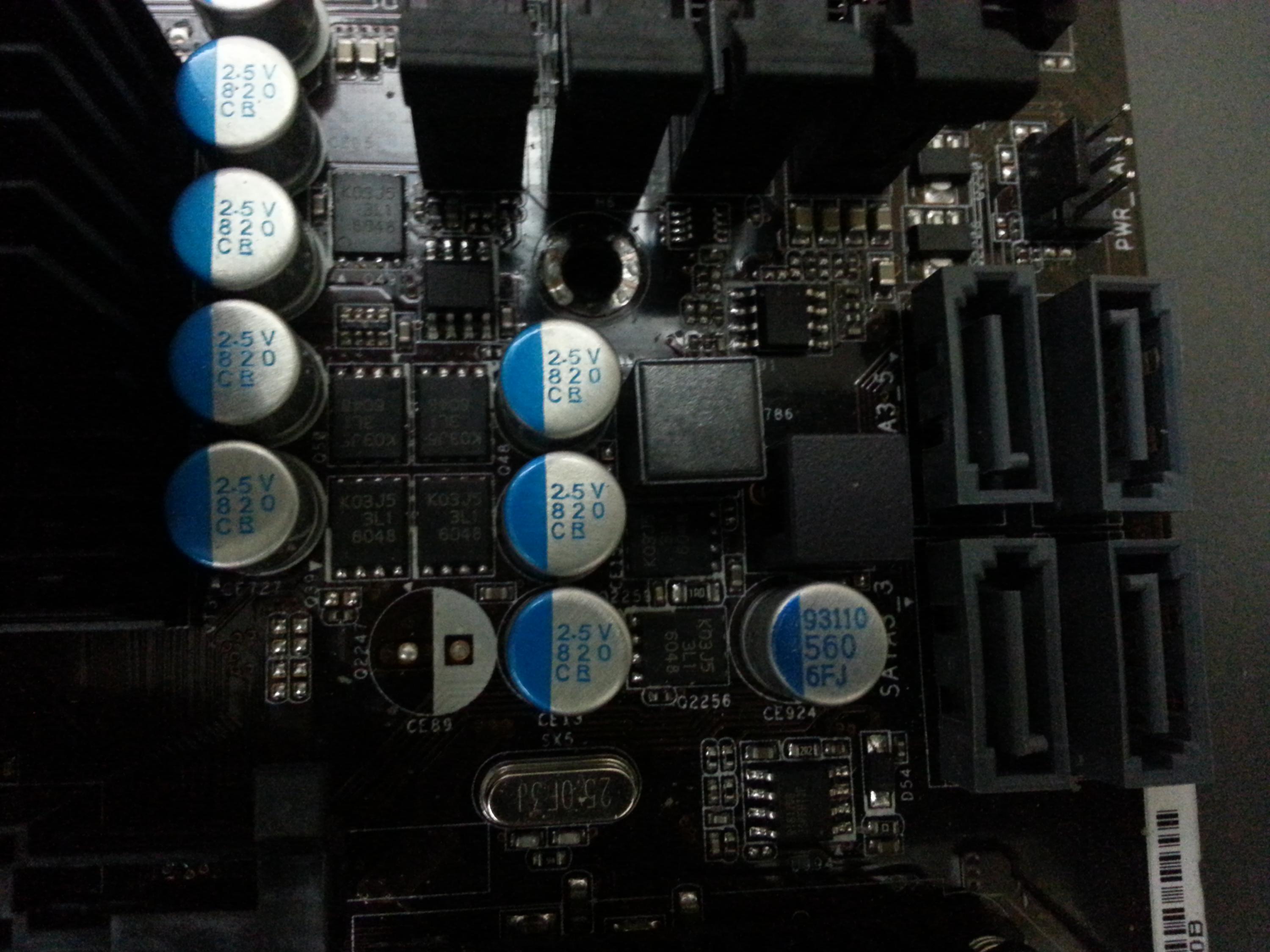

    4. What should I do with the unidentifiable rectangular caps(?) next to the sata ports?

    The large square items next to the SATA ports are going to be chokes\coils of some kind, not capacitors. Unfortunately replacing random capacitors and other parts is not at all likely to solve your problem if something did get shorted out. It would require a good level of knowledge to find the fault and good soldering skills and tools to fix it.

        It is unlikely you have a faulty capacitor in this situation, more likely is a burnt PCB trace or damaged semiconductor(s).
        I suggest you post your problem in the motherboard section of the forum and ask for help on trying to locate the damage.
        Trying to find a schematic of the board would also be a good idea if you want to proceed with troubleshooting at the component level.

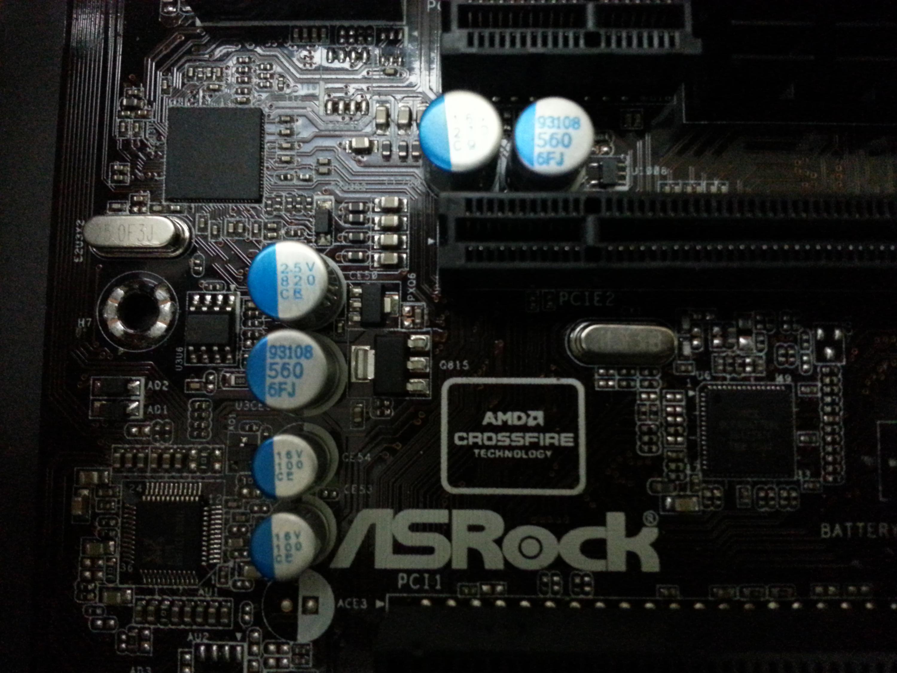

          several of the smaller caps on the board around the pci-ex slot are giving a 0 reading with the ohm function of my multimeter. does this suggest bad caps? tiny caps on a different board always seem to give me a reading. these ones are 100uf 16v (or 1.6v) caps.

              yes it is the same as shorting the probes. these particular caps appear to charge for a split second and then give out a constant zero and will not charge again.
              it is the bottom left cap in picture 1 (above the pci-ex slot) and the bottom 2 caps in picture 2 (below the pci-ex slot).
              it makes a little sense with the initial no video issue and the way the card sits uncomfortably on the pci-ex slot. I had to prop it up quite a bit to align it to the card holder screws.
