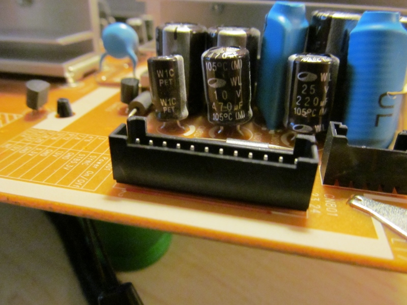

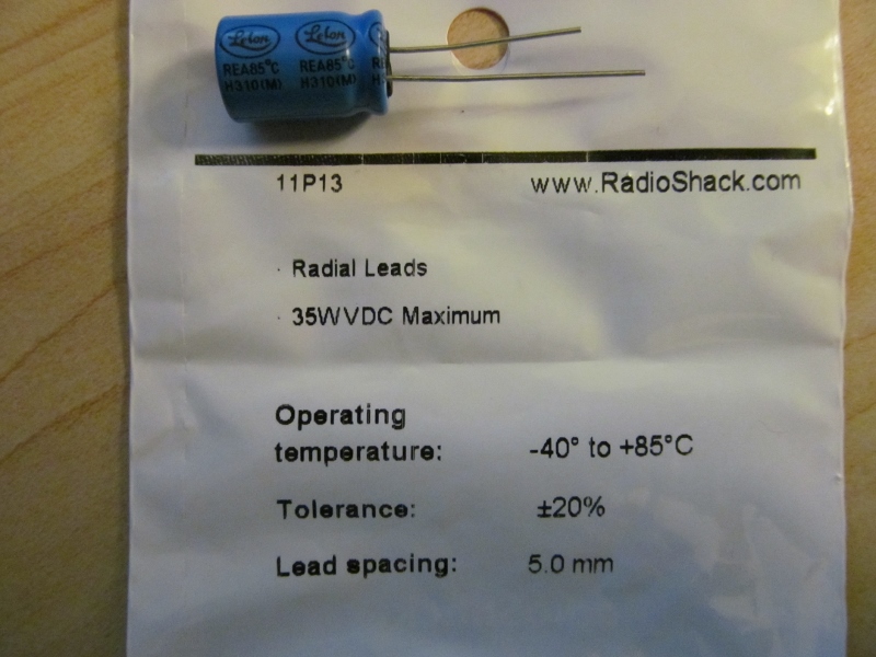

    I have an Samsung LCD TV that I need to replace a 470uf 10v 105 degree centigrade electrolytic capacitor on the power supply.
    I ran out to Radio Shack today since they were the only place open and the closest thing they had to what I needed was a 470uf 35v 85 degree centigrade electrolytic capacitor that is a little larger than the on there now but it looks like it would physically fit.
    My question is with the temperature rating being so much lower do you think it is a good idea to put it into my power supply?
    The 35v being higher is a little concern also but I was planning on going up to a 16v, not necessarily as high as 35v but I guess that is a good question to add in also.
    Any advice given would be gladly appreciated

    Voltage rating can always be higher but not lower. Although other parameters may change too at the same time.
    As for the temperature rating: If it runs in a higher temperature range it will probably last less longer than one for 105C.
    I would mainly look out for ripple current, voltage and ESR specs.
    I don't think there will be any problem using the one 85C. If you want to be sure you post both model numbers here and we can check their datasheets. Or better post pictures that show their number (not value or voltage rating) and manufacturer name or logo.

      Radioshack doesn't stock good quality capacitors generally.
      LCD TVs, monitors etc use switching power supplies, which need capacitors that have certain characteristics such as low esr and high current ripple, something that those 85c Radioshack capacitors don't have.
      The TV may work if you use that capacitor, but not for a long time.
      The voltage on a capacitor is the maximum voltage that the capacitor can handle. You can use capacitors with higher voltage than the voltage written on the faulty capacitors, provided the technical specifications are very close or exceed the specs of the old capacitor.
      I would not recommend using that capacitor because it's not suitable for switching power supplies and the back of your TV will be hot so it won't last a long time. As a temporary fix (a few days) it may be OK to solder in place.
      You can order good capacitors from this site ( https://www.badcaps.net/store/produc...roducts_id=119 or https://www.badcaps.net/store/produc...roducts_id=148 are good choices ) or you can get them from an authorized distributor of quality capacitors such as http://www.digikey.com or http://www.mouser.com ( I would recommend Panasonic FM or Panasonic FR from these two sites)

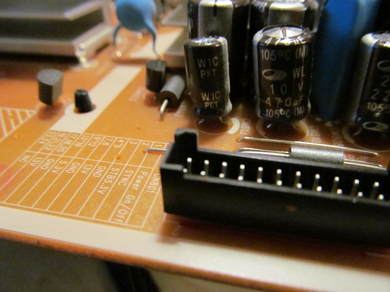

        Wow, Thanks great advice from both. I can see what you saying. I am attaching photos just for poops and giggles but I think that I agree that I should be looking for higher quality than the Radio Shack parts.
        I think, however, that I am going to go ahead and pop this one in just to see if it does indeed correct the issue that I was having with the TV while I am waiting on the new one to arrive and to possibly eliminate any additional issues I may have including needing to replace the entire power supply itself.
        They only go for $50.00-$60.00 these days and it doesn't seem like a whole lot to spend just to drop in a complete new one instead of continually trying to take apart the TV to trouble shoot the issue if just replacing this 1 CAP doesn't fix it.
        However if this is it and I can order a better quality one for a few bucks and do that just 1 more time then it was time well spent and I thank you both for your help.

                just wanted to thank you guys for your help. Ever since I put in the new CAP the TV is working just fine even though I did install the RS CAP.
                I did receive my new Panasonic CAPs the other day and am debating whether I should even bother to put them in now or wait to see if the RS one goes bad (will it even go bad or if it does will it do any damage?) or just see what go ahead and be proactive? My soldering skills are definitely not all that and I hate just taking things apart for the fear that I may wind up damaging something else unintentionally. The Panasonic CAPs are definitely rated better and have the higher ripple current rating and temp tolerance. Do you think it would make any kind of performance difference in the TV set at all. Nothing looks any different to me right now. Other than the set is working of course

                    That's good, it proves that the capacitor was the problem.
                    Yes you should install the high quality ones. The one you got from RS will not last very long here, since it is a general purpose capacitor. The other original ones are likely on their way out too. Proactive replacement of crap caps is a good idea. When bad caps die they can cause damage to other things too.
