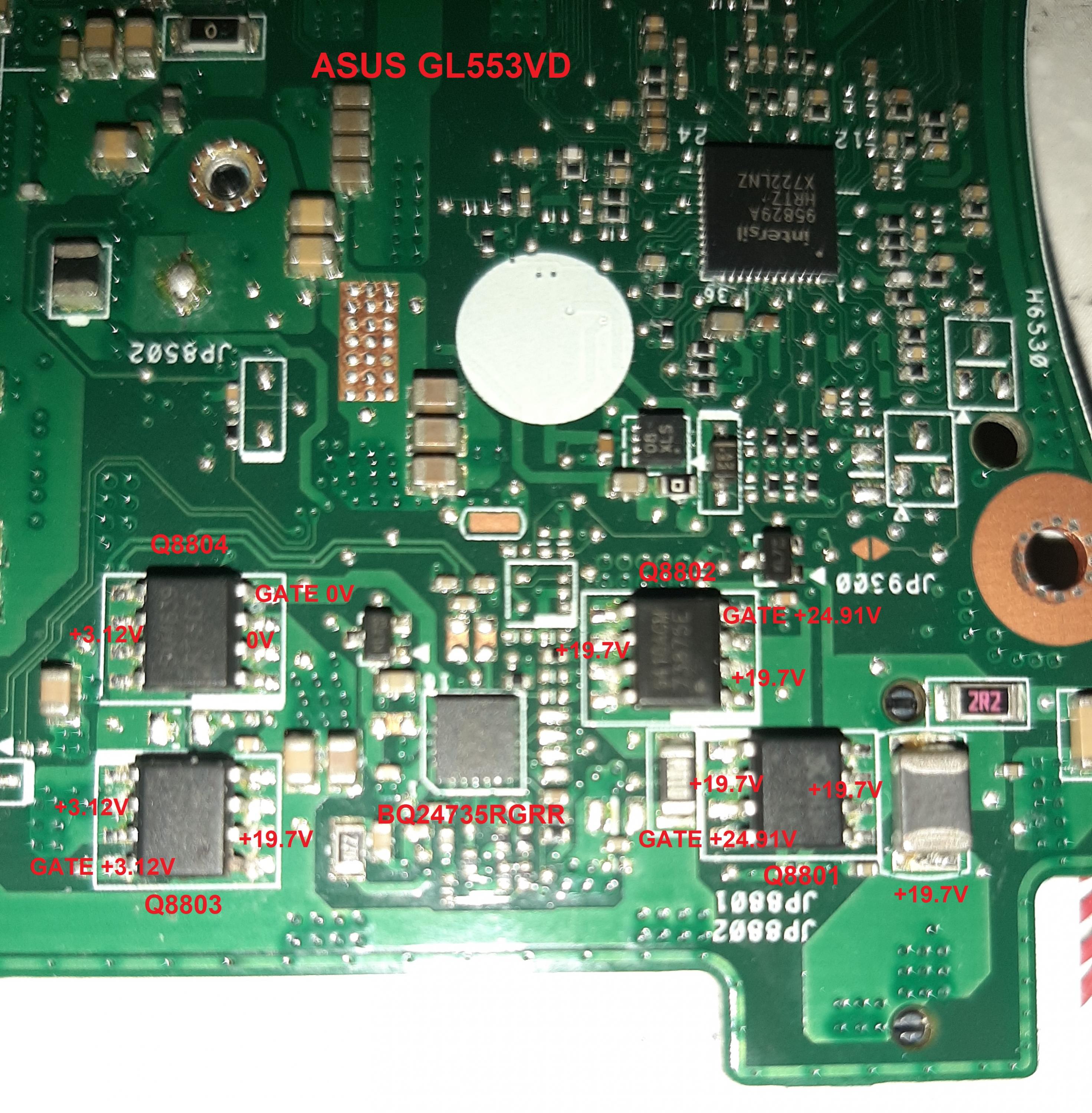

    Board Asus GL553VD
    Resistance values:
    Q8801
    GD 3.6M
    GS 11.7M
    SD 12.8M
    Q8802
    GD .5M
    GS 11.6M
    SD 36.7K
    Q8803
    GD OL
    GS 60K
    SD OL
    Q8804
    GD 6.2M
    GS 57.8K
    SD 4M
    I took a picture of my board and added some voltage values. Laptop does not turn on (of course !!)
    One last question, how to know when BQ24735RGRR goes bad and when to replace it ?
    Thank you !

    The last 3 mosfets look shorted with the low resistance. The values should be higher than the low kOhm readings.
    To confirm, remove the ~4k resistor on the ACDRV pin and check if the resistance readings change or not. One bad mosfet can throw off the readings for the others.

      Q8801/8802 are working as you do have 25V on gate(assuming they are N channel as pics are not clear).Measure voltage on ACN/ACP/ACDET/ACOK/REGN/VCC/ACDRV of charging IC.

        Q8803 is HIGH-SIDE
        Q8804 is LOW-SIDE
        The output of this charge pump goes through L8800, R8809 and then to the battery connector but it's only 1.618V,the charge pump is not working ??

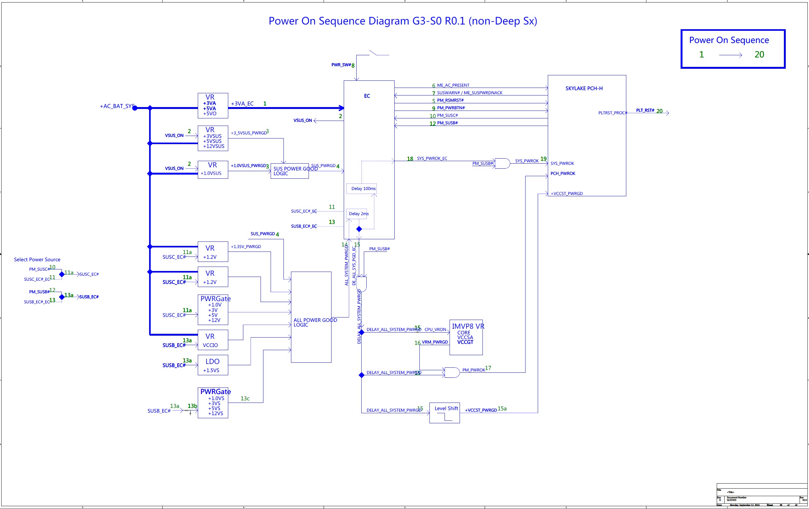

                    Try follow the power sequence and power good
                    • guizmo1967
                      • Sep 2022
                      • 75
                      Re: Asus GL553VD, need expert advice !!!
                      I found the power sequence for the GL553VD motherboard, I will try to follow that one ....
                      Thank you !

                          I extracted the power supply page from the schematic and added JP point for every voltages on that chart with the boardview file I had.
                          Every coils on that motherboard and every JP point that I added on that chart are not shorted to ground, they all have resistance, the lowest was 1.6 Ohm.
                          I would like to know how do you test mosfet in circuit ? Diode, continuity or resistance mode ??
                          Me, for n-channel mosfet, I touch S with red probe and D with black probe and should read about 0.5V, reverse the probe, OL. No continuity between S and G for a good mosfet, is this the right way to test a mosfet ??
                          They are many mosfets around those coils who don't have voltage that don't measure good. Is this possible so many mosfet failed at the same time ???
                          Everything before and including AOZ2261QI-18 has good voltage but everything after that, 0V everywhere but nothing is shorted ????
