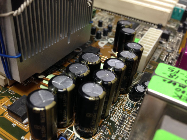

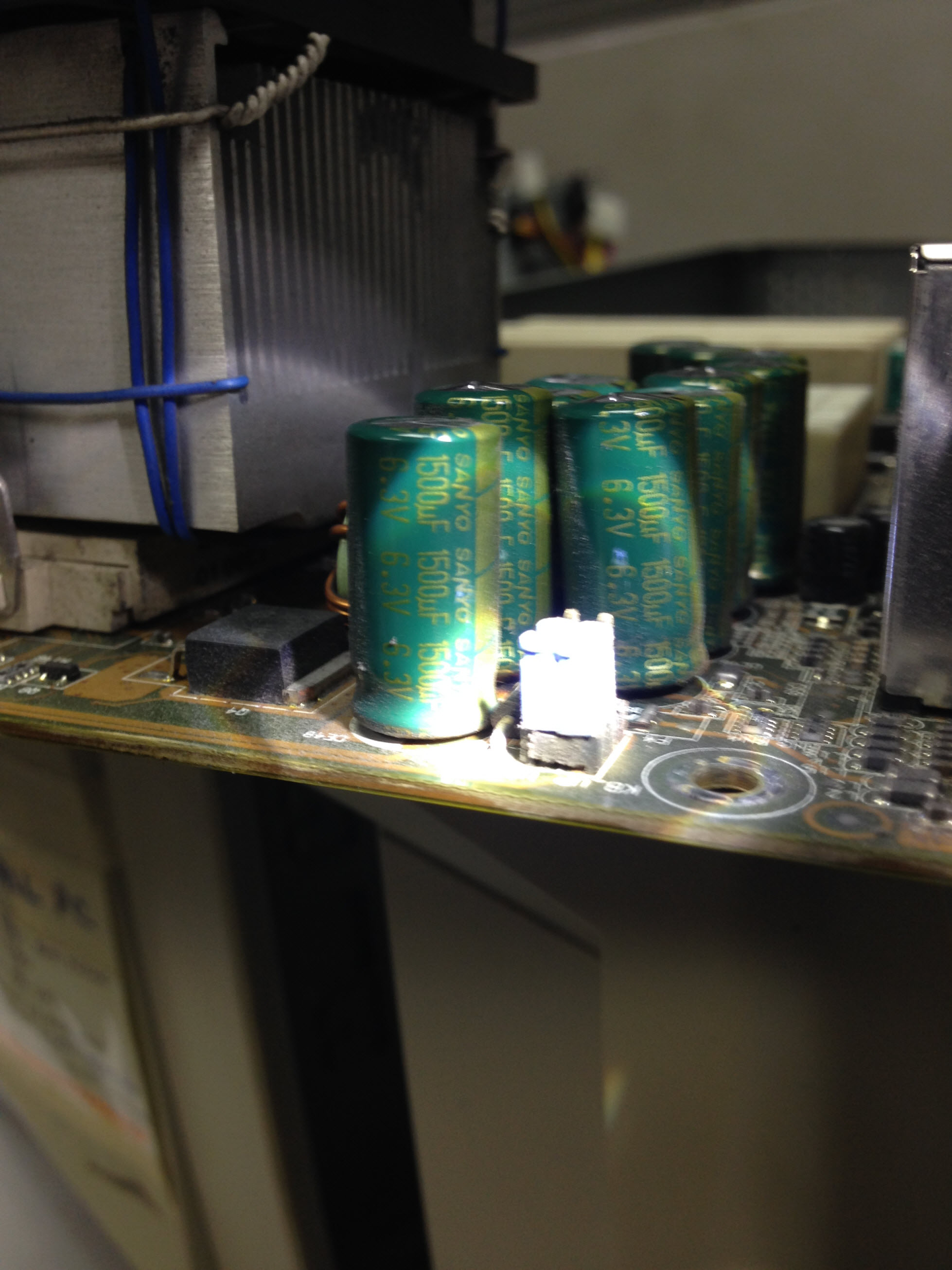

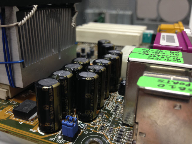

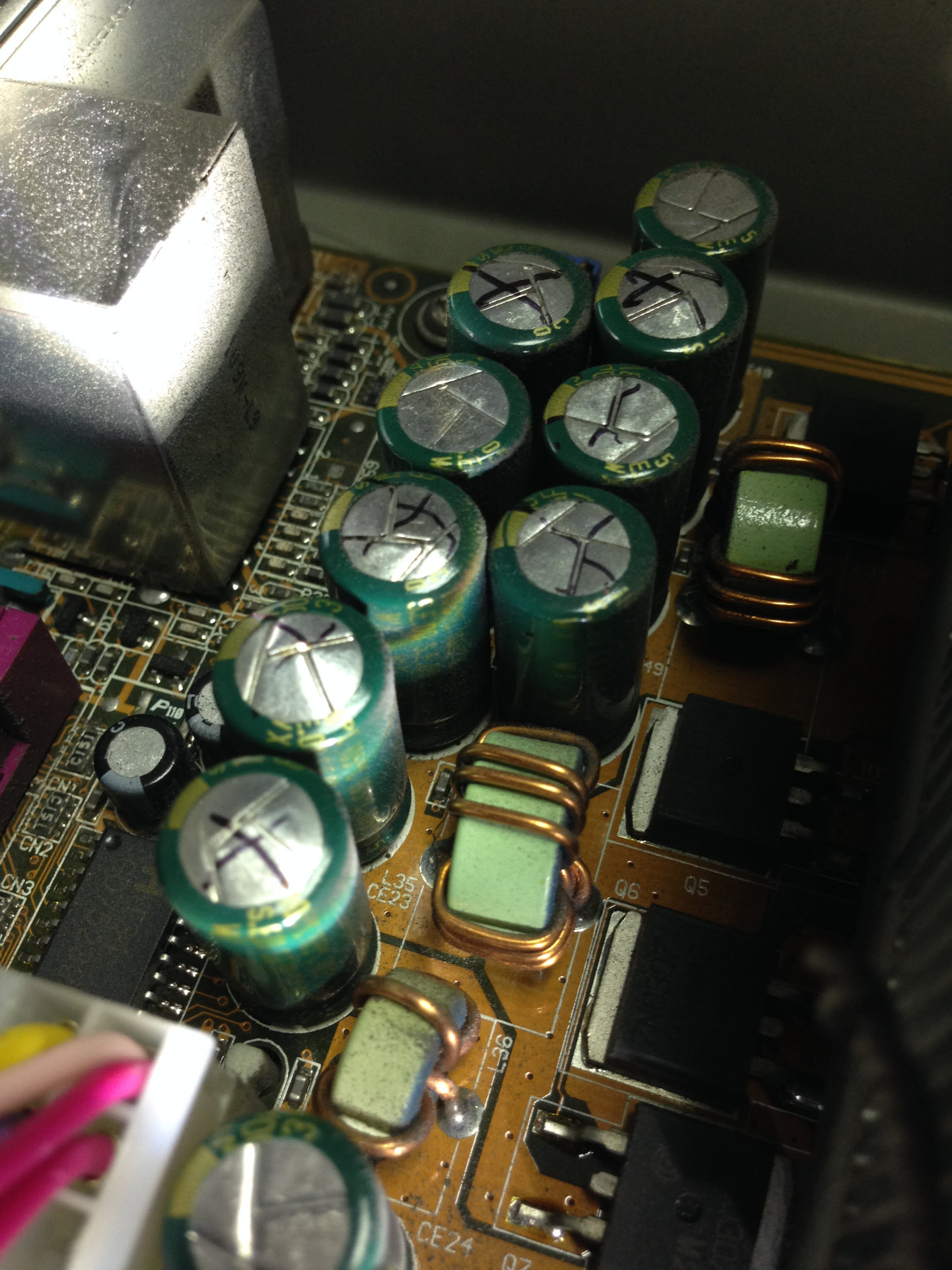

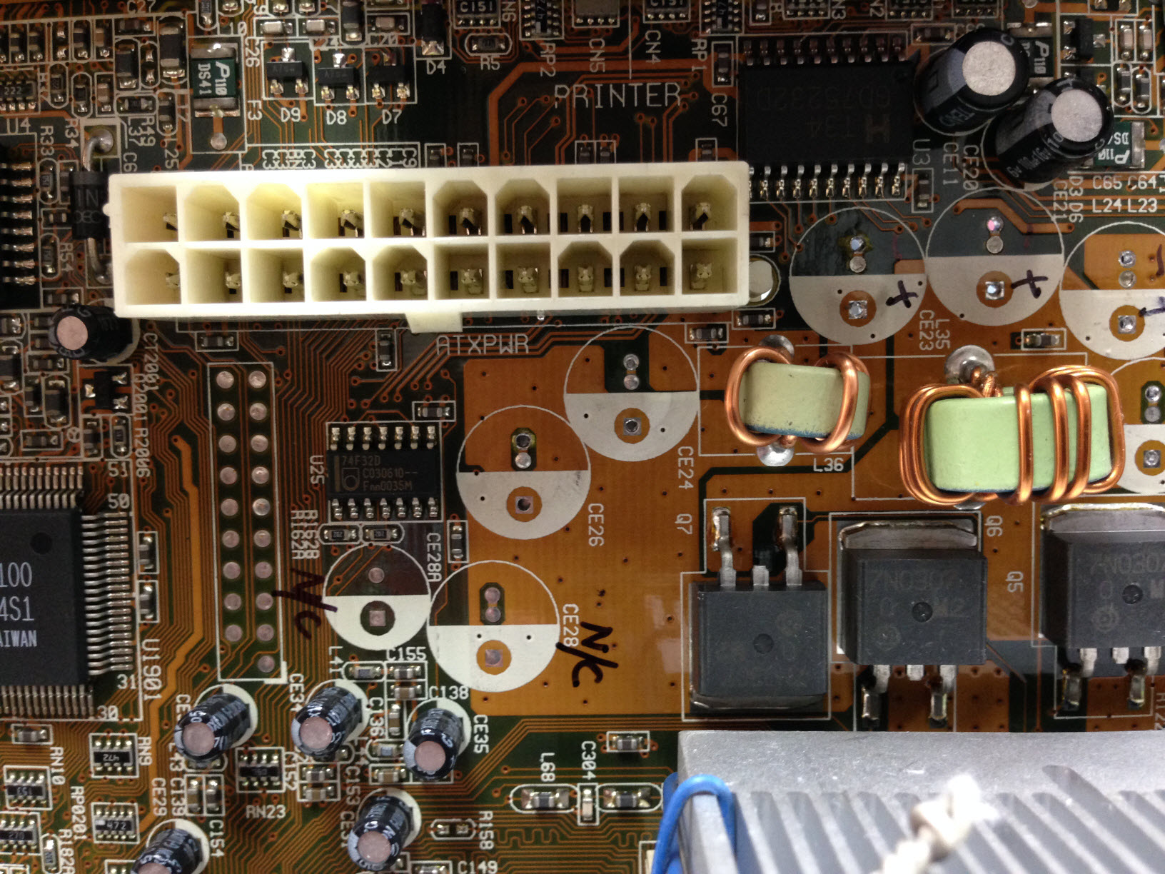

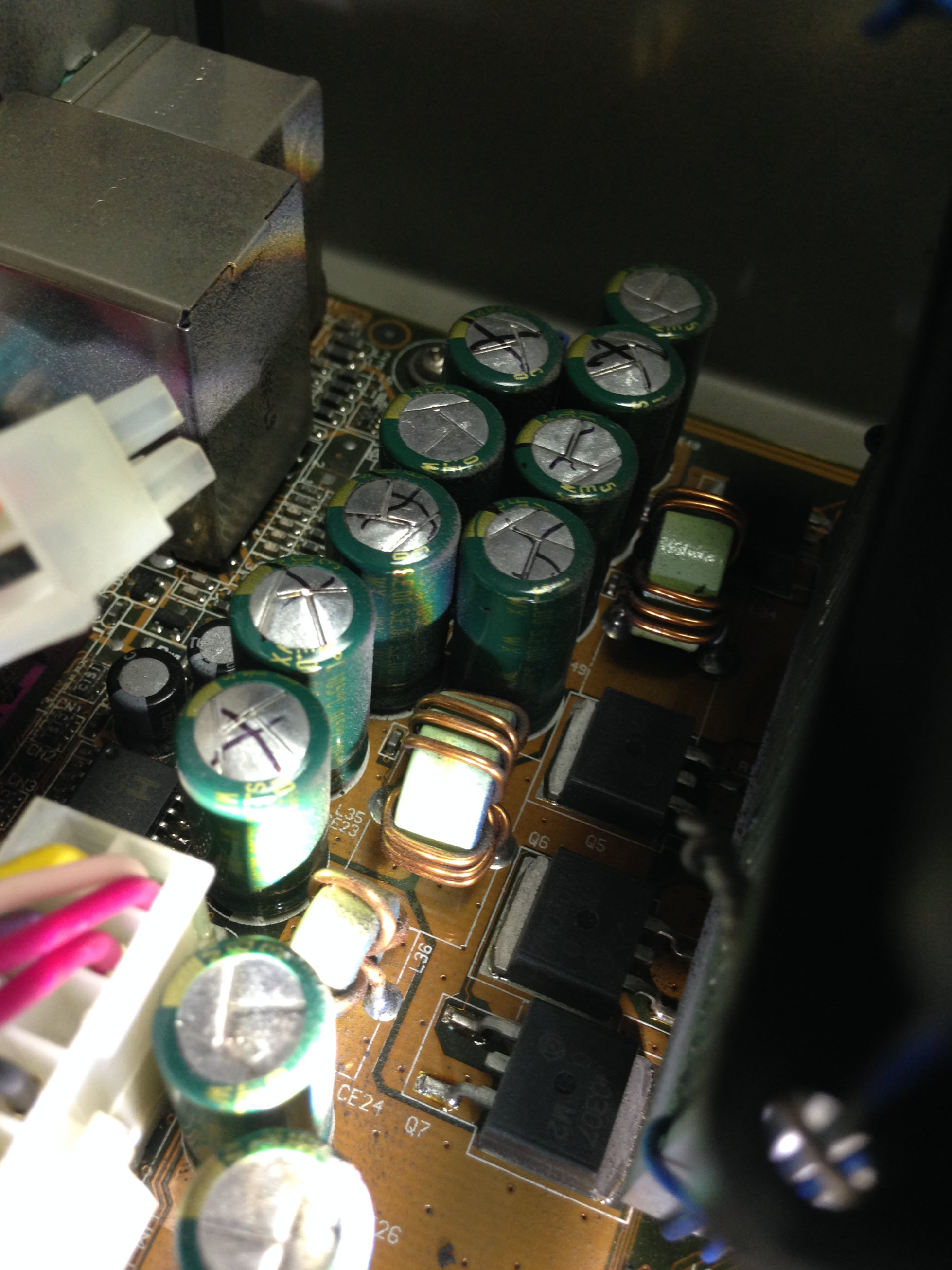

    Hi All,
    It is about time, I attempt to replace 11 units of Sanyo capacitors.
    There are 1500uf, 6.3V, diameter = 10mm.
    As usual, I am bit confused about which Sanyo capacitors to use.
    Besides that, Sanyo don't make capacitors any more, information on
    replacement ones are hard to find.
    I have found some Low Profile version from this eBay seller from UK.
    Check out this link:http://www.ebay.com.my/itm/SANYO-Low...item4ad04791a7
    Are these Low Profile Sanyo capacitors any good???
    Would they able to stand the heat? (since I am living in the
    tropical country)
    Please see the attached picture of some bulging Sanyo capacitors.
    Your advice is most appreciated.
    Thank you.

    Don't buy caps on eBay, 90% of them are fakes, including the ones you've linked.
    Badcaps.net sells capacitors, here is one example:
    https://www.badcaps.net/store/produc...roducts_id=147
    But do post what series of Sanyo caps yours are, it's written on the opposite side of the cap from where you have taken the pictures... (The linked capacitor above might be too low ESR, it's usually not a problem for a CPU VRM though)
    Also take a look at your power supply, it might have bad caps too because Sanyo failures are extremely rare...

        There is no reason to pick old Sanyo capacitors. Don't get Sanyos and especially not those low profile capacitors. Particularly you should choose a major brand new stock designed for very low ESR.
        You did not mention specifically what price range your other alternatives are, nor what is considered "very costly". I don't know what hardware is worth there, but due to the very old age and that it is not proprietary but rather a plain consumer grade ATX motherboard, that motherboard is probably worth less than the cost of good capacitors to fix it.

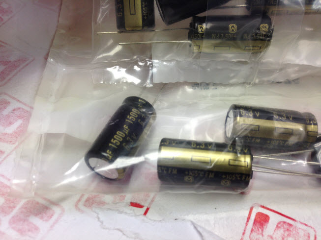

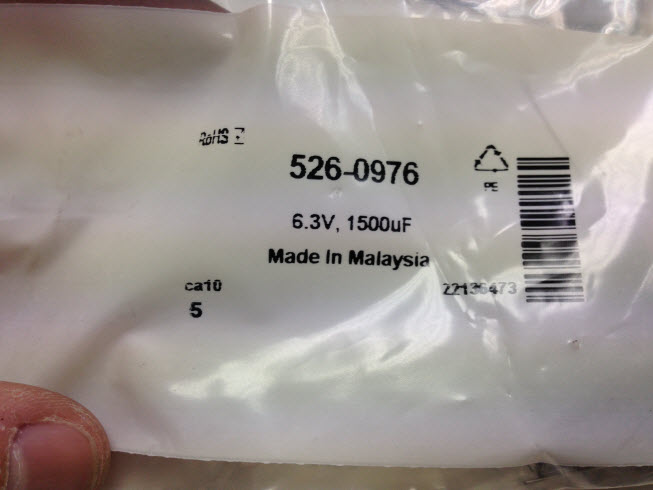

        Here is what I recommend for all the failed ones that are 6.3V, 1500uF Panasonic FM series. They also make other voltages if needed.
        http://malaysia.rs-online.com/web/p/...itors/5260976/

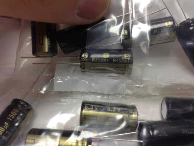

          At the moment, I most likely going to buy the Panasonic,
          since it cheaper than the Low Profile Sanyo capacitors
          found at this link: http://www.ebay.com.my/itm/SANYO-Low...item4ad04791a7
          Reason being....
          (1) Most likely capacitors are fake/imitation when buying from eBay.
          (2) The cost of getting Panasonic capacitor is cheaper than the Sanyo ones at eBay.

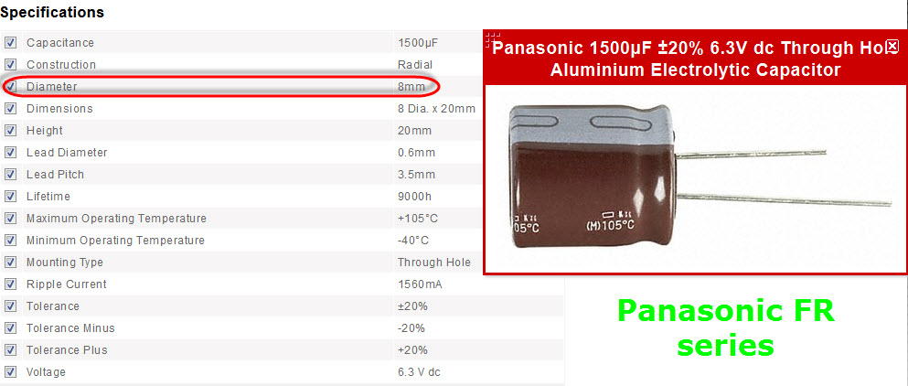

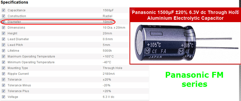

          Currently, there are 2 options available:
          Panasonic FM series: http://docs-asia.electrocomponents.c...6b805f3abe.pdf
          Note: Endurance : 2000 to 7000 hours at +105°C
          Panasonic FR series: http://docs-asia.electrocomponents.c...6b80e4e9bf.pdf
          Note: Endurance: 5000 h to 10000 h at +105 °C
          I am considering on buying the FR series due to its higher endurance factor,
          and not to mention higher cost than the FM series. It will be good to have it
          since the motherboard is working at 24/7operation. Any advice?

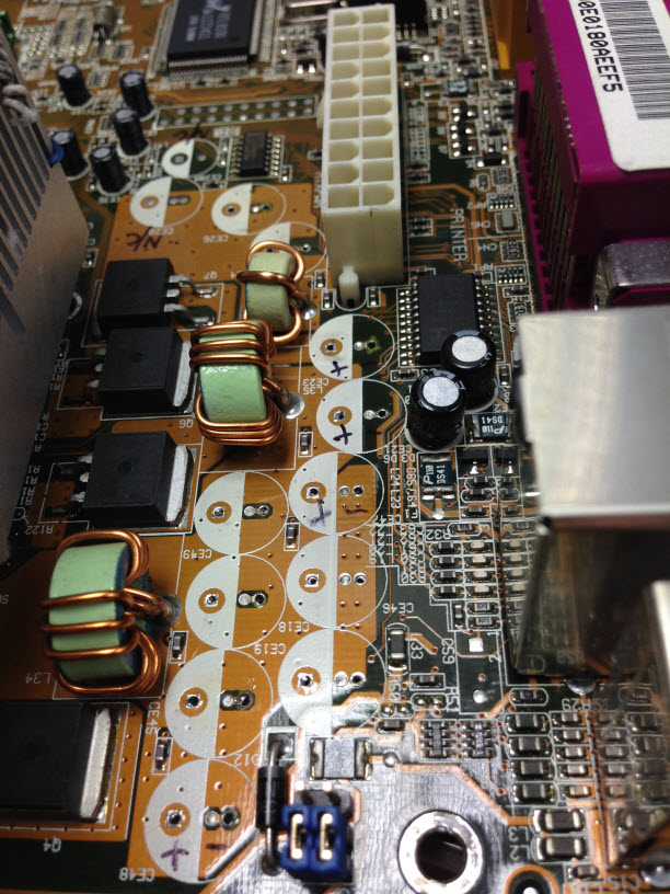

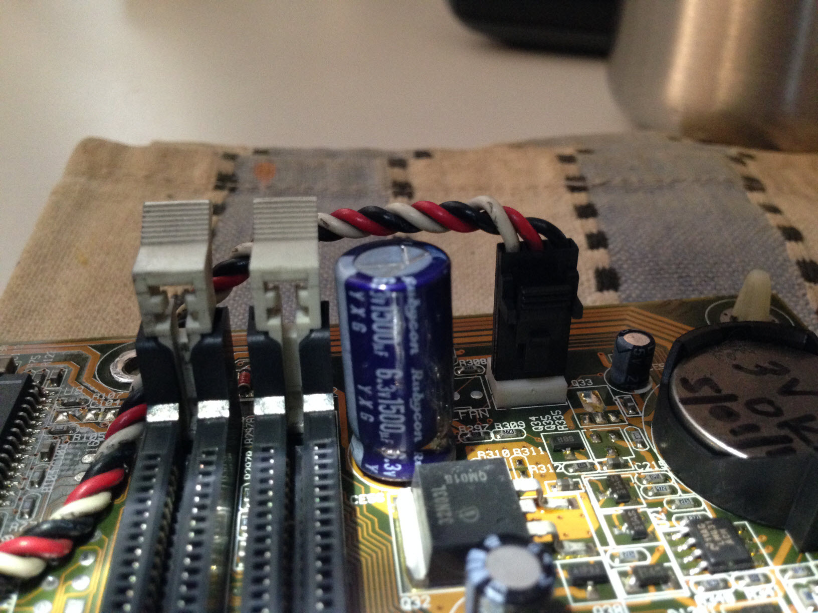

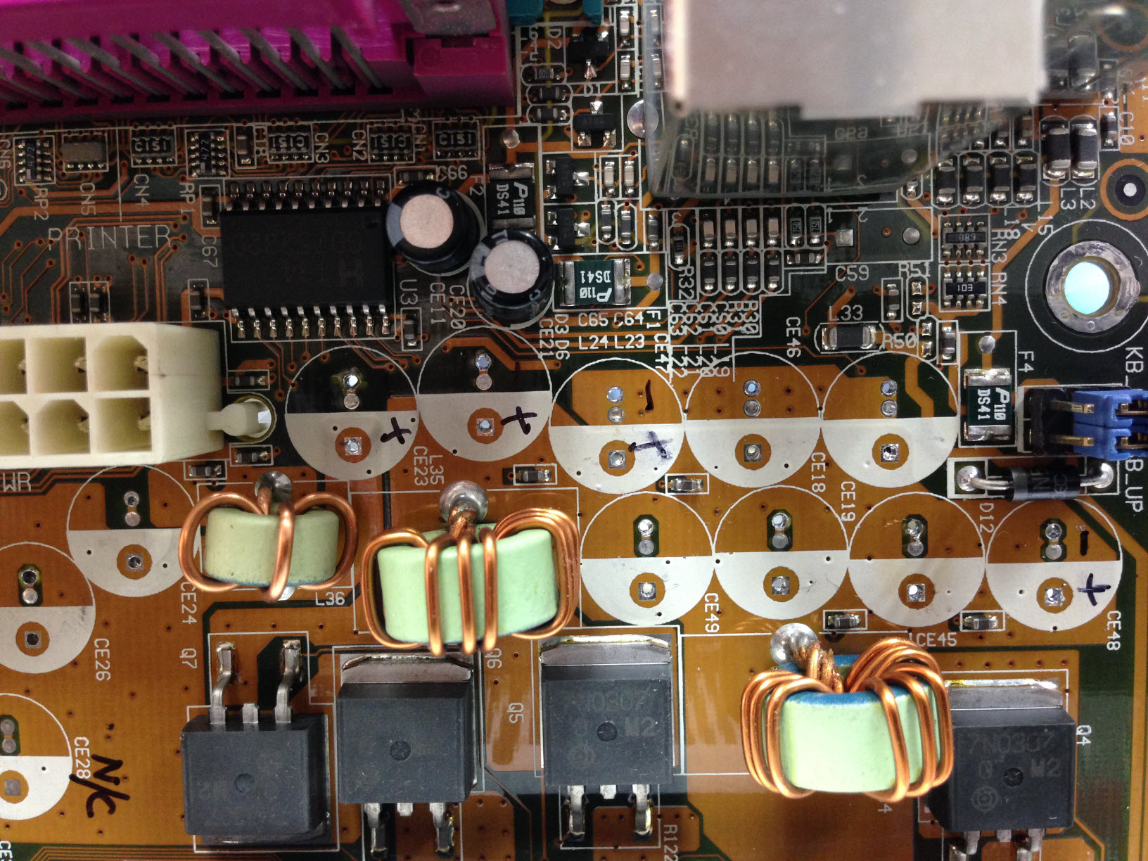

            Hrrrr.....the Panasonic FR series capacitor has got a smaller diameter = 8mm, does not
            fit well for replacing a capacitor with 10mm. I think position of the lead hole will not
            be the same, right?
            Please see the attached pics.

              Yes, if you want longer service life then consider the FR caps, but the motherboard is so old already that I didn't think it was worth the extra money. Do not drop down in diameter, use 10mm caps, the largest diameter that will fit.

                Ok, I will get the FM series. Thanks for the advice!!!

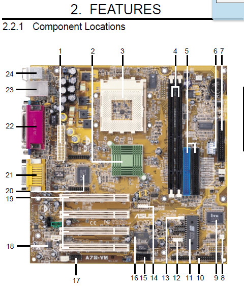

                  Be sure to replace all of them pictured, not just the ones that bulged. Actually if there are some similar near the chipset, memory or southbridge, those would be good to replace too as they may also be near end of life, but I think mainly it was the heat that killed the Sanyos.
                  In that generation of Athlon platform, motherboards often did not support HALT idle correctly (or it was disabled) so they used a lot of power and produced a lot of heat even when they weren't under much of a load.
                  An additional measure that might help reduce heat is to mount a 2nd fan over that row of capacitors. Something looks a little strange about the way you have the CPU heatsink fan installed in the picture, but otherwise the 2nd fan could be screwed to the mounting holes on the existing fan so you wouldn't need to figure out an alternative mounting bracket for it.

                        Hi 999999999,
                        Thank you for sharing.
                        I made an error in my opening title, the motherbaord should be A7S-VM motherboard and
                        not A7V-SM. The motherboard is using SIS chipset.
                        According to your link given, the HALT feature is not applicable to SIS
                        chipset. Besides that, I am using Linux OS not Windows, so it won't apply to
                        my case. Please see the pic. attached.
                        Thank you.

                            Phew..... after spending much time and a help from a clamp vice,
                            eventually those 11 pcs of Sanyo caps were out for good.
                            Having a few weeks of non-stop work and baby sitting my daughter,
                            I finally have some free time to continue this recapping work on my
                            ASUS A7S-VM motherboard ( YES, I made a blunder, it is actually an
                            A7S-VM and not A7V-SM, I made an error on my title for my post)
                            Now, I can proceed and order the replacement Panasonic capacitors from
                            RS at my country.
                            I must admit getting out the caps requires a bit of technique / skill,
                            for sucking up the solder.
                            Tip: never do desoldering on a motherboard that is lying upside down
                            flat on the table, if you DO NOT have a proper, expensive desoldering
                            vacuum gun, because from experience, some solder will flow back into
                            to the tiny hole, then getting out the solder will be difficult, and you are
                            likely to ruin the soldering pad. As for me, I used a cheap desoldering build-in
                            with a manual suction vacuum pump. I clamped the motherboard with
                            some anti-static form using a vice, lock in an upright postition.
                            I did my desoldering at 90 degrees angle, so when the solder heated up,
                            flowing back to the hole will not be minimized and hence it would not block
                            the tiny hole.
                            I have attached some pictures for your viewing.
                            Question is do I need to replace 1 unit of Rubycon XYG 6.3v 1500uF cap,
                            located at the RAM slot (see the right most pic attached)??? It does looks
                            fine to me. I have missed out this cap.

                              ^ I doubt that you need to replace the Rubycon cap in question, although it would of course be a more complete recap if you did.
                              In a pinch you can keep the holes you desoldered open by inserting a dental pick while the solder is molten, and moving it around slightly as the solder hardens so the tool is not soldered to the board.

                                    Re: Sanyo Capacitors Replacement job on Asus A7V-SM motherboard
                                    Today afternoon, I received the package from RS component,
                                    In the package, I received 20 pcs of......
                                    Panasonic 6.3V 1500uf 10mm diameter FM series capacitors.
                                    See the pic attached below.
                                    I will find a suitable time to install these new caps on motherboard,
                                    most probably on the weekends.
