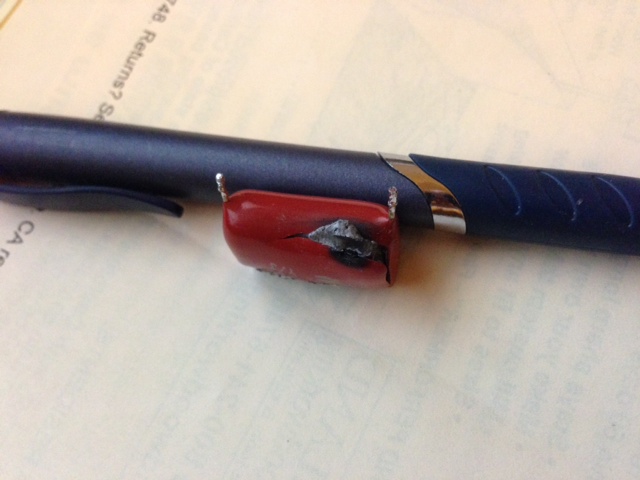

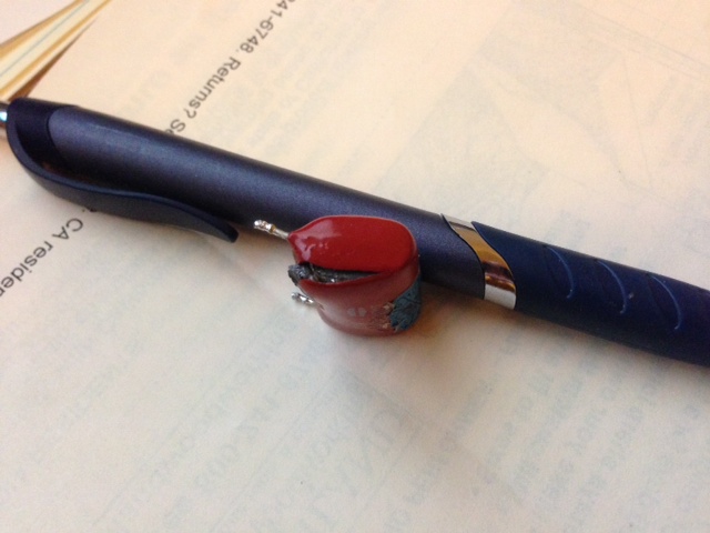

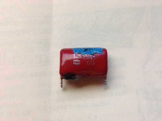

    What type of capacitor is this?
    Hello all,
    I know this is 1uF, 250VAC cap but not sure what type it is. All I can find to replace it are film type. I have attached some pictures. Thanks.

    Re: What type of capacitor is this?
    Polyester or polypropylene , you'll find them in the Film Capacitors on Digikey:
    http://www.digikey.com/product-searc...acitors/131088
    I'm not sure it's a 0.1uF though.
      I would have thought 1.0k was 1000pf = 1nf
        "K" may mean 10% tolerance. Or perhaps "Y/J" means it's a Y cap, 5% tolerance (and 1000pF). Does the other side of the cap have a bunch of safety agency approval marks? 1uF is a reasonably common X cap value, but would be pretty large, physically. 1000pF is a reasonable and common Y cap value, (2200pF, 3300pF, and 4700pF might be slightly more common). Was one of the leads connected to chassis (through a trace to a mounting hole)? If so, that would be a Y cap; the highest value Y cap I've ever seen was .047uF, so if it's a Y cap, the value probably was 1000pF.
          It sure looks like Y cap with 250VAC rating, 1000pF (.001uf) is about right, 0.1uf will be way too much current in the safety ground.
            Adnan didn't say where the part came from, though the lead length and residual solder pattern on the leads tells me it was on a PCB. So probably from something electronic (as opposed to home appliances, HVAC, or industrial machinery). In electronics, a 250V AC voltage rating usually means a line-line or line-ground capacitor, which very commonly have lots of safety agency approval markings. On another tack, a 1uF X cap is going to be much larger than a 1000pf (.001uF) Y cap. I'd love to see a pic of the cap next to a ruler, showing the other side of the part.
            I think safety regs' leakage current limits relegate usage of Y caps larger than 4700pF to special applications (hard-wired power, possibly?). 4700pF is probably the limit for cumulative Y capacitance: e.g., if you have three Y caps on Line (and/or Neutral), two 2200pF and one 1000pF, the leakage current will probably be too high. The power line filters in which I used .022uF Y caps (Rifa PME271 series) were used in hard-wire installed computer equipment.
