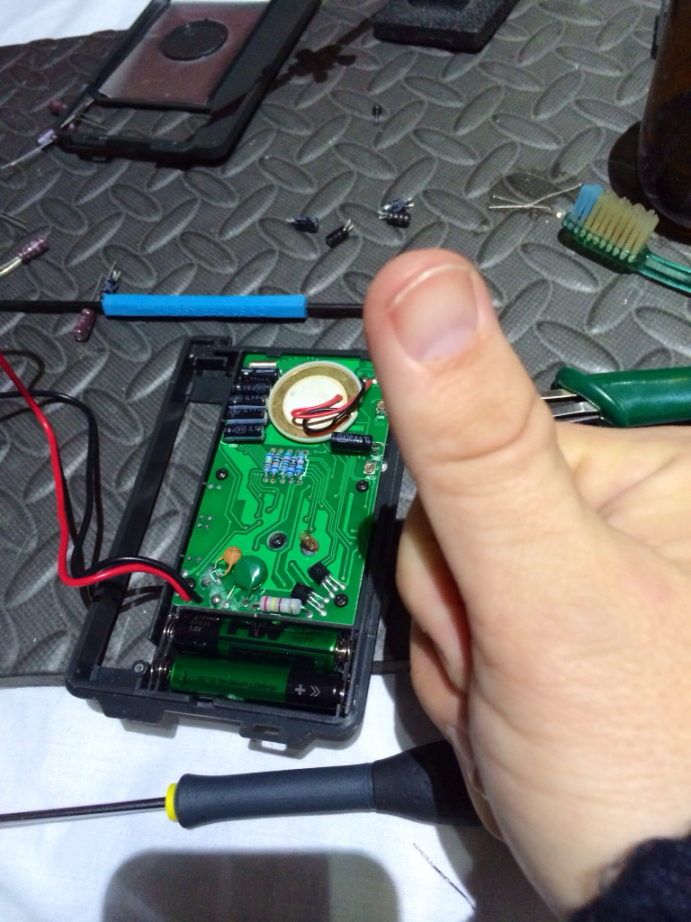

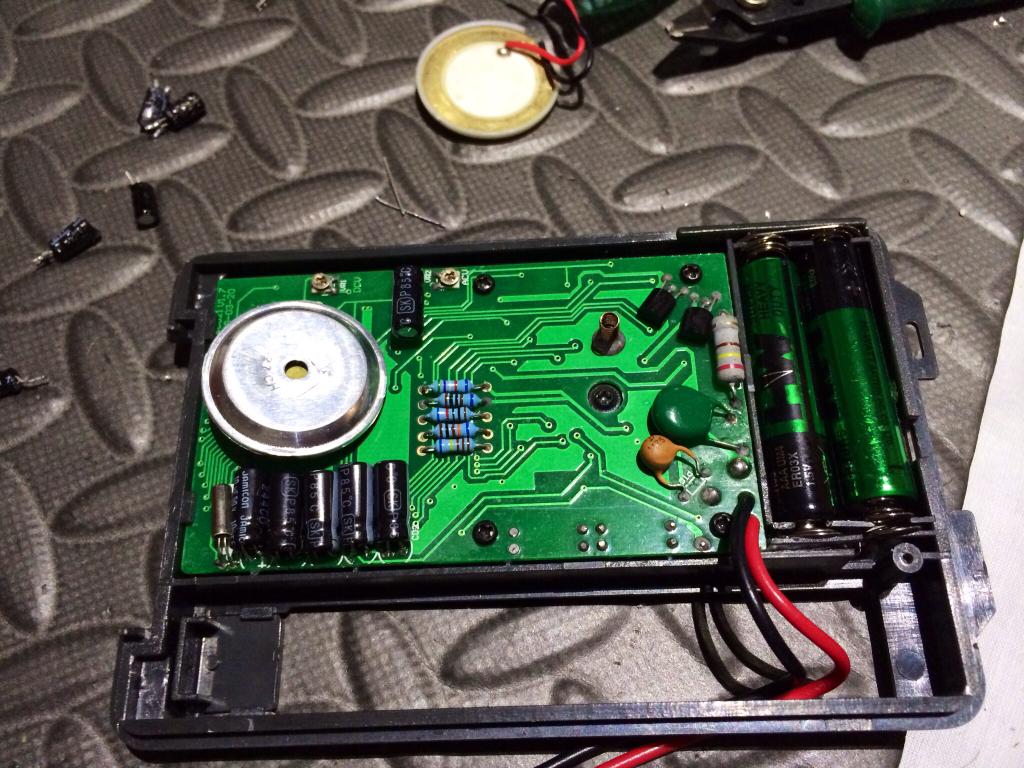

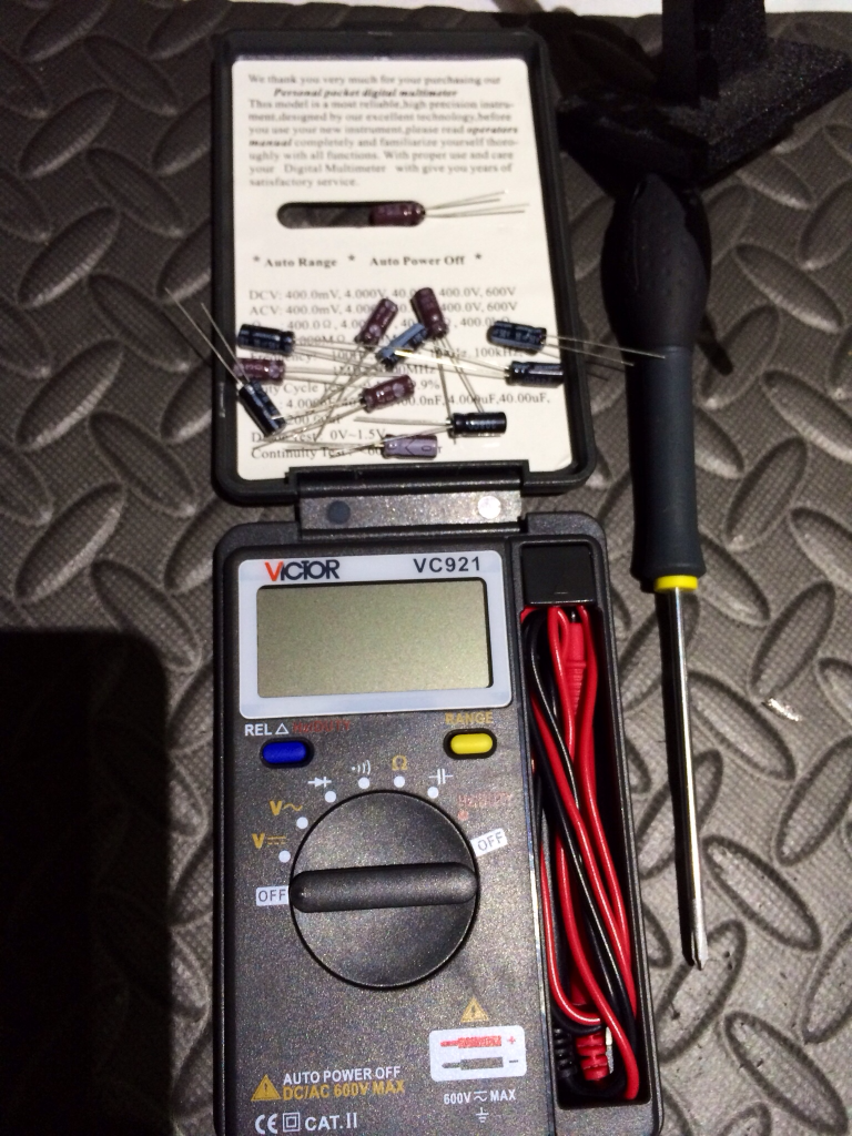

    Re: Recaping Victor VC921...
    It was very interesting, good capacitors put this victor low cost, giving it a little more stability. You like? regards
      Good job with the soldering! Sheeeeeeesh, those original solder joints were nasty looking! (Dull, brittle lead-free solder that cracks easily and grows "tin whiskers" AKA tin crystals)
      Only other thing I have to say is you used Jamicon capacitors which are of average quality. But they are NOT in a very stressing environment here, so they should be good!

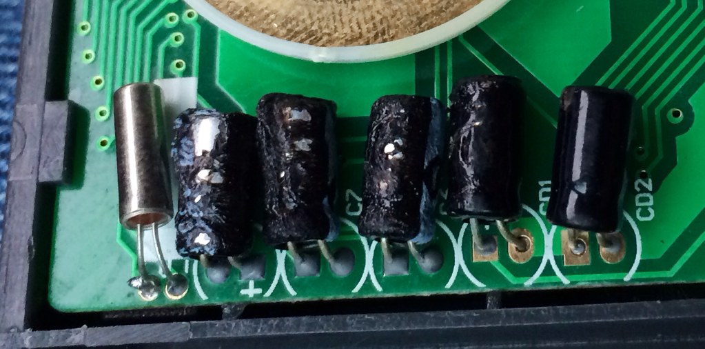

        It kind of looks like the original caps were leaking.
        I wonder what they did at the factory to melt the labels on the caps like that.
          Truly, it is a shame, but to protest over what is complicated, because no open devices, I just did it for leisure and took the surprise. It cost less than 1 euro change all caps. regards

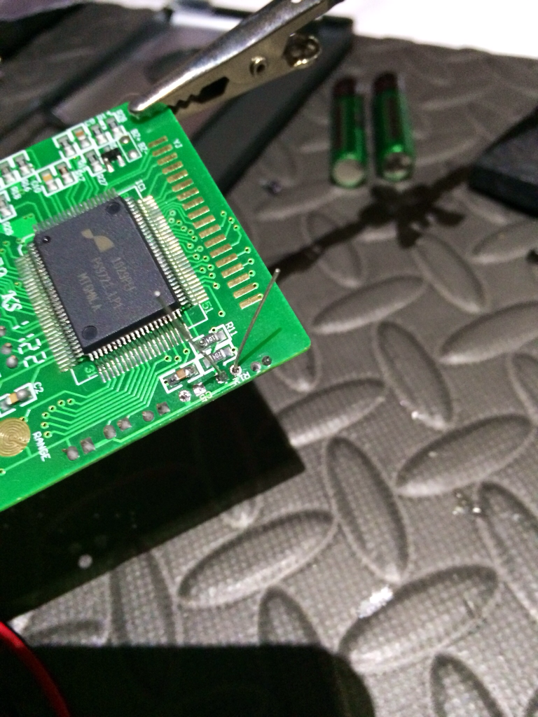

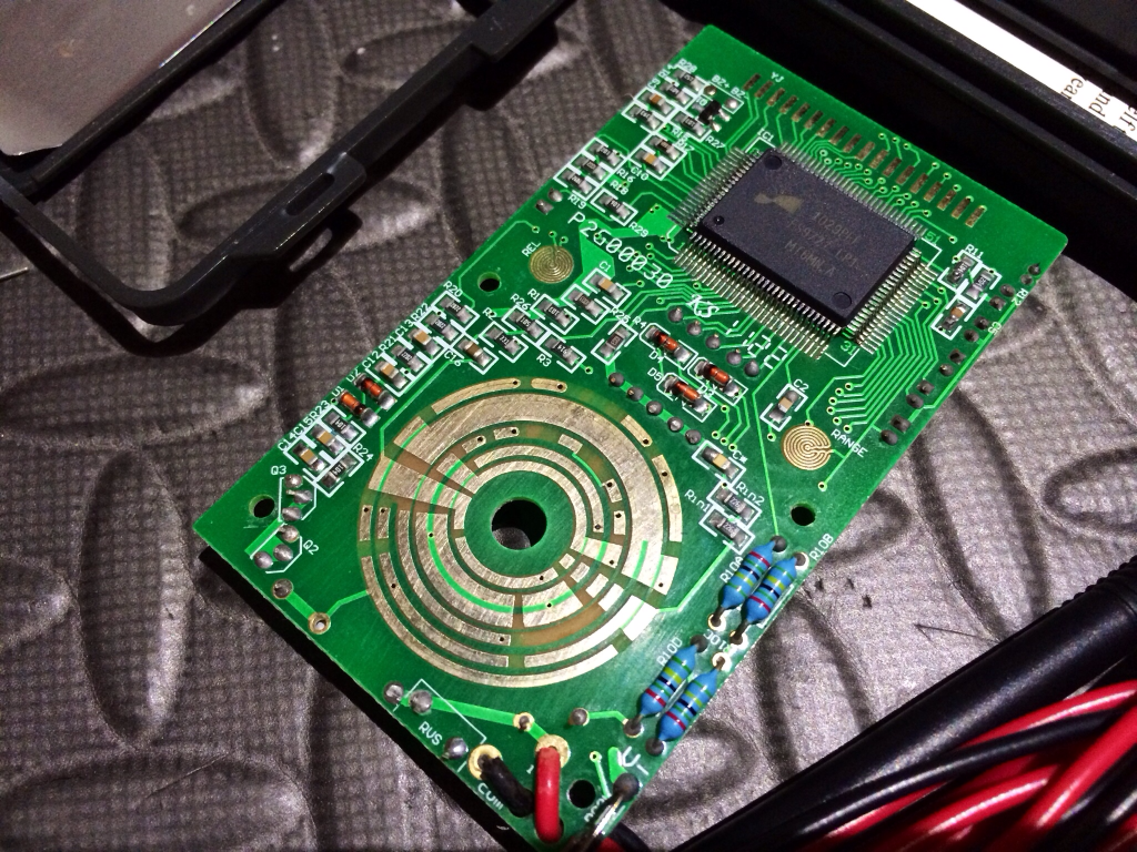

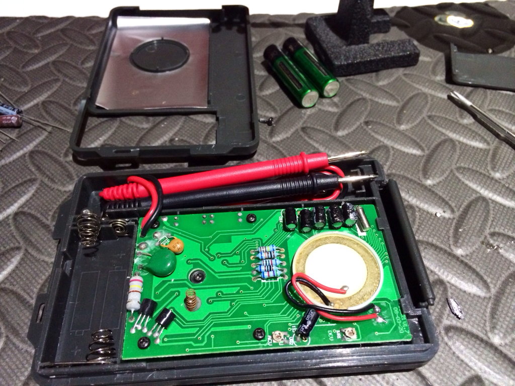

            Sorry to wake up a long dead thread, but I thought it worth pointing out that the design of this multimeter has changed.
            The new design uses a chip on board (aka little black blob), and more surface mount components. It appears to be based on a variant of the Fortune Semiconductor Corporation FS9XXX series multimeter chips, but exactly which one is difficult to tell as not all pins are broken out. There is a high probability that it is one of these guys... http://www.ic-fortune.com/eng/new_product3_3.asp ... exactly which one.. well your guess is as good as mine.
            A full set of teardown pictures here... https://goo.gl/photos/aR3xKELrAAmGa16o7
            The interesting thing is that it has a 24c02 i2c EEROM, presumably for settings and calibration. I'll need to try and find the time to read it and see if it reveals anything useful.
              The Victor VC921 "True RMS" is not a bold unsubstantiated claim.
              This variant is based on the HY12P65/HY12P66 the pinout of the little black blob matches this chip *exactly*. (The meter is not as I previously though, based on a Fortune Semiconductor FS9XXX)
              This probably makes the "VC921 True RMS" the cheapest true RMS meter on the market (and also probably the lowest build quality )
              The HY12P65/66 is in fact a True RMS DMM chip. The board layout out is a similar arrangement to the Victor VC890-X series. It *may* even be capable of RS232 output, time to solder on some very small wires and find out.
              Data Sheets, programming info and all things HY12P6X related >> http://www.hycontek.com/e-page2-HY12P.html
              The older versions however are *not* based on this chip, and are not true RMS.
